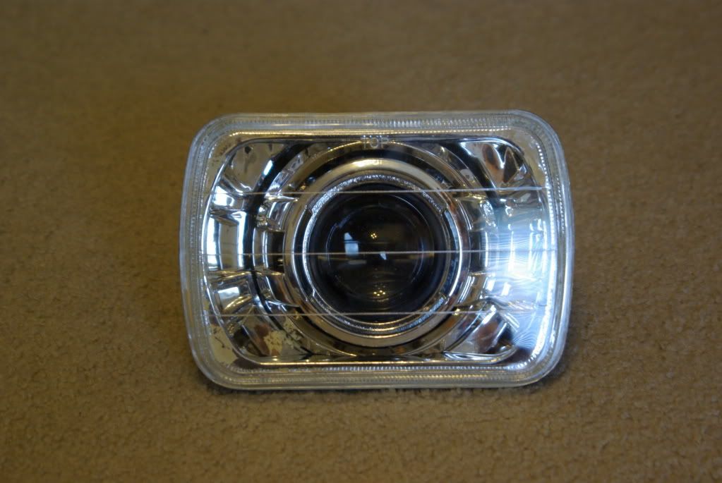

Still waiting on parts (figures some stuff was on backorder). Anyone have a preferance for plastic or glass fronts? Glass distorts the beam a bit making the cutoff fuzzy, but they're cheaper and more durable. Plastic doesn't distort the beam as much but they age (might not be a big issue as we have popups).
Looking for feedback :D

917mgte;1679525 said:
I was actually looking for housing and projectors and i just so happen to stumble across some 7x6 projectors. Saved me some time and they have a good cut off line... http://norcalmr2.com/pegasus/
Low beam only, they're halogen projectors so they lack width, and they use a rebased bulb instead of a true D2S bulb. Their output looks crappy as hell too, reminds me of the super cheap chinese projectors... Plus they have no shrouds.
Only thing I like is the rear housing looks molded with standoffs to bolt the projector in.
5

UPDATE: Coming along nicely. Will more than likely have to pain the reflector on the housing on this one since the chrome is so cheap that some of it came off when I peeled the low tack blue painter's tape off. I even stuck it to my shirt first! This one is about halfwa done, most of the cutting is done, it's just sort of mocked up at this point. Comments are welcome.
