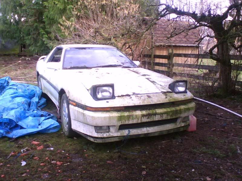

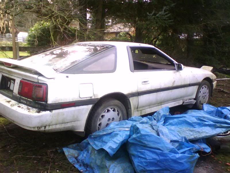

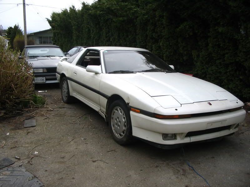

so ya, my name is Rich and I just picked up a 88 supra, pearl white Targa, 5spd. the car is rough but I am looking forward to the work, Ive liked this body style for as long as I can remember

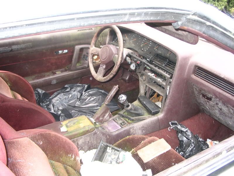

and thanks for stopping by on sunday Justin it was nice to meet you and get to see your car:love:

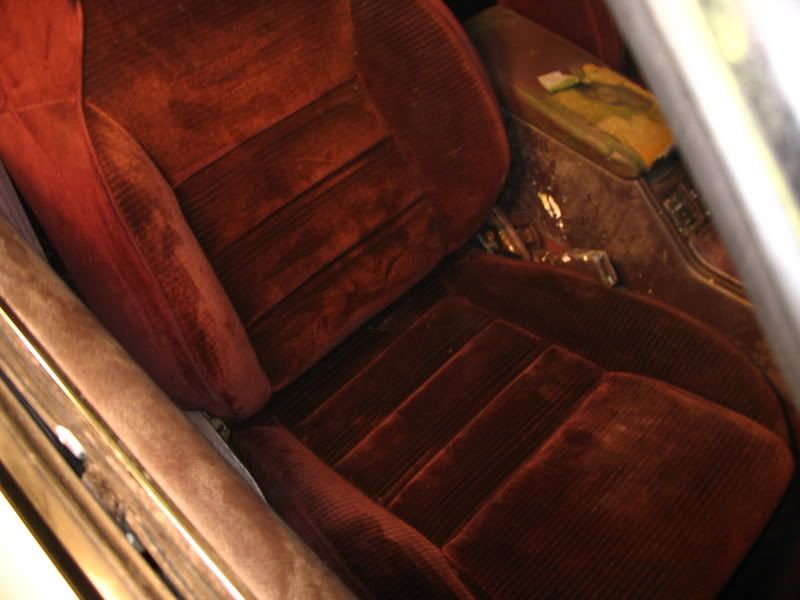

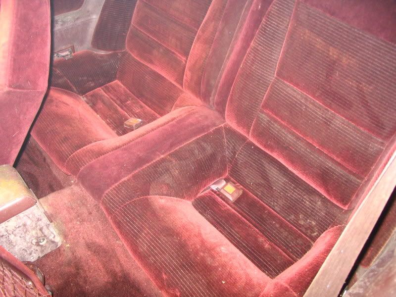

I got abit of cleaning up done to the interior after you left

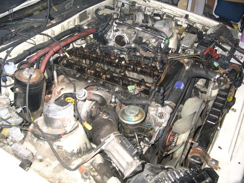

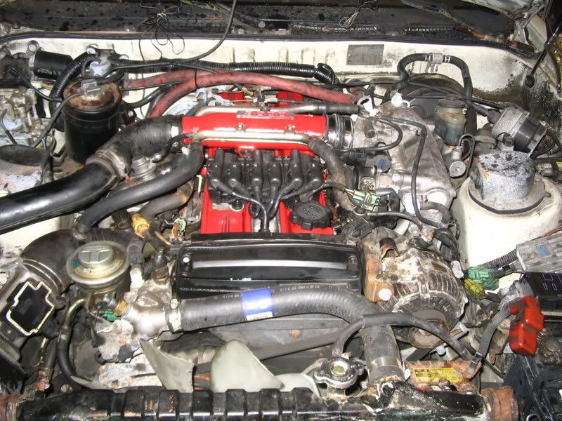

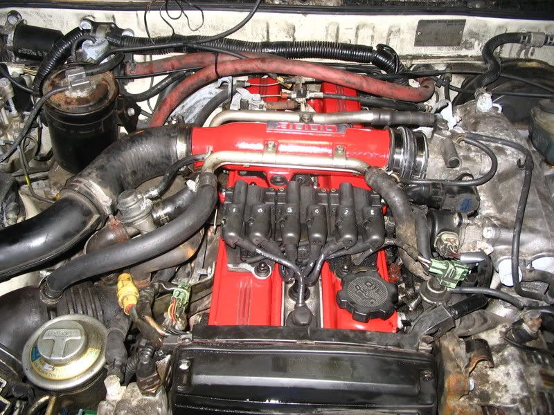

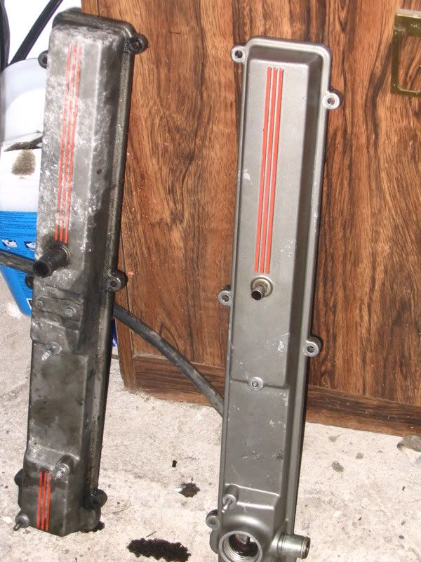

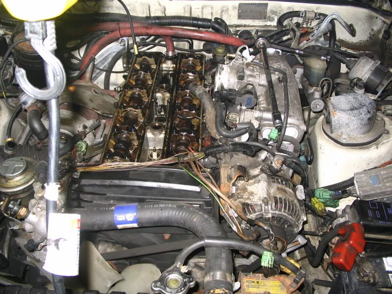

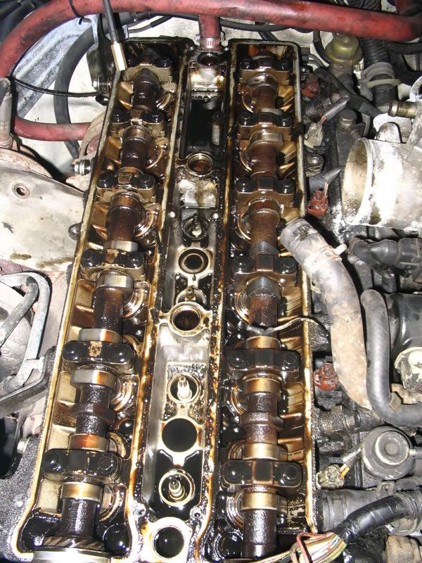

supraman7mgte, I forgot to take engine bay pics till after I had already torn into it abit, but you can get the idea from these I guess, I have oil in the spark plug area under the center cover so I tore into it tonight (started at 2am, my neibors must love me), gonna have to get some valve cover gaskets and one little piece of hose so far (it looks like it is part of the pcv system and it is split)
as always I got side tracked and spent more time cleaning things up then anything else, but I cant do much untill I get a 14MM torx socket to pull those plugs in between the sparkplugs
I was able to pull the ones that hold the cover on by welding together a bolt and washer and using that, but it wasnt strong enough to pull the ones in the head
well anyhow I am very tired (it is 5:20am now) and I should probly sleep before work, so I will leave you guys with the pics and check back in later

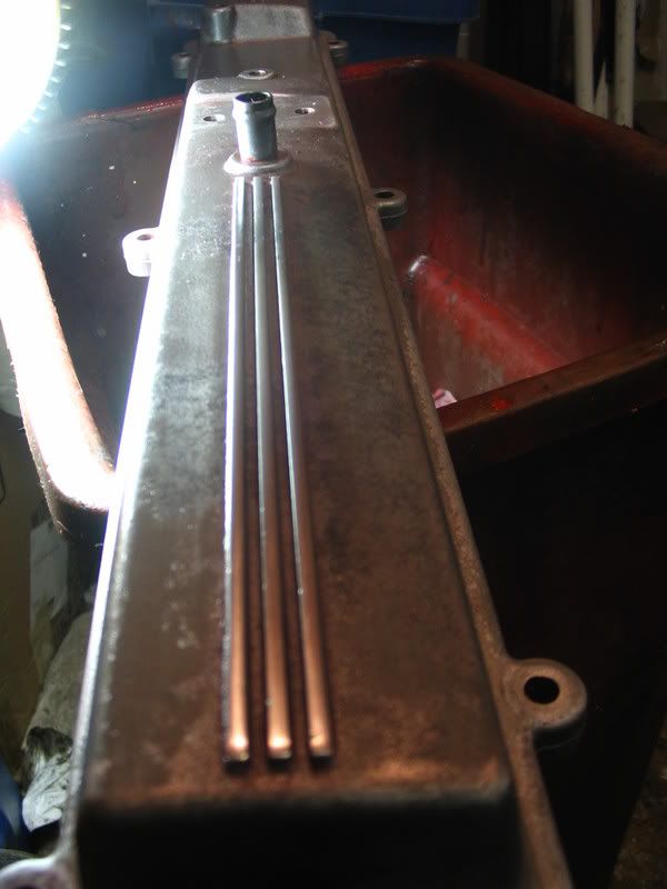

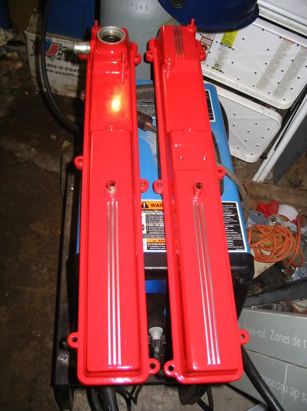

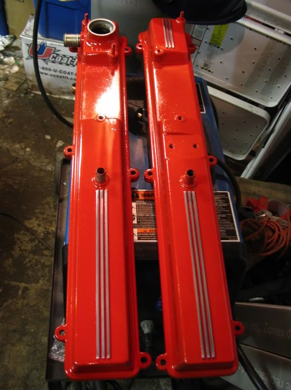

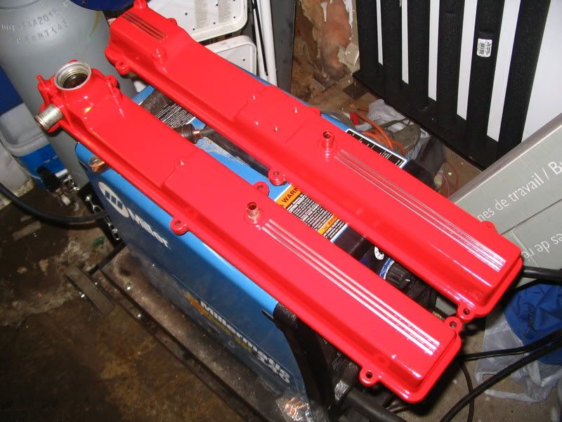

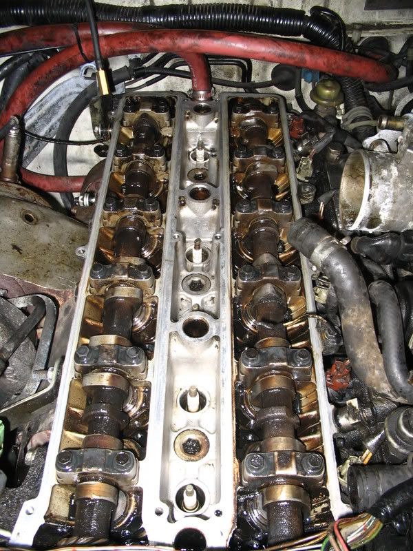

not much to see tonight, just alittle paint ( I swear it looks better in person)
is this to many pics for everyone??
I like to take to many pics I think

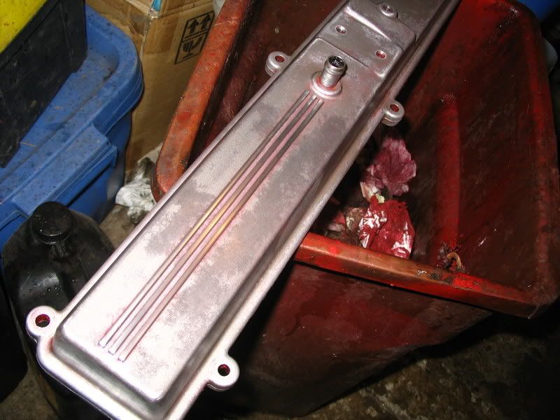

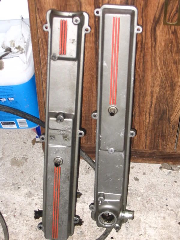

I had read that they are prone to leaking and I had planned to seal them and re torque them while I was there... but I took abetter look at my plan and I will be able to get to them pretty easy in the future if they start to weep

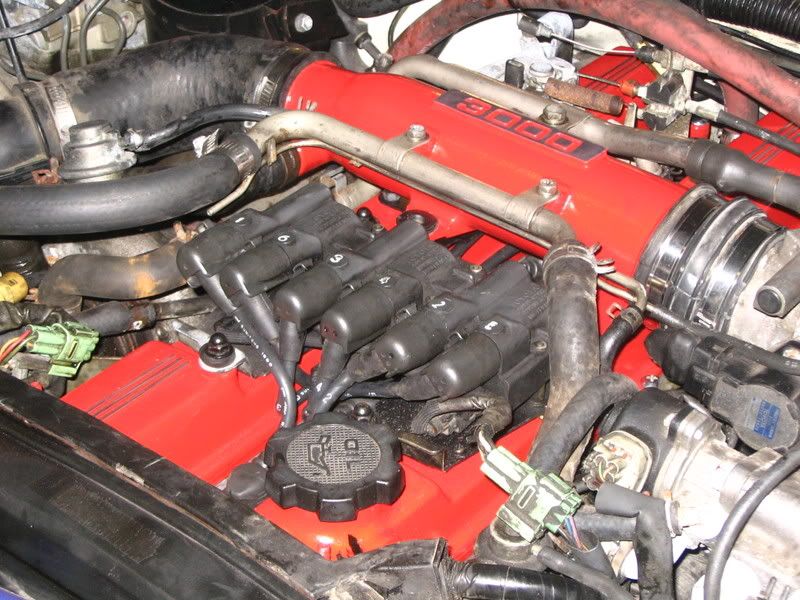

so I got it back together, I was hoping the missfire was due to the oild bath the plugs and wires were taking, but it is still missing on 3 cylinders (2,3, and 5)
swapped plugs and wires around to different holes and it still misses on 2,3 and 5???
could the coil pack cause this?
should I borrow a compression tester and see if thats the problem??

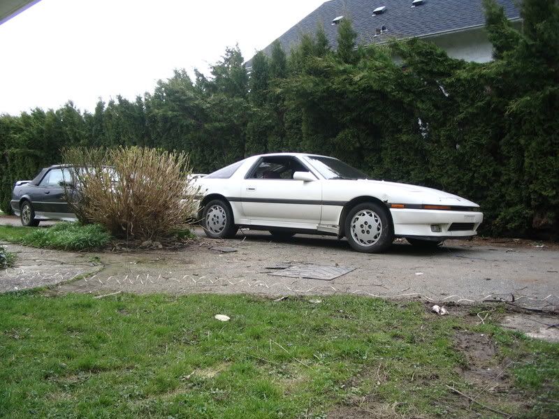

well anyhow, here is it back together, not really cleaned up by any means, but I have to get it running right first

Try wiggling the CPS connector while the engine is running...If it stumbles or stalls, then that's the problem...could also be your plug wires, coil packs, or even the wiring to the coils (green connector on the right)...also check all of the motor's ground points, especially the cluster of grounds under the intake manifold towards the firewall. Have you checked for engine error codes?
Nice job on making some progress. ;)
mutt
Mar 7, 2008
27
chilliwack BC
Supra 86.5: thanks for the kind words, I would like to see these pics!
Johnathan1: I will have to find out where to find the cps connector, and the grounds will have to be checked, I have swapped plug wires around and the problem stays with the cylinder not the plug wire, and I have no check engine light illuminated on the dash, can it have codes stored without the check engine light on??
I am hoping when I pick up my spare engine that there is another coil pack included and then I will no if that is the culprit or not
I have had the coil packs unplugged afew times now ind havn't noticed any damage in the wires or a difference in how it runs before and after, so I think that connector is ok
