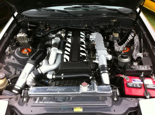

Interesting... Had these done in my supra over a year ago... but were you going for a camo or zebra thing?

some fabric from a textile shop.
