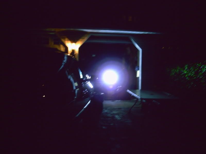

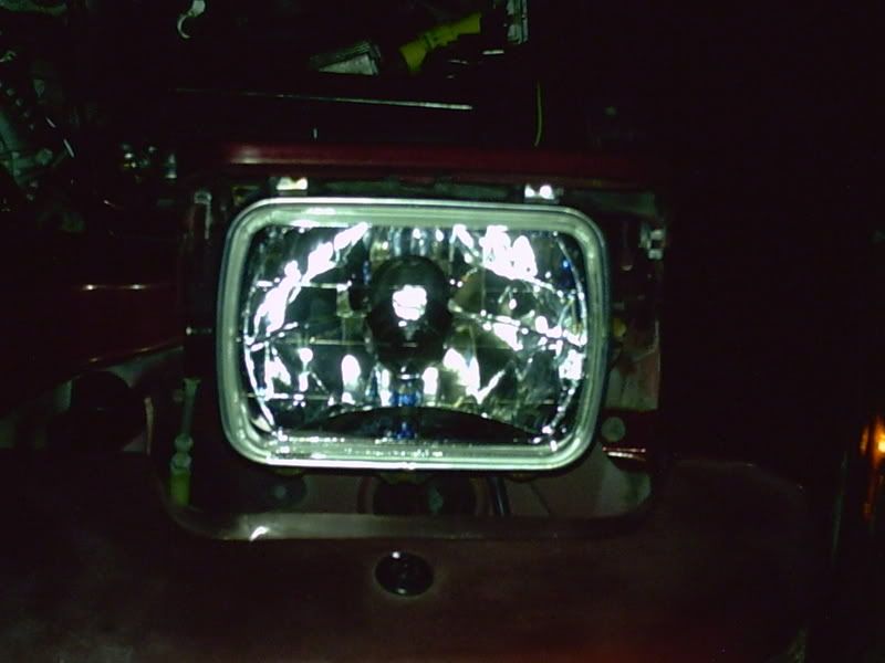

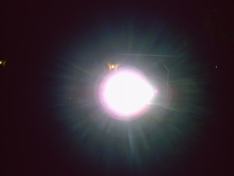

Here are the ones I have but these are also with the ebay h4 housing. The picture is not the best but it lights up the whole street very nice and I just got my 10k h3 bulbs as well for the fog lights so when I get a relay and hook everything up good I will post some more pics

playa, thats exactly what other cars will see coming your way, not good. gotta get the hella ECEs so you can actually have a cutoff.
