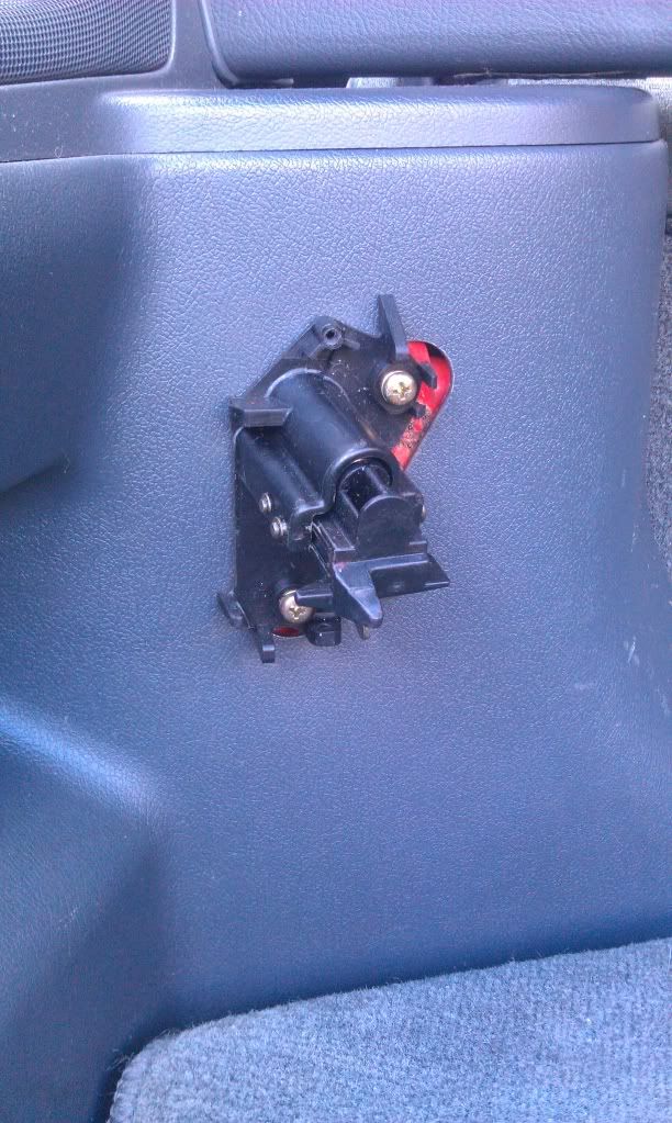

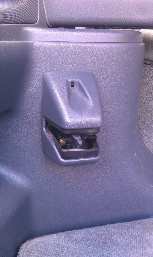

Well I did try to slide it above them too but it doesn't fit. I feel like I am loosing my mind over this. I never had a problem with the ones in my 88. Here is what it looks like, maybe something is out of place... with cover
without

ha well glad I posted those pics. I know the previous owner said he had swapped the interior. I knew it looked off to me and that I wasn't crazy. thanks guys
