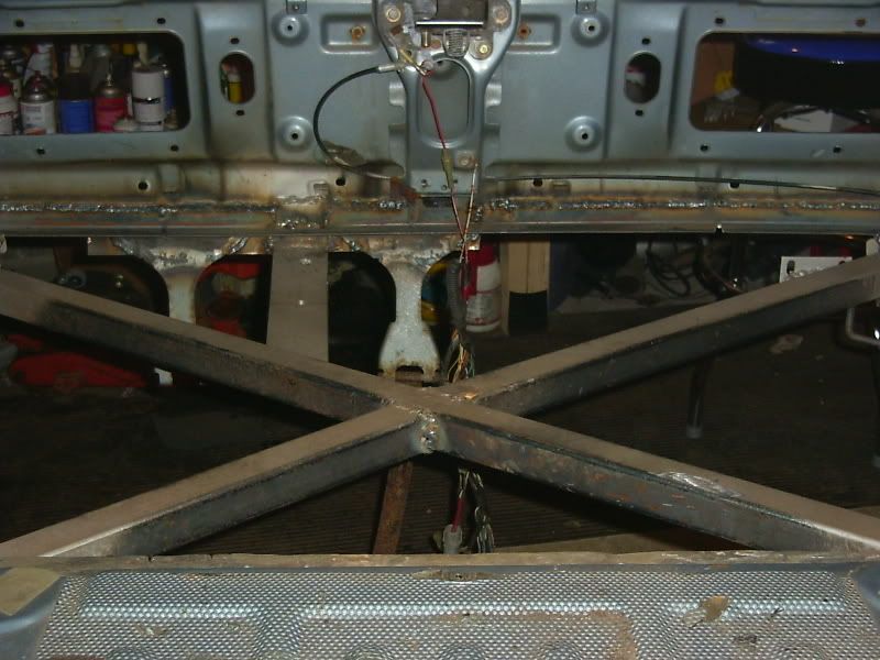

This is an interesting thread , I found myself asking the same thing about the MKII . Same result some said, maybe , yes, nope , don't , how , would be nice , what if .. so basically I cut out the spare tire area , cleaned up the frame rails , X braced it and toped it off with a sheet of 18Guage sheetmetal . I more than doubled the HP output of my car so I decided I should try to make it as solid as possible . Mine is a little older but the outcome is the same . Less flex = less body roll = less stress on an old chassis. I'm not an engineer so forgive my crude work but the end result is a much more stable car at high speeds and a more controlable weight transfer in the twisties. I've had 4 so I can say it is an improvement .. Just my .02c :icon_bigg

LOL !! I only see 2 in that pic the rest is slick 50 , rust converter , white lithium etc but I do have plenty more spray cans :naughty: buy low .. ( fix Up /touch up ) sell high !! I've been doing it for years so that shit piles up .. Gotta pay for my Supra addiction somehow .....:nono:
ms07 ... thanks, it isn't for everyone and some will argue it's design but it works and thats enough for me !!
