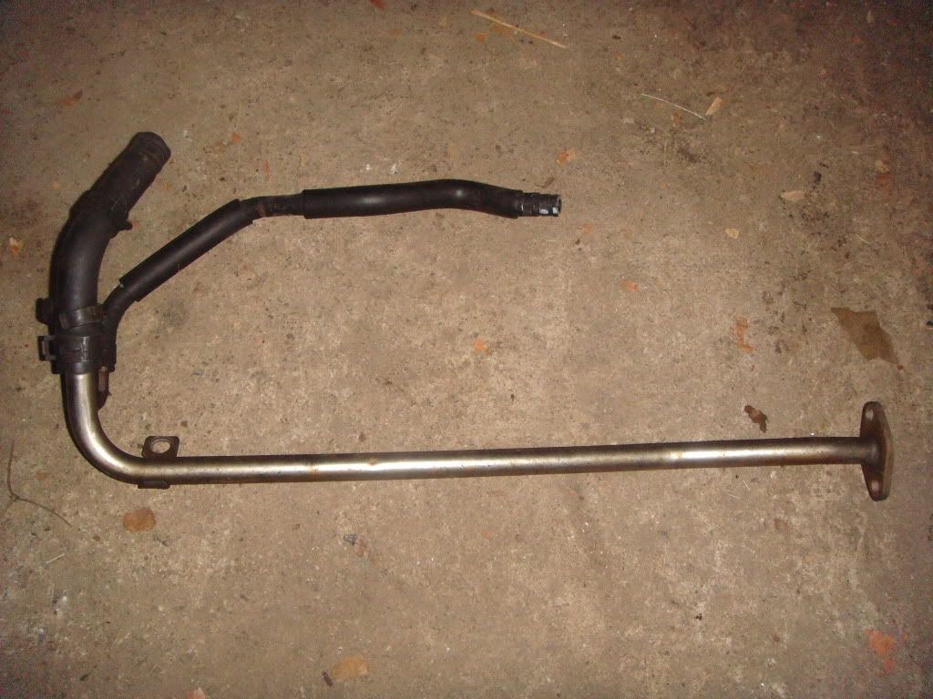

Then:
and of course this would (behind the head) have a 90 that connects to the top of the tee shown in the above pics.

see I'd just weld the fitting on a NA pipe and use a 90* to go strait up to the core then a AN to tube fitting with a aluminum sleeve on the inside to not crush it.
His down pipe is Way closer to the block then mine.
Edit* the heater core inlet and outlet are what 5/8ths?
Well like I had said, I didn't want to use the GE pipe for the sake of getting water to the components on the intake side. Also, the reason I wouldn't want to just weld an AN fitting straight to the GTE pipe is- the GTE pipe actually protrudes away from the block. With my proposed setup above, you'd be able to run it closer to the block (like the GE pipe)

To me it seems like alot of work for a heater system...heat is not a big priority to me being in az where I only use it 4 months of the year. If it was me I would weld a bung at the 90 by the downpipe and have it point up.

Interesting! Also whats the GE pipe look like does it not wrap around to the intake side but the ports look the same?
