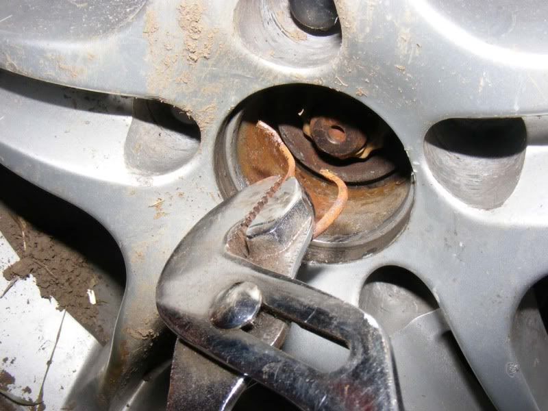

Step 4 - Use some mole grips to finish the job once you've got enough of the split pin through to get some purchase on it. Note they can sometimes be awkward and come out in pieces as shown in pic #2
