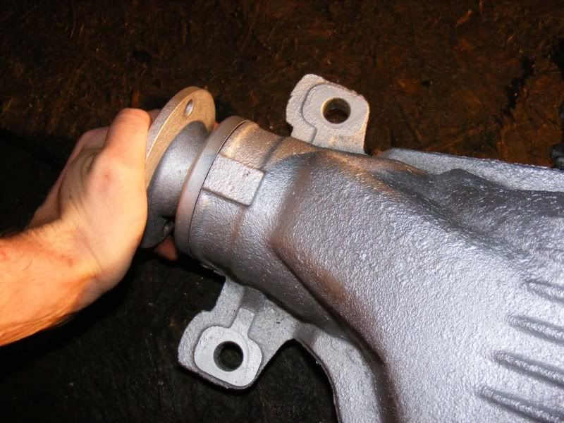

This can be done on the car although it is easier off the car as you have good access. You need to make sure you can fill the oil again before you drain it so make sure you crack off the drain and fill plugs before you commit to anything!

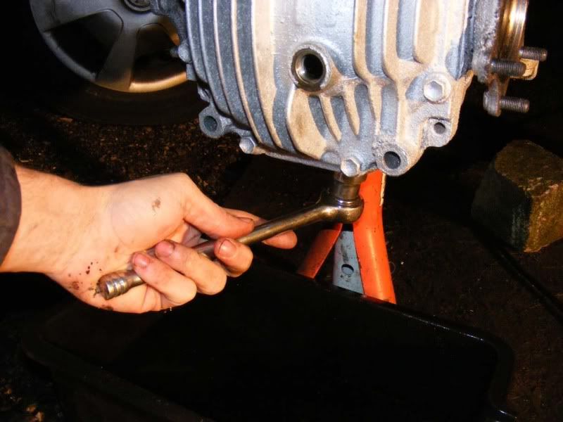

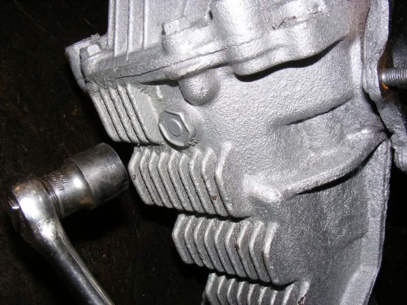

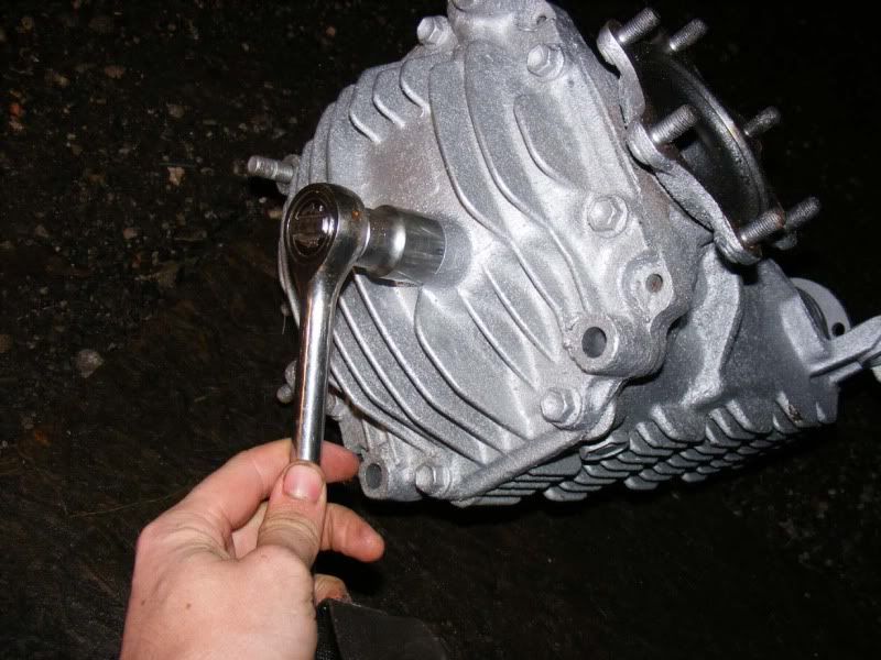

Step 1 - Slacken the 24mm fill plug, if you can't do this then you are going to have to find someone who can! I recommend you get a good 24mm socket and a breaker bar for the best chance of an easy removal
Step 2 - Now crack the drain plug off too, it's another 24mm

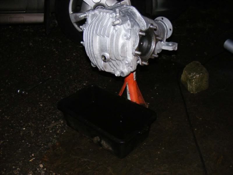

Step 3 - Position the diff over an oil drain pan of some kind. Transmission fluid is revolting, diff oil is even worse - it stinks. Try not to get covered!

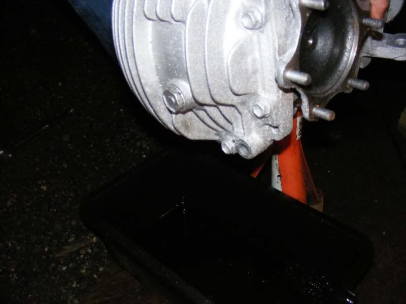

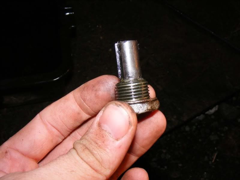

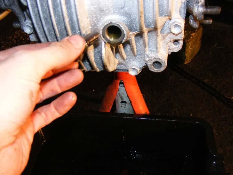

Step 4 - Remove the drain plug and the fluid will start to escape. Remove the fill plug and you let the fluid pour out even quicker. Note the filler plug is different when removed, see picture 2

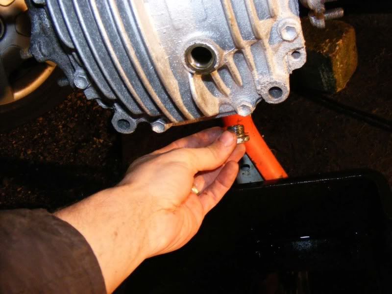

Step 5 - Wait for it to drain then refit the drain plug

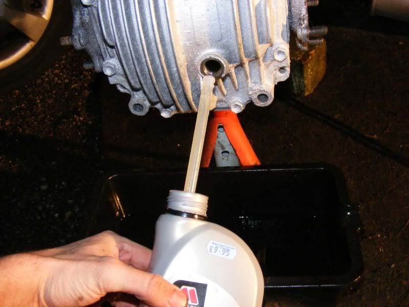

Step 7 - The bottle should have a nozzle to ease filling, otherwise you need funnels or a lubricant gun to help you, pour in the first bottle completely then start on the second (you won't need it all)
Step 8 - When fluid starts to run out you know the fluid has reached the level off the filler plug which is how full it needs to be (about 1.2 litres for me)

The problem I ran into was the socket I was using, and I tried two different ones, is that they would start to round off the edges of the plugs due to the low height of plug bolt head.
To deal with it, I took one of the sockets and ground down the end of the socket past the inside chamfer so that the socket would completely contact as much of the plug head as posible. Once I did that, they came off and back on very confidently.:naughty:
