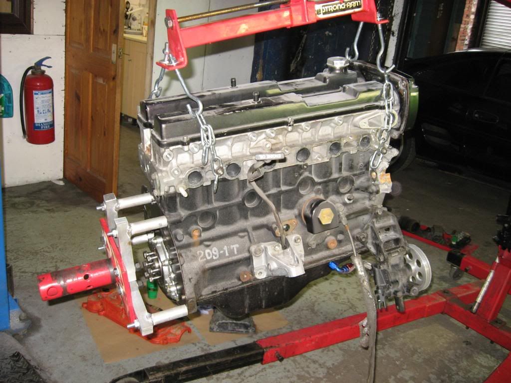

Well yesterday just to prove ian wrong i started on my group a car and pulled the engine an tranny ready for the freshen up internaly :)
so ian here ya go ;)

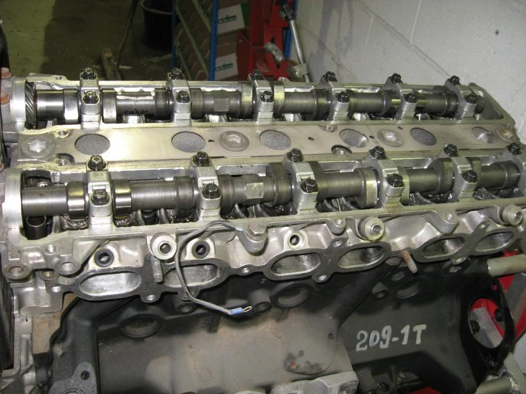

cylinder head date stamp
shes a bit dusty lol

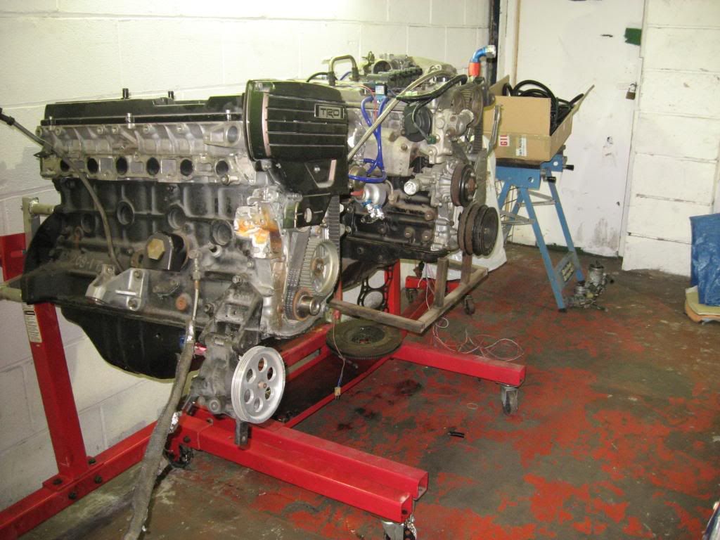

my 2 group a eengines together :) lucky me

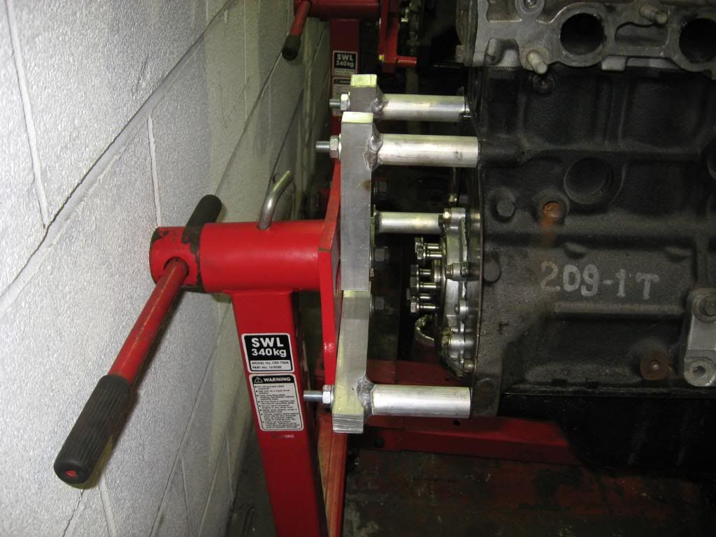

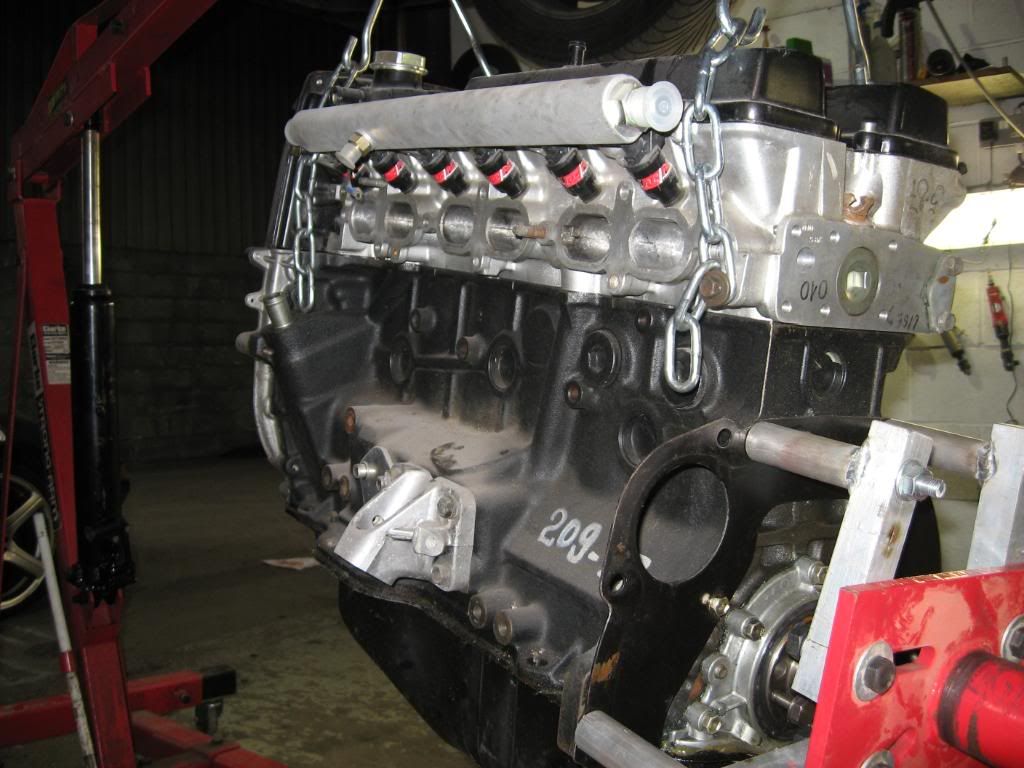

my special 7m engine stand mounts enable the back plate and sump to come on and of with out lots of hardwork :)

ok started to dismantle the engine as i couldnt remember what was in there lol

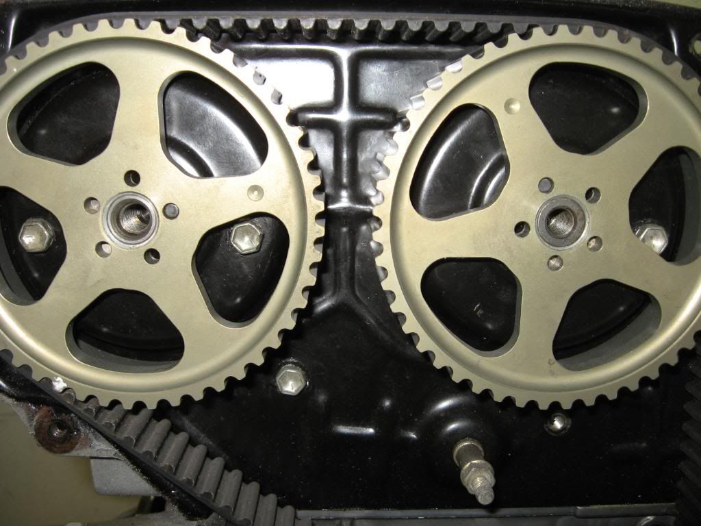

Cam are of a significantly better quality than stock not going into the obvious size difference of being a 284 degree cam
cam pulleys are magnesium for sure
stock weigh 475 g each my magnesium ones are 255 g each
oil pump pulley stock 465 g my magnesium one 240 g

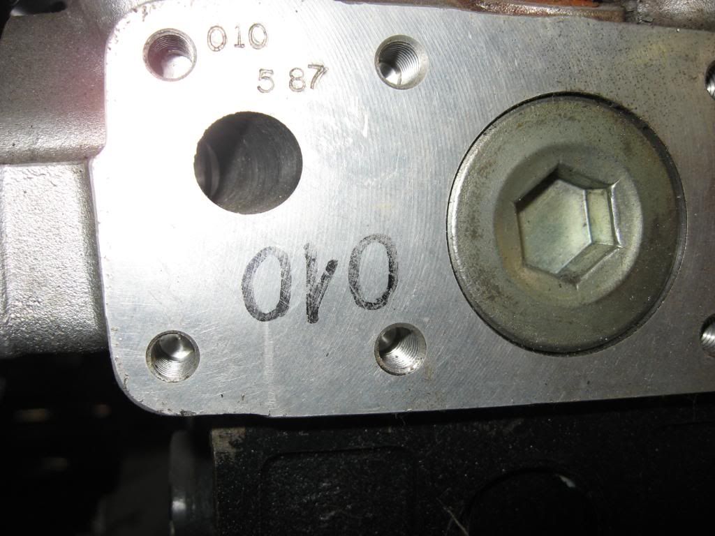

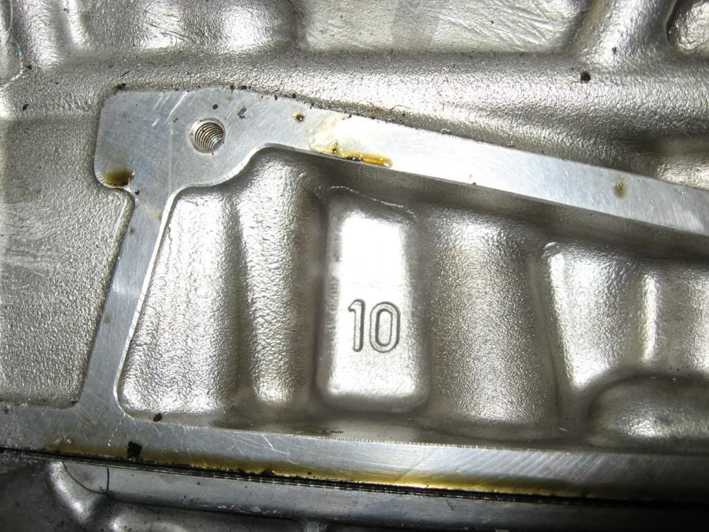

ian you once asked me for the number of the front of the head well here it is brother ;)
63
Well they range from #2 to #16, GroupA engines were all late 87's from memory so I didn't think they'd have a #10 on them but that was just a guess on my part as #16's may have been done much earlier than 92.
