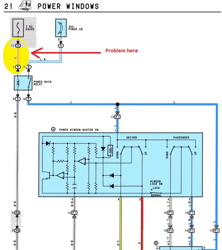

I think this should be added here so people can see the troubleshooting that went on. Having this information available will help improve the forums for anyone who may come along with a similar problem.
BryanDyer said:
I checked the really like you said with a multimeter and all of the readings were right except pin one read 0 volts so what does that mean?
Pin 1 goes over to the 7.5 amp GAUGE fuse, through pin 11 on connector '1I' . Pull the fuse out and check for 12V on either of the fuse pins. This will help us narrow the fault down to before or after the fuse.

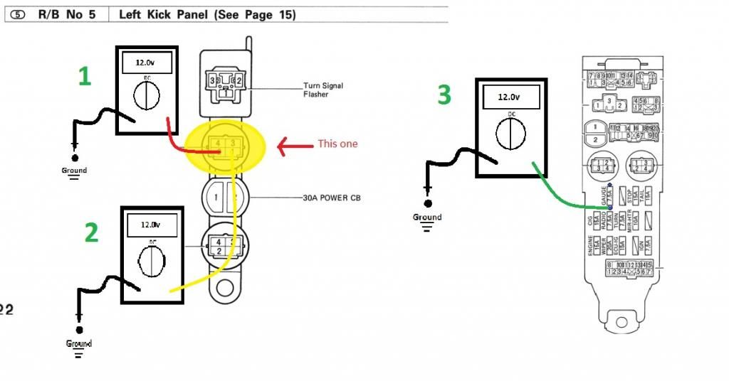

BryanDyer said:
I only had 12v between pin 1(on the relay it's pin 4) but I had 12v between the pin and only one of the slots for the fuse what does that mean?
Not sure if I fuflly understand that sentence so to avoid confusion use the Image below. I have three tests with the multi-meter shown, and how they are hooked up. Tell me if any of the tests do not show 12v, using the green number next to it(1,2, or 3).
BryanDyer said:
test number 2 did not have volts

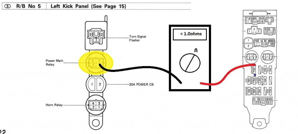

OK that pin goes through one connector and to the top pin in 7.5amp GAUGE fuse. Next we need to test that connection. Preform a continuity test as shown. You should get good continuity.
BryanDyer said:
there was not continuity between them
Ok we have narrowed the problem down to somewhere along a one wire segment.
