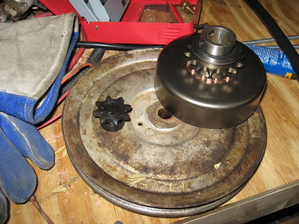

finally got back on track and purchased a clutch today at northern. im going from an 8" pulley to a 10 tooth sprocket, about an inch and a half in diameter.

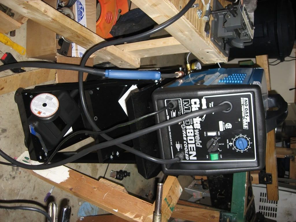

also got the mig welder up and running and its flat out amazing compared to the stick welder. no contest.
Oh course... which remind me that I need to pick myself up a miller tig welder.

I might...i dont have one in "stock" but i know a few people who have some maybe. Shipping might be high...we'll see though. UPDATE ON MY TOYS: my dad gave me an older wheel horse tractor that has a broke 3 spd(guy was pulling a stump out and wheel hopped it and snapped a spider gear) Pics will come tomorrow.....After so much thought and such...my version II might be history lol.
:EDIT: BTW clip that setup with sprockets might now work well. The rear being so small might bind and cause failure....or just no tq and all speed. Also, with a centrifugal clutch....dont expect wheelies unless you transfer a lot of weight quickly. My setup is a 3in or 4in(depends what motor i run) and a 2.5in rear. That is with a belt setup. If i were you, id run a lil bit bigger sprocket.

im awful scared that the 5speed will go down in a blaze of glory since i switched to such a small sprocket. it was either that sprocket or a 54 tooth one bigger than the pulley
