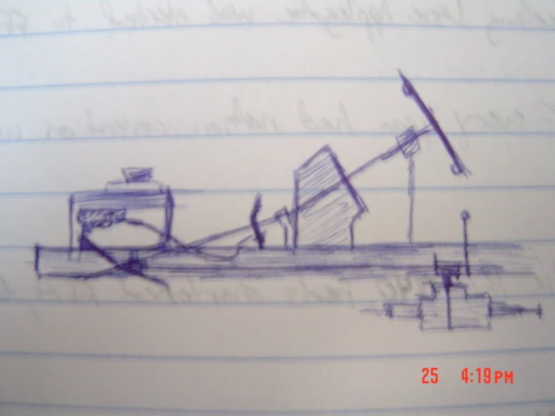

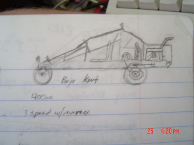

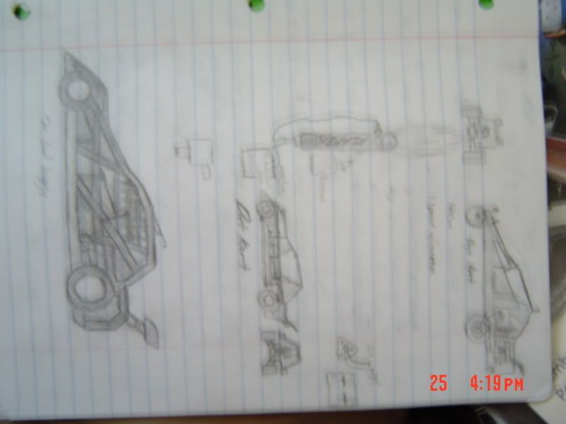

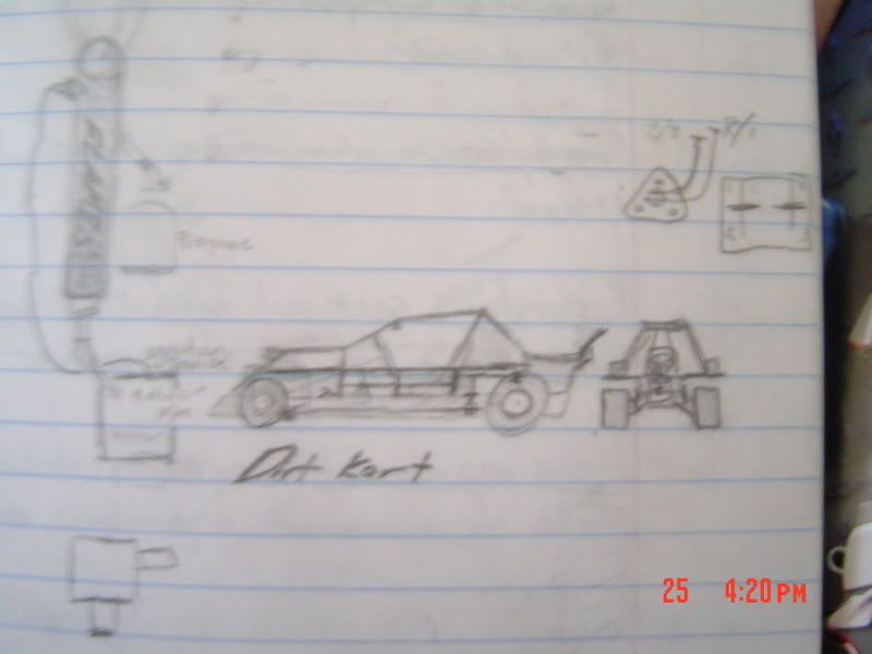

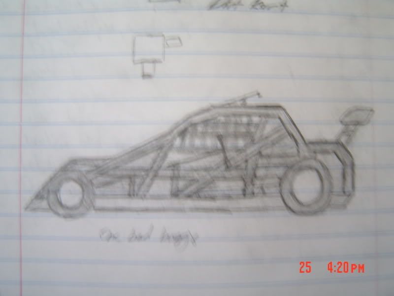

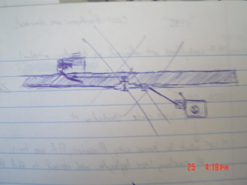

i'm thinking a normal width gokart...just homemade and not bought.  i cannot nor will i pay hundreds of dollars for something like this.  i figure 50 bux into rebuilding the motor/adding a nicer muffler, and then supplies for the frame, which i'd fab myself.  (thats going to be very hard...but its a great way to learn!)
