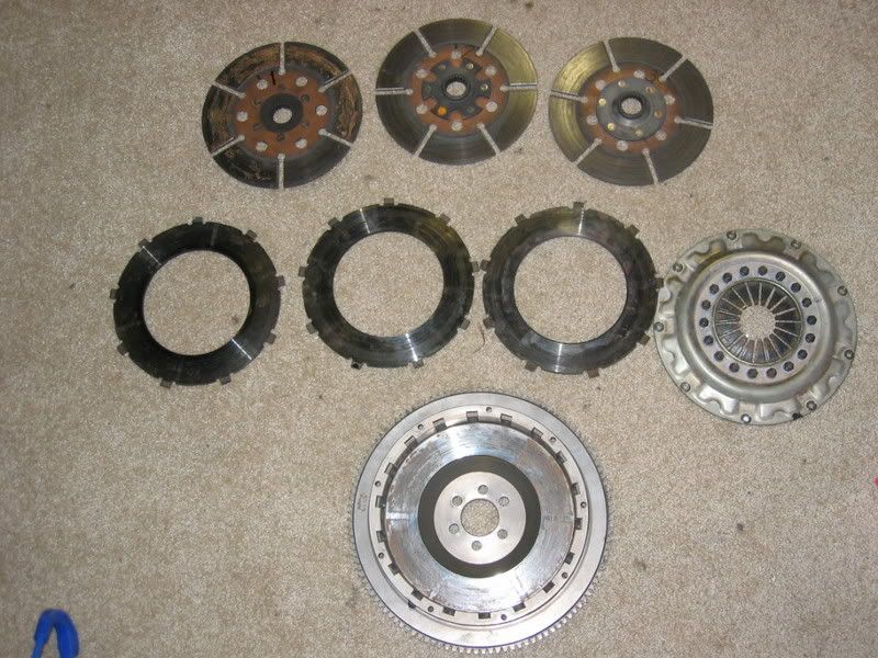

A little item I pick up reciently, not sure if I'm going to use it though:

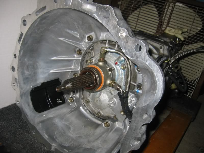

OS Giken triple plate for the 7m, still need to figure out the conversion to push from pull. Possibly going with a hydraulic throwout set-up like Ron R's, but not for a while.
Something like this:

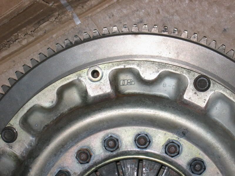

Oliver,
I used that Dupli-Color blue anodized paint, it looks pretty good in the picture, but up close there are is a lot of orange peel, the oil pan turned out better.
I'm switching to N/A valve covers that I'm having polished. Since I went to a coil on plug set-up the indents (where the stock coils mounted) on the Turbo valve covers has been bothering me. I even have a set of 1jz valve covers that I may mod in the future to fit.

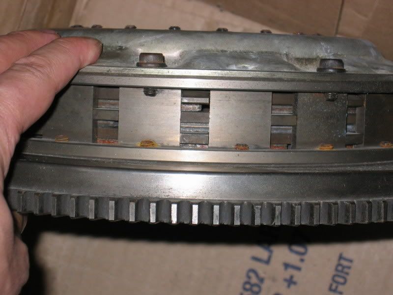

The flywheel is from RPS, it is their segmented aluminum cyner-g FW, in my humble opinion the best one on the market. It weighed in at just under 11lbs, and the segmented friction surface won't warp like some of the other lightweight flywheels out there.

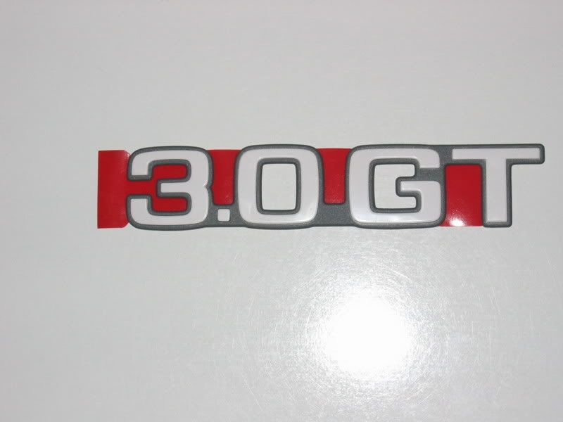

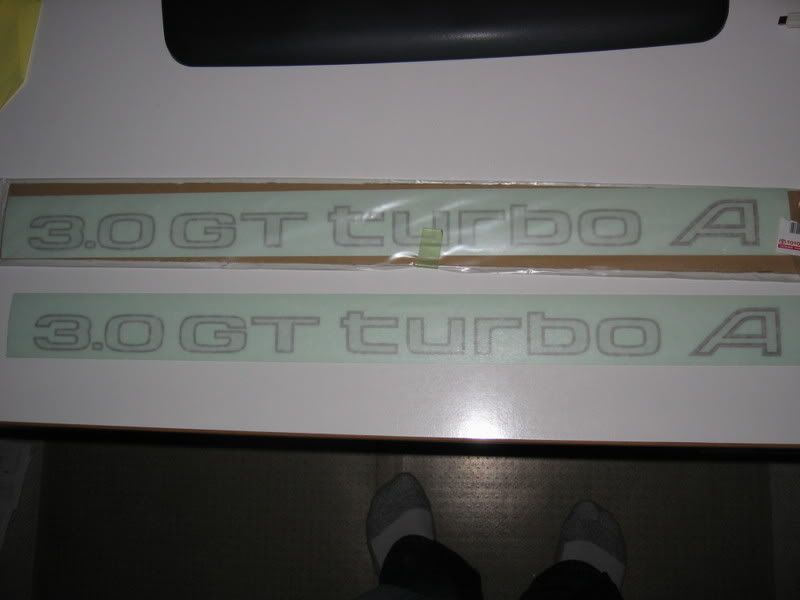

Couple more "Turbo-A" items I've collected, still deciding on whether or not I'm going to use them.
Door decals:
Rear emblem:

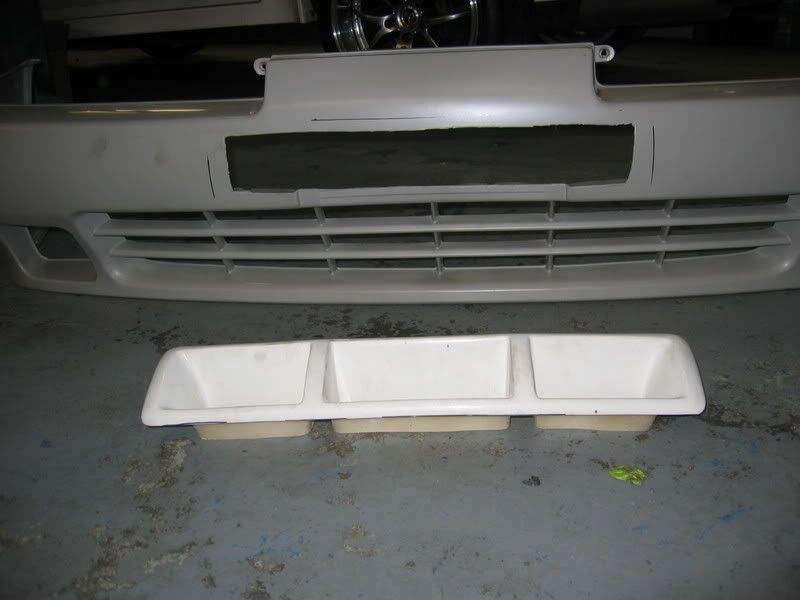

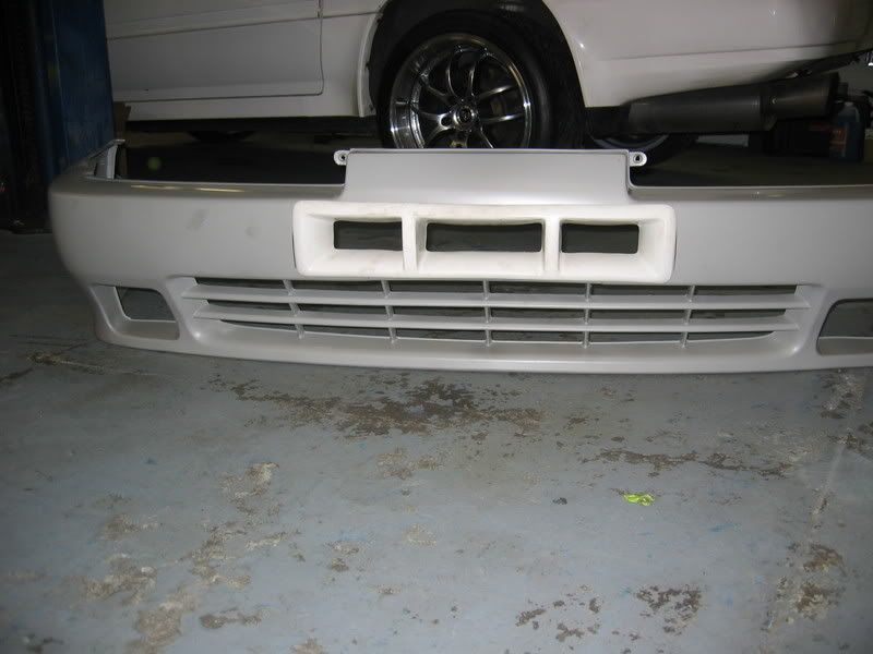

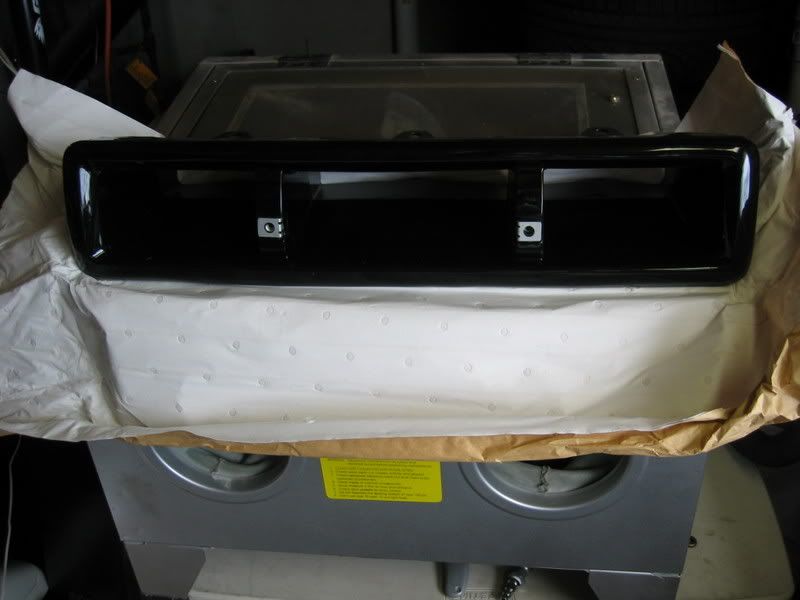

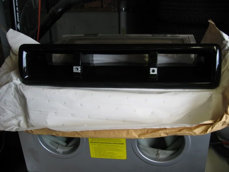

Some more progress pics.
The duct sits a tiny bit high an slightly crooked, it will come down about 1/2" before it is set.

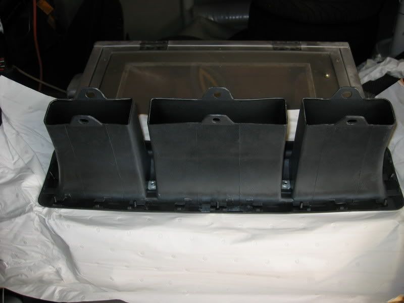

Update:
Just sourced a genuine Toyota Turbo-A duct from down under. So now I have two never installed replicas and two used bumpers for sale.
