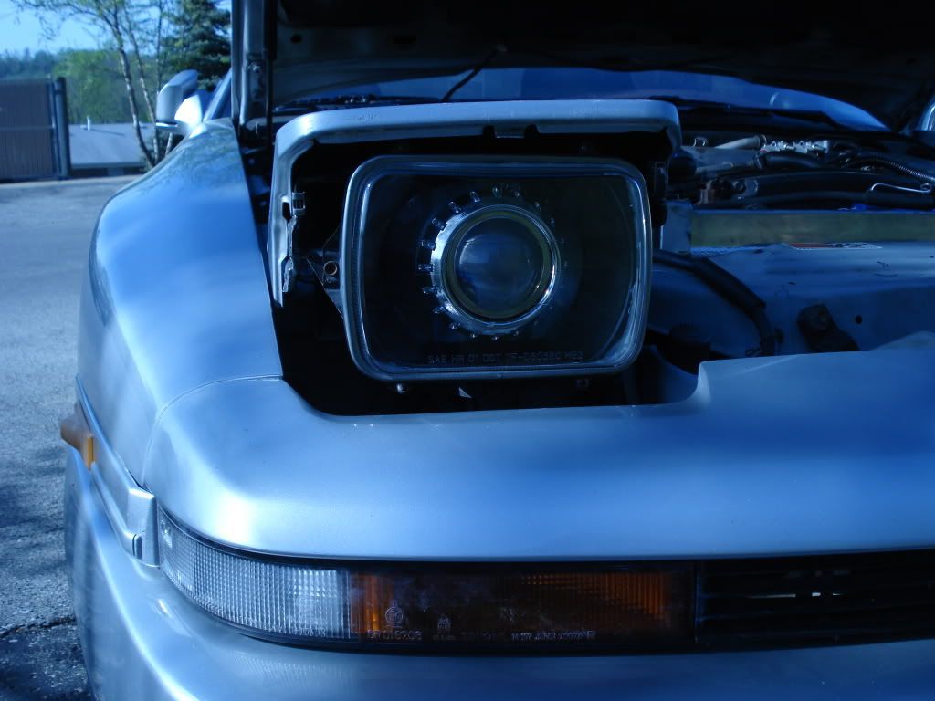

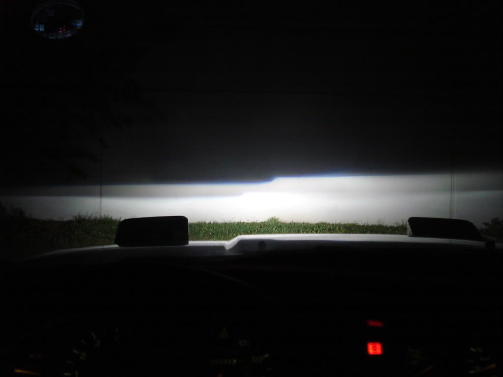

Steve_N;1491251 said:
Yea..Was taken back before I Aimed & Leveled the headlights but still nice cutoff.
*pic*
Looks awesome! did you make your own housing or modify an ebay housing? I feel stupid asking this, but does that one bulb function as both high and low beam?
Im going to take this on prolly spring to early summer. Going with the retrofit source fx-r projectors for sure. What ballasts/bulbs are everyone here using?
Is HIDplanet down for everyone else too?
That looks like a modified housing... everyone I've seen do this takes a cheap Ebay housing and hacks up the rear to mount the projector housing.
Yes, one bulb does the same job for both high and low beam. An actuator moves the bulb forward or backward so that it's either covered partially by a shield (low beam) or not (high beam). This really is a requirement for HID setups, as they wear each time they are turned on or off, unlike conventional bulbs with a filament.
So far, all the bulbs / ballasts have the same connectors, which is great. And really, the difficult part will have been done if you get the housings / projectors set up. I'm using some Chinese generic ballasts, but I've had less than stellar luck with them - to be precise, I've blown 2 of them in ~2 years. There is a good chance I'll pick up some name brand ones next time.
I haven't seen a difference in bulbs. I've never seen an HID bulb of any sort burn out.
The wiring isn't that complicated... a relay to keep the ballasts on, and another to switch the high / low beams, I suspect. You *might* need a diode of some kind to prevent the high / low circuits from bleeding back into each other... and you'll need to verify that the solenoid that moves the bulb is really a 12v circuit.
Thanks for the input! I was thinking of using the Ebay housings but they all have lines in the lense, i wonder if that would effect output of the headlight?
What brand ballasts are you going to go with? The retrofit source claims that the Morimoto ballasts are of the best quality but i have not herd much other then that source.
