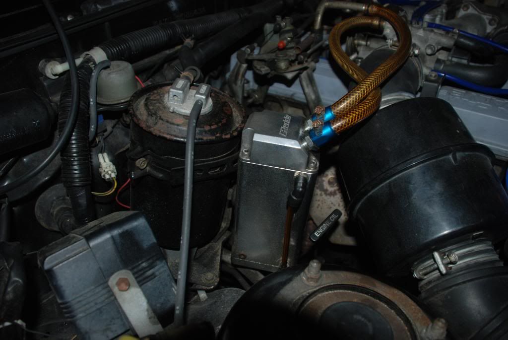

you know what..I think your right..actually, I know your right :icon_lol:

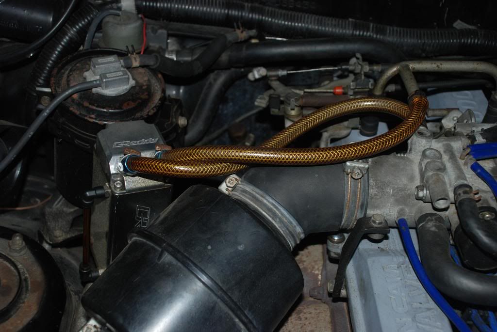

heres a pic anyway:
I don't know why I didn't think of that >.>

thats why I said i feel like an idiot haha
first time I looked at it, my mind thought "fuel lines" for some reason and I never gave it a second thought haha
but now i have a real question, why have a catch can? I thought the PCV was supposed to get rid of those sorts of things from the crankcase, or do our cars even have pcv's?

Our cars have a PCV system but no PCV Valve as such, it's just an orifice into the TB, if an engine is worn it'll get blowby and smoke, often a catch can is added to reduce the smoke.
Don't stress it's NOT the stupidest thing I've seen posted here by a long shot ;)

They dont have pcv valves. Every car has a pcv system tho. 1/2jz have pcv valves
Its there to stop oil from going into the intake.
Some people get nit picky about oil in the intake, some use one to stop smoke from excessive blow by, others for the bling factor.
It is hooked up right tho. Tho it would do a better job on the cold side.

An oil catch can like that will keep oil droplets from reaching the intake under extreme running conditions.
High rpm, and high boost will produce more atomised oil being passed through the some what limited oil traps on the inside of the cam covers.
Giving the blow-by an additional chamber to expand into, before it goes back into the normal PVC system will allow more of the oil to seperate out from the stream, and not be ingested into the intake.
