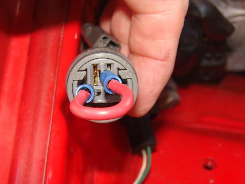

The pictures were for someone who wants to bypass the relay that switches the fuel pump between 9V and 12V operation. Plug that thing back in and go over to the driver side of the car with a paper clip. Open the diagnostic connector by the fuse box and jumper the B+ and the FP, the try to start the car.

For the record, the default position of the fuel pump relay is 12V. All you have to do is disconnect the switching portion of the relay that would turn it to the resisitor.
