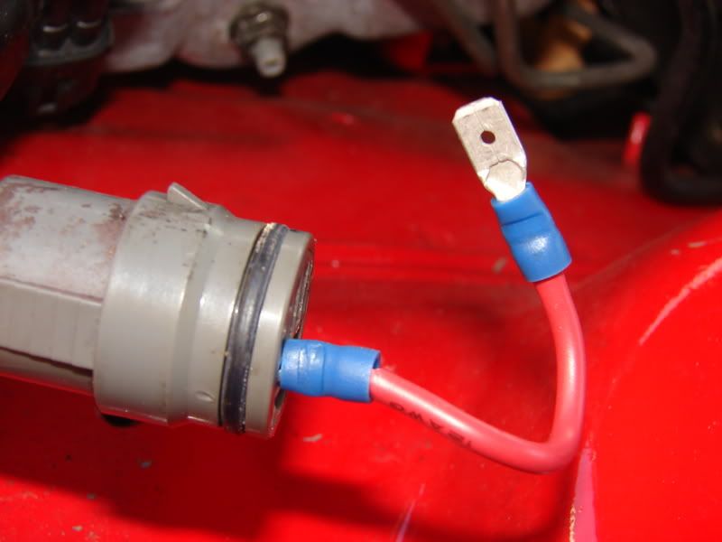

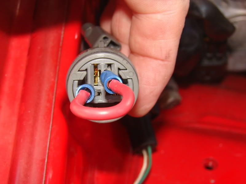

jetjock;1943010 said:
Huh? NAs don't have a COR. Uses a switch in the AFM to run the pump.
Dammit! That's what I get for not looking at what section I'm in, thanks JJ. So jumping +B to FP isn't gonna solve my problem most likely
jetjock
creepy-ass cracka
Jul 11, 2005
9,439
NAs do have a COR. My bad. As I said +B to FP bypasses all that stuff. With them jumped and the key on the pump should run. The switch in the AFM keeps it running after the engine starts. Pushing on the AFM vane should also start the pump but if the pump won't run with +B/FP jumped something else is wrong. All you need to get +B is the main relay and if the MIL comes on with the key the relay is working.

yhatzee89;1942969 said:
So I did the +B FP thing and still no start, everything is back installed and I'm just gonna go get a COR tomorrow and try that :/
Like JJ said, since the +B to FP jump bypasses everything, no point in trying another COR. Are you sure there is enough fuel in there to start the car? Not going by what the gauge says but did you physically put enough in to start the car?
