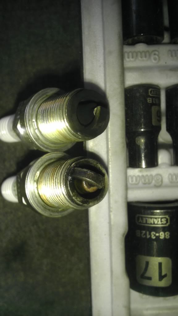

So I took out my plugs today (bkr7e .028) and 1234 and 6 where black but number 5 was noticeably cleaner.
Does this mean that number 5 was not firing ?

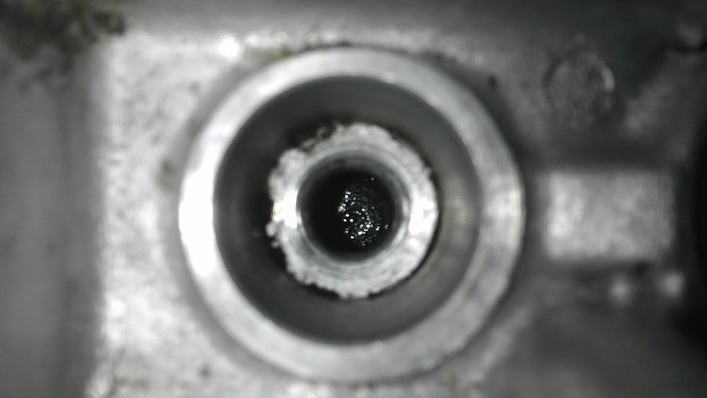

Number 5 cylinder looks damp... :-( the car has been driven about 0.3 miles since the head gasket job. I'm starting to think I fucked something up.
Number 5 plug compared to the rest..

Do you think the dampness is fuel??
Also is it the number 5 plug that doesn't look like its firing or the others.
Just to be clear the dark black plug is identical to #1,2,3,4,6 and the clean one is number 5

Test light should be available at any parts store and useful for a lot of jobs, if it flashes on #5 the wiring is fine, if you swap injectors and the swapped cylinder dies it's just a dead injector, it happens, if #5 stays dead it's something mechanical maybe.
