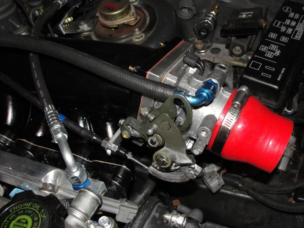

got a pic of how you mounted throttle cable to the throttle body?
is your cable mounted to the intake to hold it in place?
toyotanos
What will we break today?
Nov 29, 2008
2,844
Coon Rapids, MN
Here's mine, my manifold is flanged for a Q45, and I have a spacer/adapter plate that goes to the stock TB- cable bracket bolts to the adapter flange bolt.

All depends on what style and the way it was made.
If you order one from seth you have the option for it.
