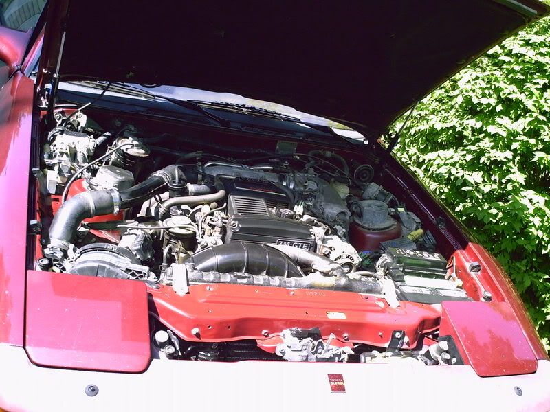

It was the end of a long ass night and i guess it wasnt quite the end. Forgot the hood latch cable and now my hood is stuck shut :cry:
I need picks of the latch so i no what i am attempting to do to pop it.
Also im sure im not the first person to do this so what do most ppl do?
Thanks.

The stock IC takes like 5 minutes to remove..not a big deal, really. That is pretty much the only significant thing stopping you from reaching it from the bottom.

This might help.

I have a big FMIC and i dont no if i can unbolt it from the bottom.
plaaya 69 can u get me a close up pic the actual mechanism. I have no clue what i am even trying to pull to pop my hood.
Thanks for the input. Im glad that it sounds easier than i expected.
