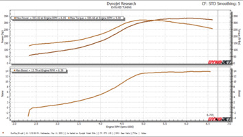

Smooth curve, shocked that it made so much torque. Going to need to eventually get that boost controller hooked up so I can ramp in boost earlier, its just a little lazy.

That should be a lot of fun. What did you do with the Holset?
I was low 400s with the holset, but that was at 18-19psi. It spooled entirely too quickly (was seeing full boost at like 2400 rpm) and I eventually want to get some cams and rev out to around 8k.

I like those numbers for what I'm aiming for in a daily driver, I think I'll send my Holset out to be rebuilt and run it.
Which holset do you have? I had a HX35w with the BEP .70 T3 housing. Lightning quick spool and it held 19psi to redline. Based on the fuel I was pulling, I was in the low 400s.
