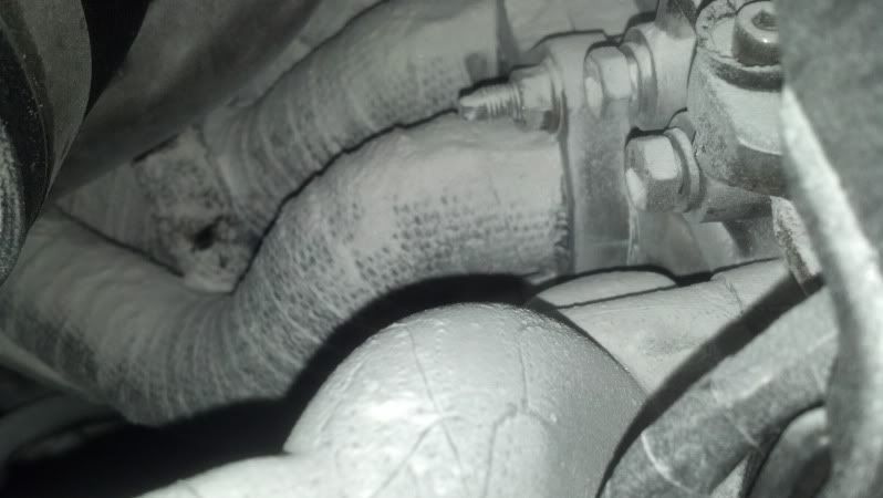

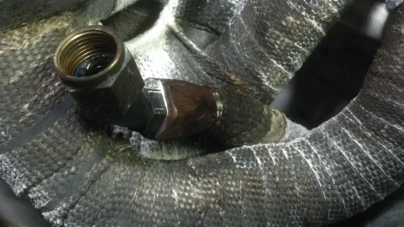

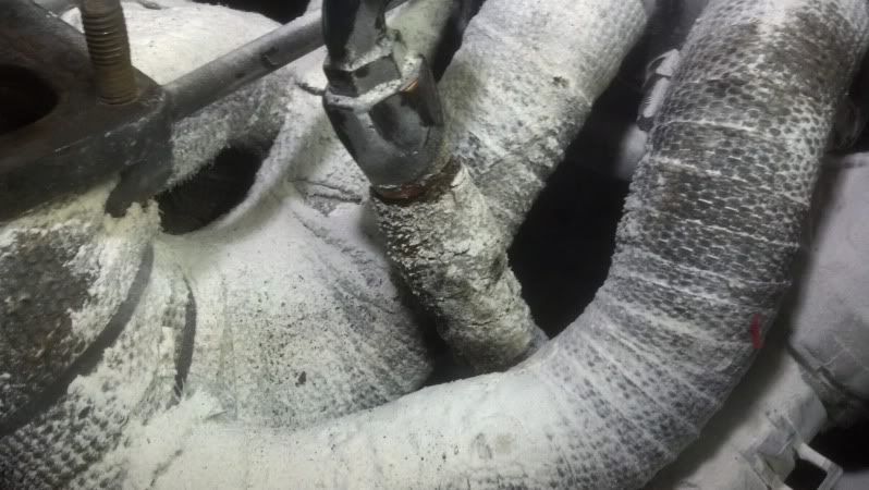

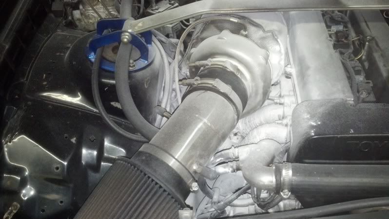

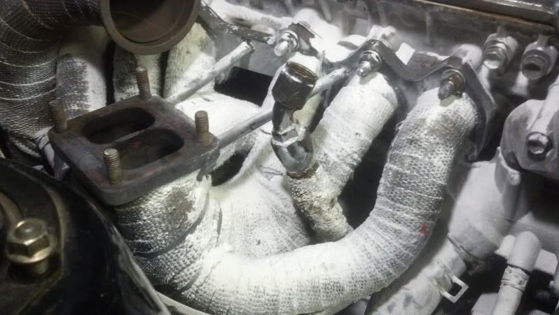

pics added. obviously wasn't going to let the fire keep burnign while i take pics. ;)
It's going to be a PITA and slow but it'll get done. Now that its down I can fix some things I've been wanting to fix for awhile that I couldn't while it was up and running or else there would've been down time. It'll be cleaner this time around. Probably gonna get the valve covers repowdercoated.

Yeah by looking at your posted pictures, that return line was in a horrible place. The hardline shouldn't be too expensive to make. One of my friends has the same setup as you and he used a hardline with his. Best of luck on your rebuild.
6,625
I would second the idea of a hardline, might fashion it to have a bit of a flexible section. IIRC, the stock line is like that isn't it?
Oh, and I'm sure you have figured this out by now, but it's always a good idea to keep a fire extinguisher in older or modified cars. ;)

The way I see it;
Just route your hardline/hose Forward instead of between the exhaust runners, Heat should not be much of a concern there...
But the real problem must have been a leak form Turbo/AN fitting...
