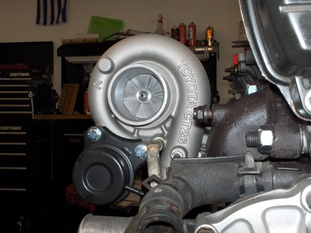

motor is timed, 7/16" exhaust studs installed.All i need to do it finish up the intae manifold...

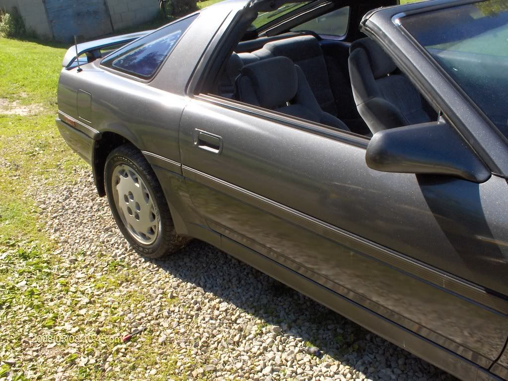

also, i decided that i dont like my car, so i i'm picking up this one tommorow...

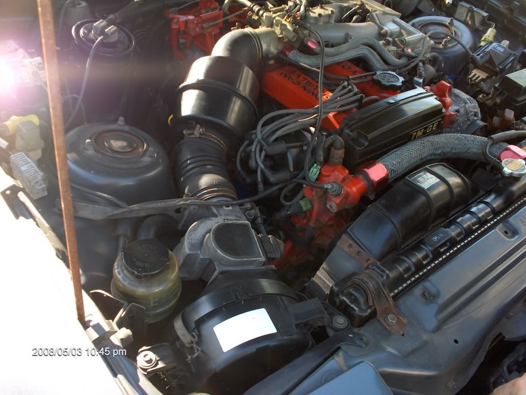

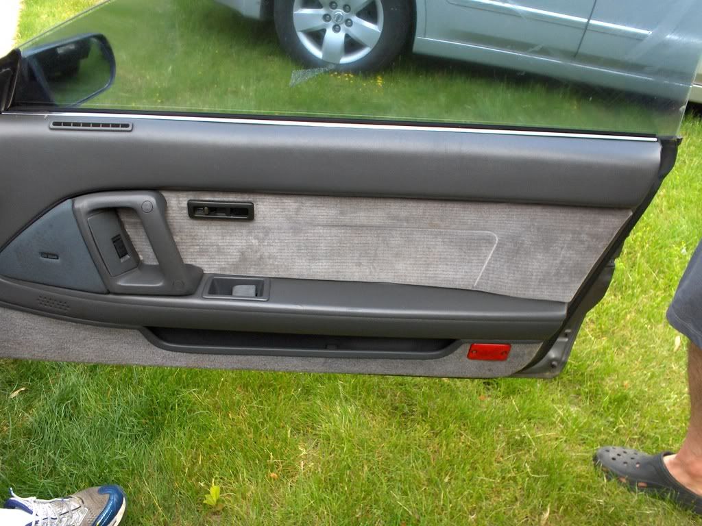

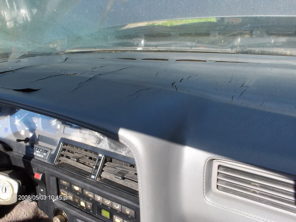

Aside from being a pre-89, it's perfect.'88,flawless title,Doesnt run, but NO RUST AT ALL!florida car till 4 years ago...260k miles but aside from the cracked dash and minor rip on driver's seat that has been repaired, interior is MINT!I love gray interior.always hate my burgundy.this this is my dream mkiii.To bad its NA, i could used some parts but o well...
o did i mention i love sawblades (blasphemy?)

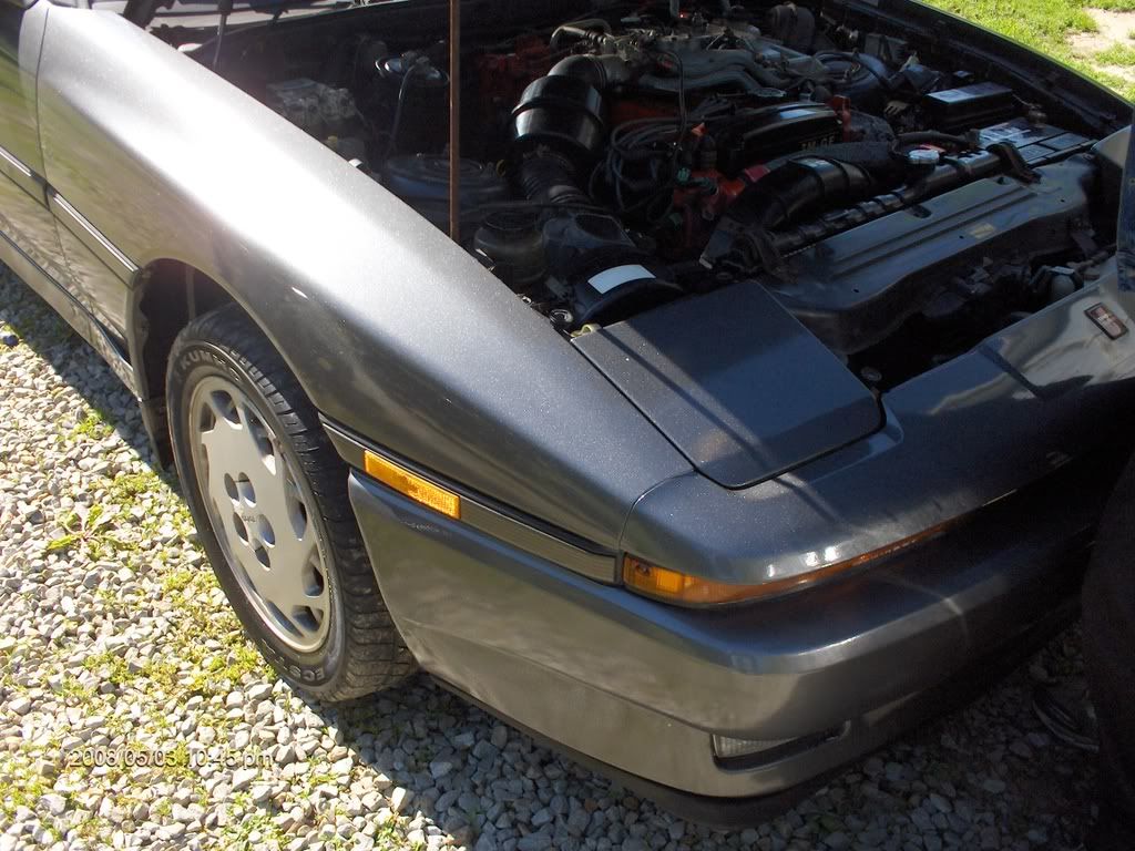

So the gray car has a minor targa top leak, i removed it and reinstalled per sequence and still leaks a lil but nothing major so i just put duct tape over it lol.any ways i need to swap tails from the 87 cause the 88 has a crack on the left ones.also need to swap rims, even though i like sawblades the turbp rims are gonna look better if i paint them.Also how do i know what rear end the 88 has?i need to search i guess.would probably be wise if i swapped those out to.

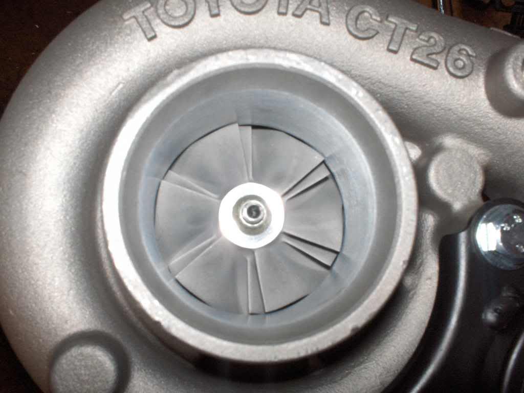

Anyways exhaust studs=done, turbo is in :icon_bigg
LOL

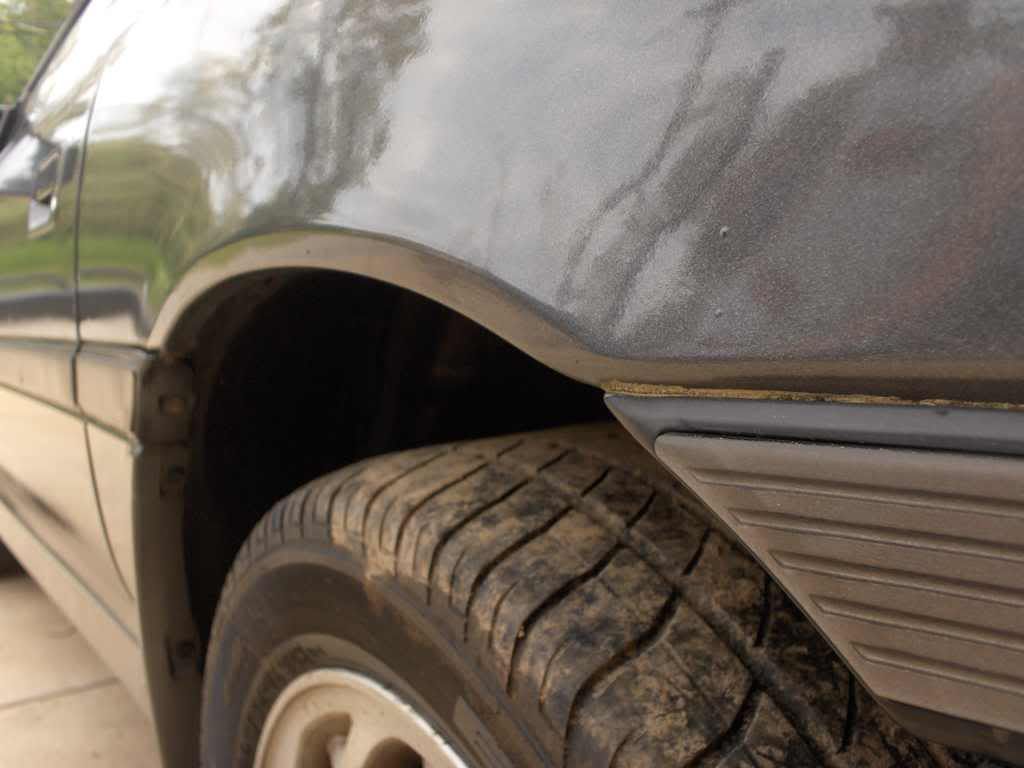

only rust i can see, aside some surfave on the spare wheel well
compared to:

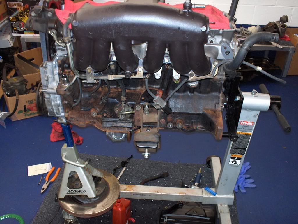

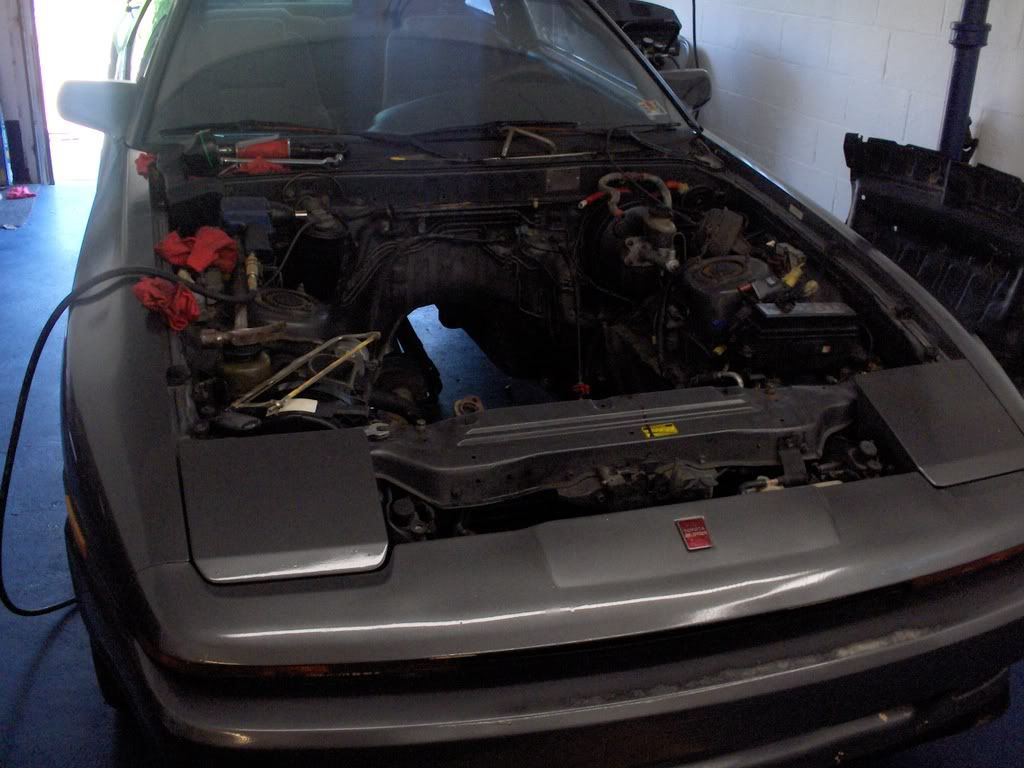

I checked my valve clearances and it looks like i have alot of shimming to do...I got the special tool which is going to make it easier thank god.So for now all i have to do is put the rear main on and oil pan then clutch and tranny and wait till i pull the other engine and steal the shims off of that.I also need to replace all the vacuum/coolant hoses with new ones.I ordered my plug wires through advance auto today since pep boys took forever so i just canceled.

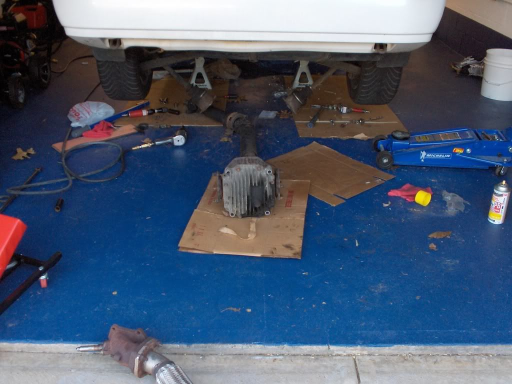

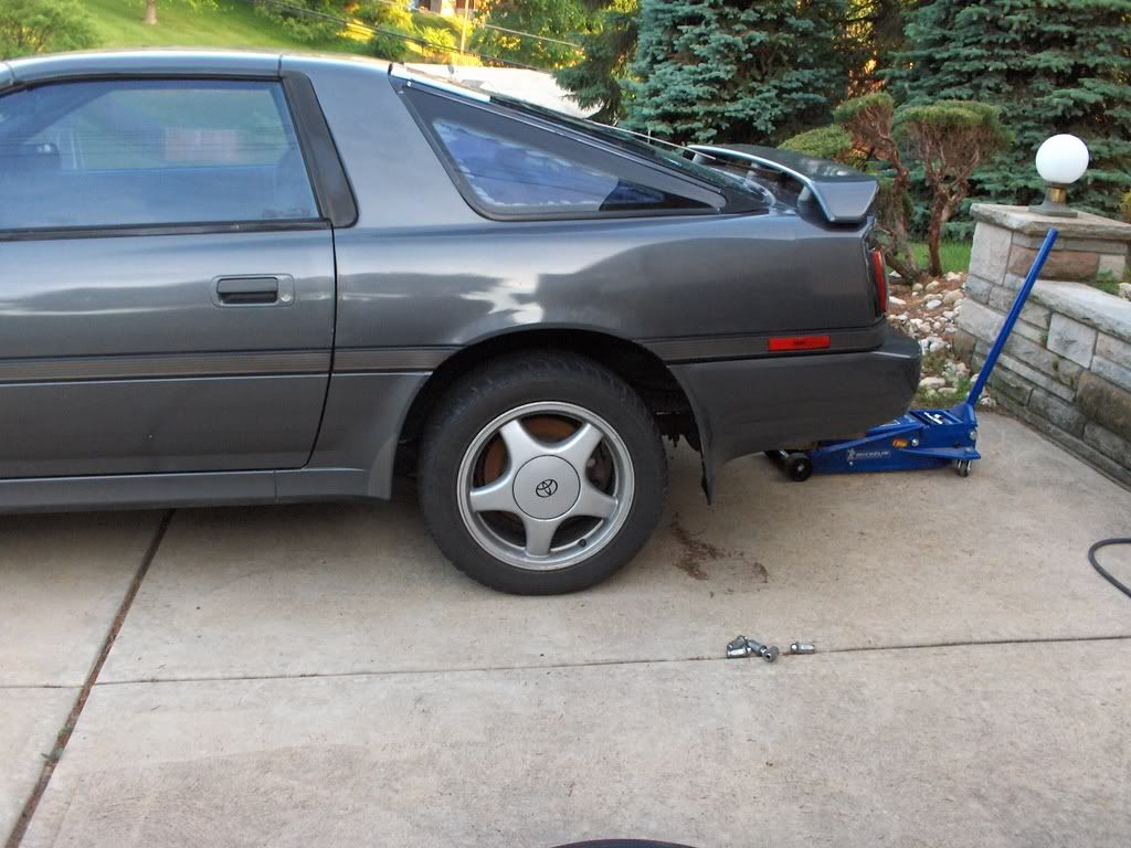

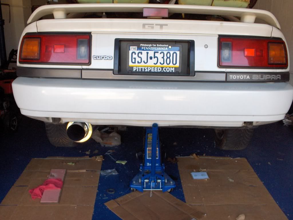

Yesterday I pulled the pumpkin from the turbo car so i can swap.Much easier than i thought.Also swapped rims.i thought i liked sawblades but the five spokers are much nicer looking. I also just pulled the HAC sensor, igniter, and ECU from the turbo car.That should be all the parts i need from it.

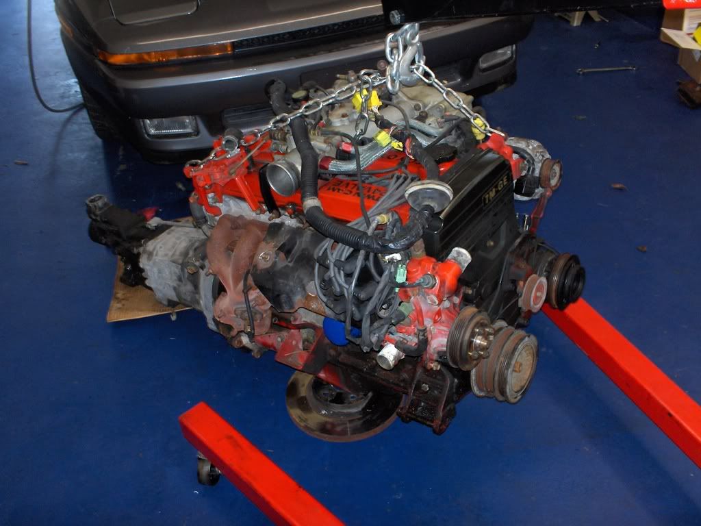

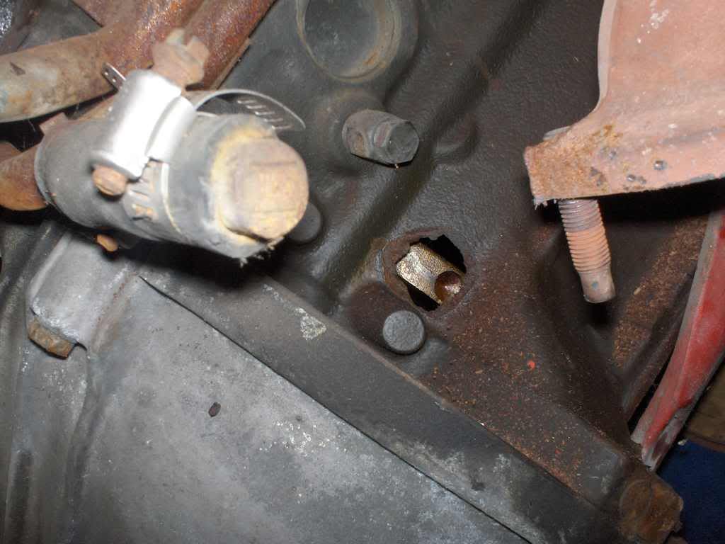

Second, this sunday me and my buddy pulled the motor!It only took us 3 hours and we had a big ass lunch in betwwen.Also the freaking down pipe was a complte bitch as it was stuck on the manifold.Had to remove the exhaust completely from the hangers before we could ry it off.It was a complete bitch though but it was the only rough spot in the process.
My dad also managed to tear his calve muscle while pushing the sup :nono: so becareful when pushing these tanks guys.

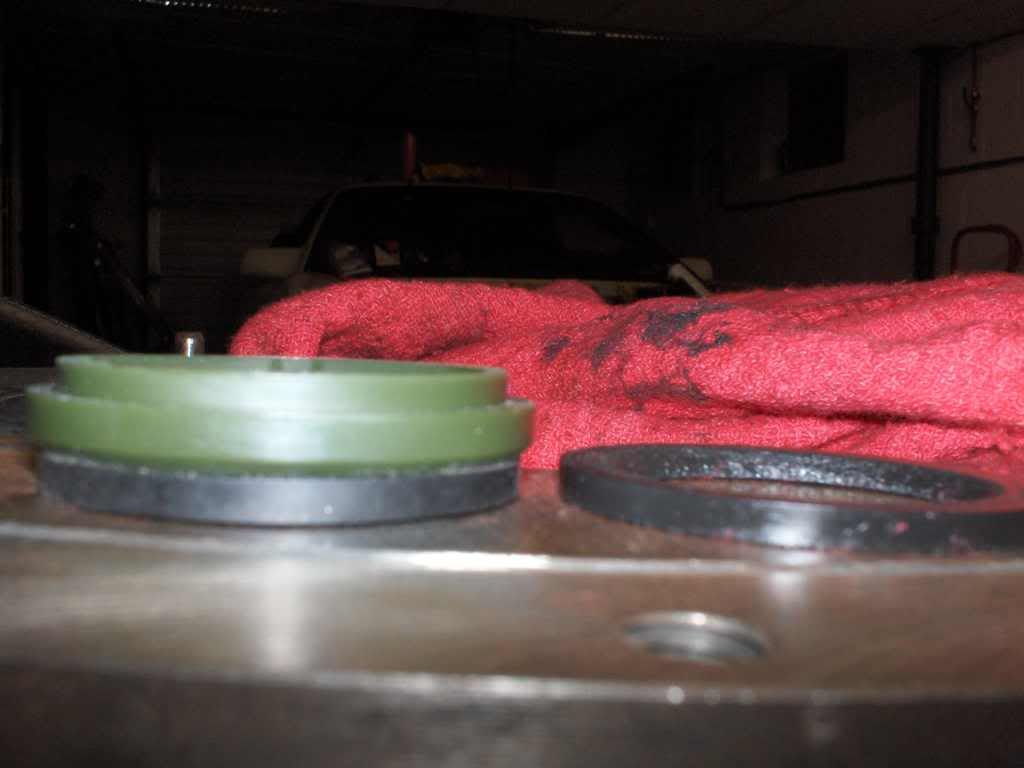

O yeah, and i think i now know why the motor woon't turn over....
To the left, my new r154 shifter bushing from DM.To the right, what was left of my old shfter bushing!I do not know where the top part is (in my tranny :3d_frown:) but this caused my shifter to rattle when the car was running because there was no tension on the washer that goes on top of the spring in the shifter assembly, so it was rattling inside the shifter housing.
