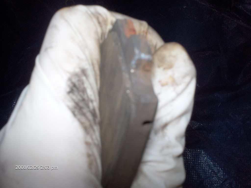

So back when the car was running i took a couple buddies out on the high way and did soem 130+mph pulls when soem lumina changed lanes into my mine.panic stop and holy FUCK brake fade haha i HAD to down shift to 3rd in order to not rear end this guy...stupid long story short i knew i needed brakes since i bought th ecar so i got some fornt brake pads and took my rotors out so i can machine them at work on monday.hopefully they are not under spec (by much :evil2: ) .

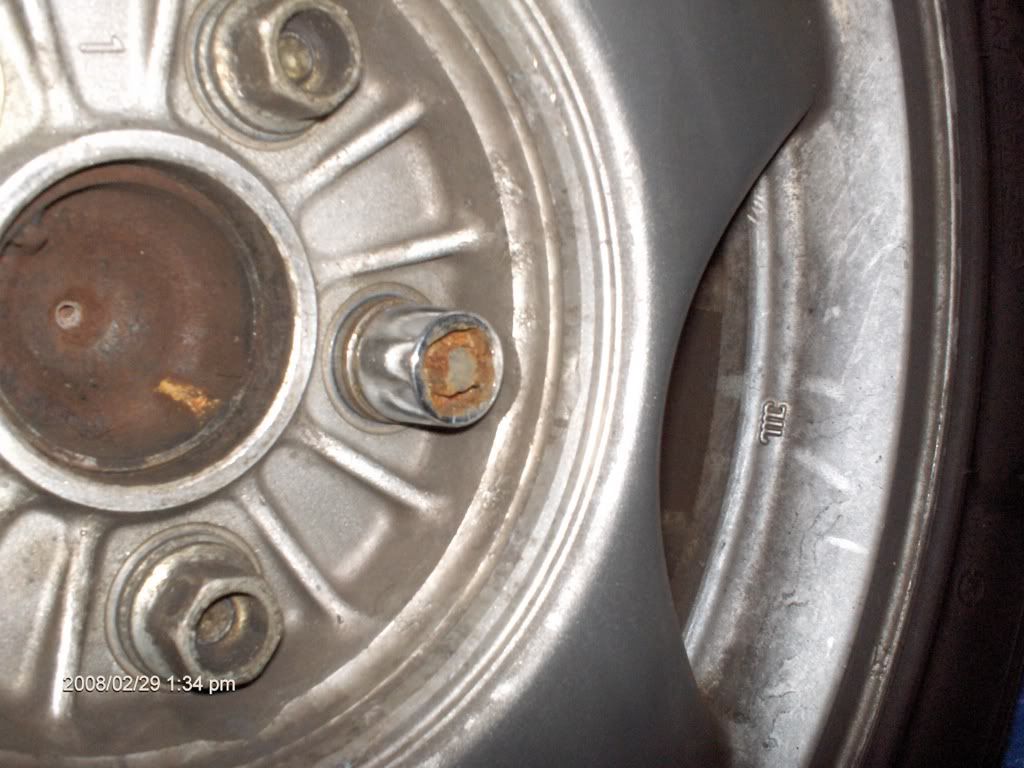

so anyways 10 months owning teh car and i did not know it had wheel locks...
of course I spent 30 munites looking for the damn key, and as I almost gave up hope it was still in the car i lifted the spare tire and there it was.smart place to hide it prick.
i'd say this is 1/32" left.i expected no pad at all...

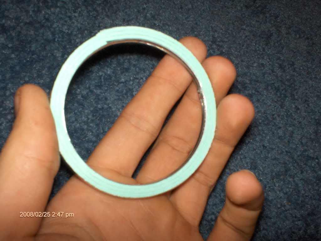

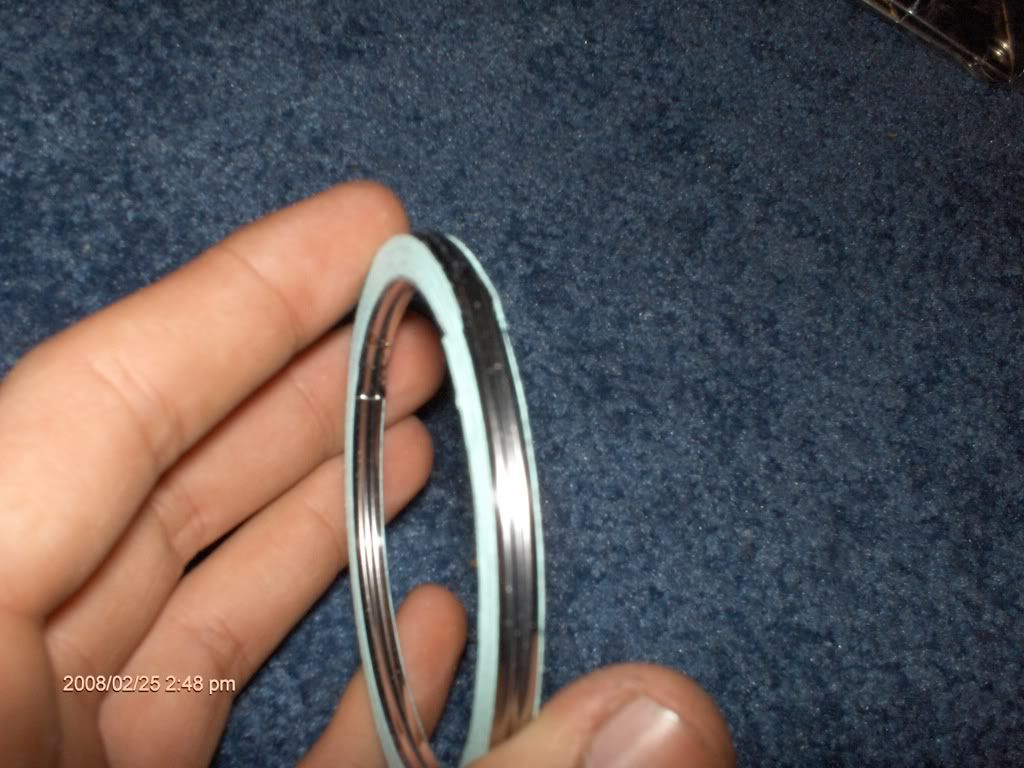

Also what the hell is this thing?it came with my gasket kit...i havent seen it in anything i tore apart so far...

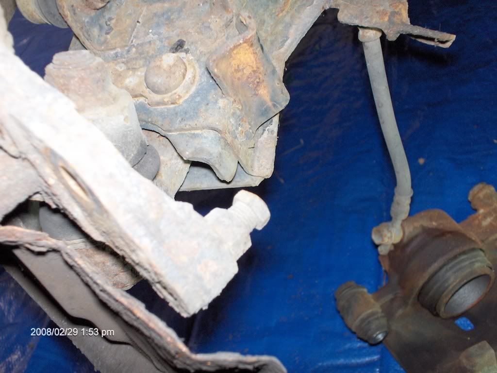

also, i think i found my popping noise when i turned my wheel all the way to the stops...is there suppose to be something rubber on that bracket opposite to the stop bolt?

all the supra's i've worked on never had a rubber bumper on the stop.maybe they fall off after awhile.

That extra gasket is the exhaust seal for N/A motors.
As far as a popping noise when turning, look at your lower control arms and rack and pinion bushings. There is no rubber bumpers on steering stops.

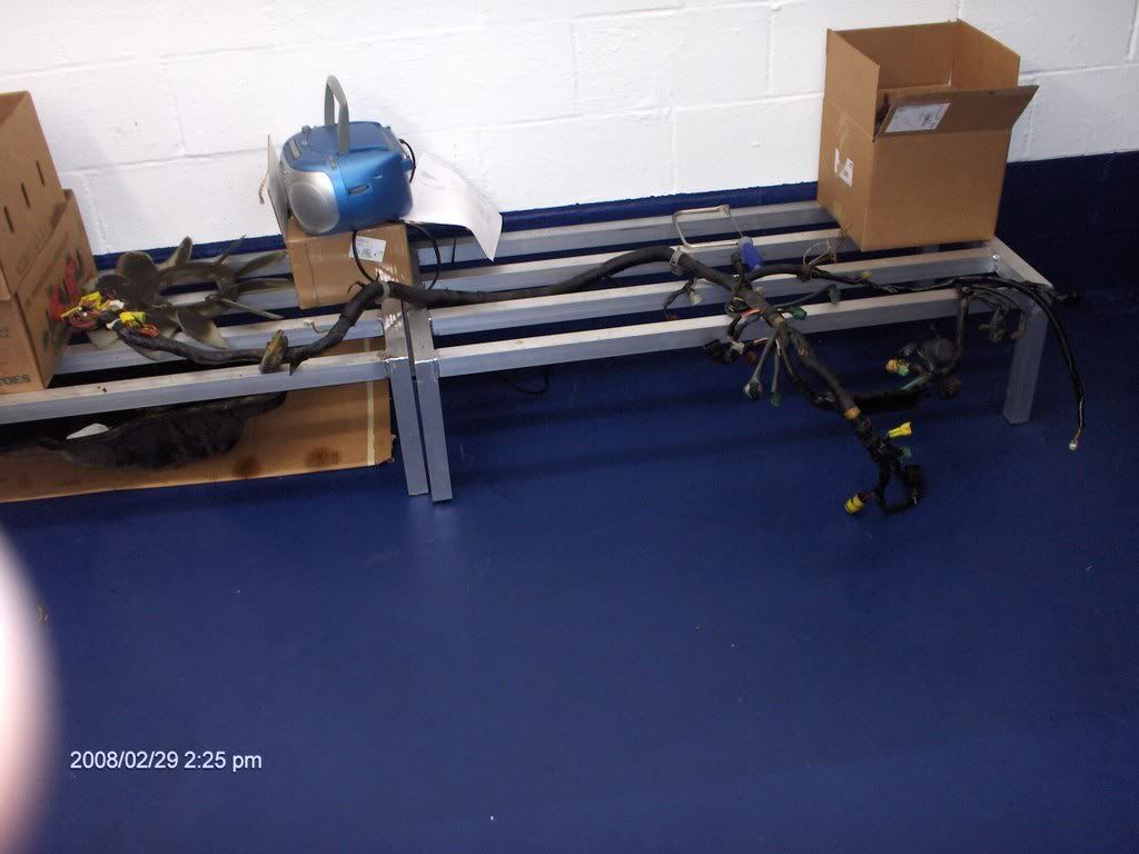

well i got home this morning and my dad had fun with the harness...
certainly looks better than it used to

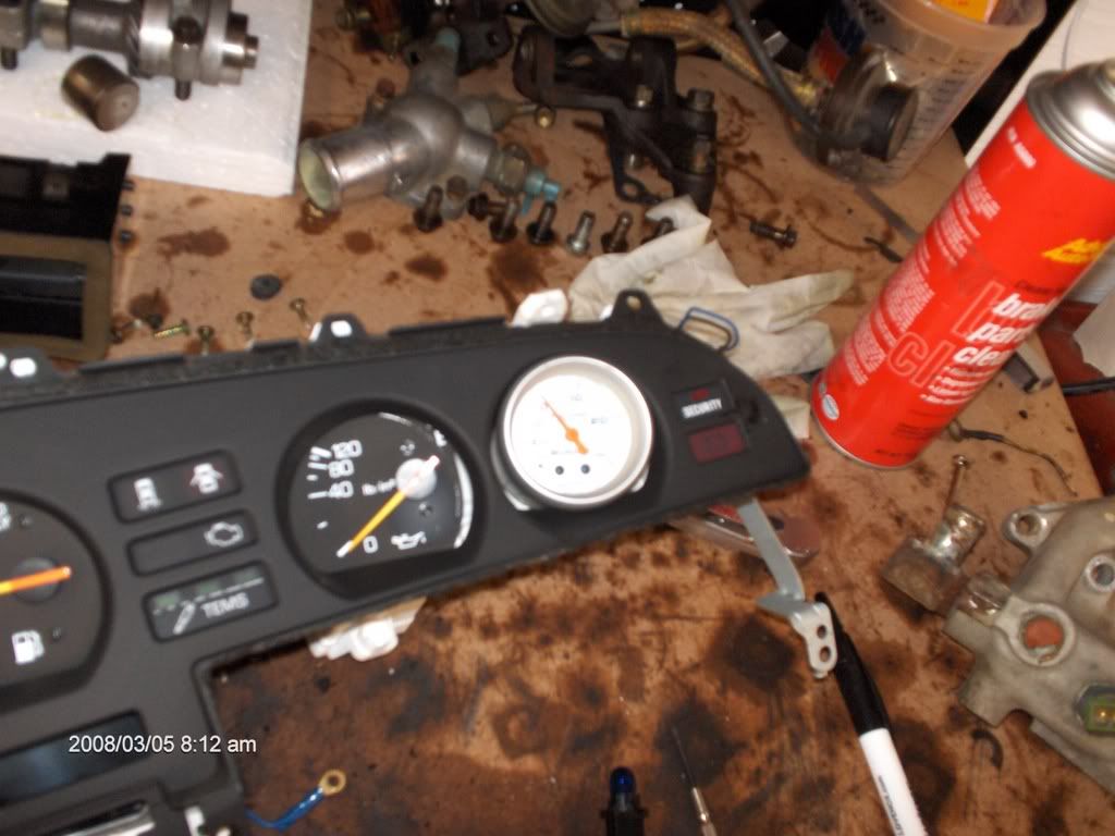

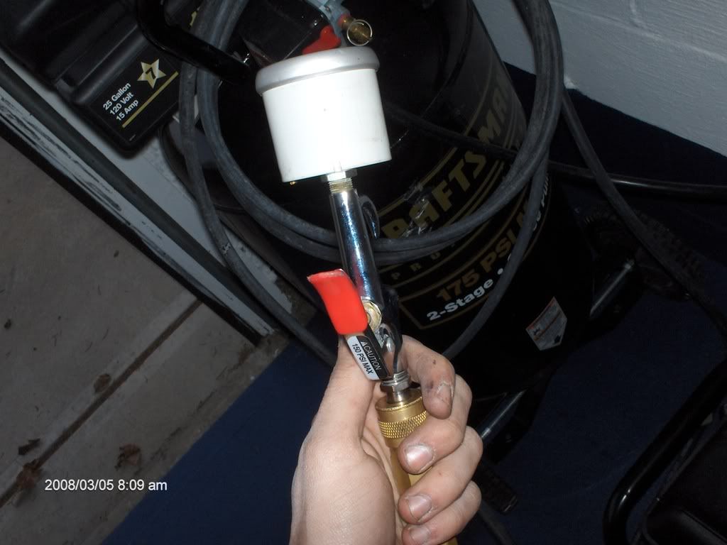

:x:i decided i absolutly despised my el cheapo autozone boost gauge the previous owner had dry wall screwed in there so, i started fitting my auto meter gauge in there.this is no where near done, just took the cluster apart to see what i'm getting into and to be honest for the amount of work required i really wanna get soem 60mm prosports in there :icon_razz

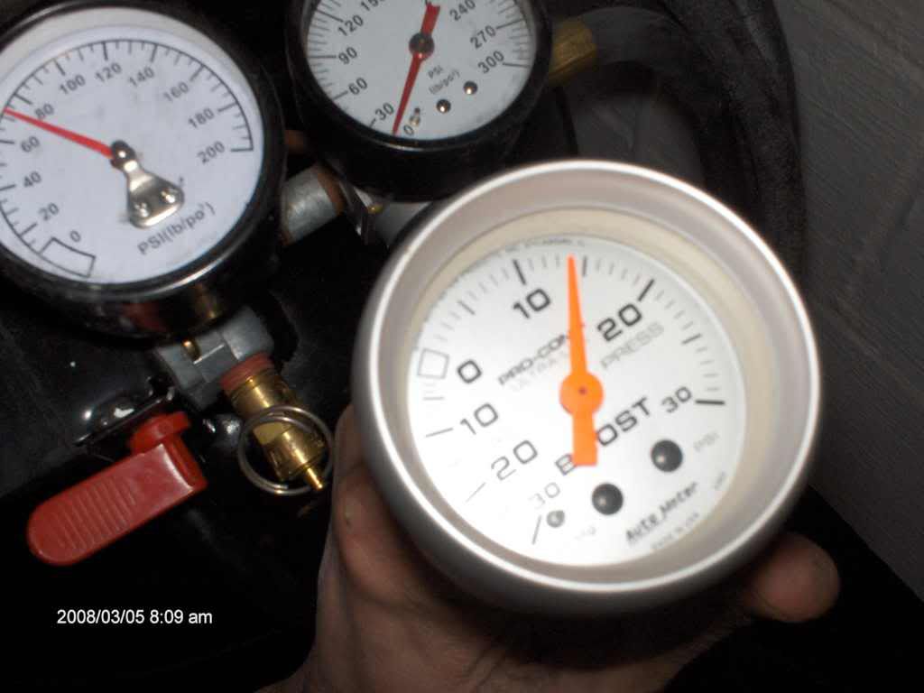

i also tested the gauge, it screwed into my blower nozzle perfectly
14 psi on the regulator, 14 psi on the gauge!perfectly calibrated...gotta love autometer :icon_razz
