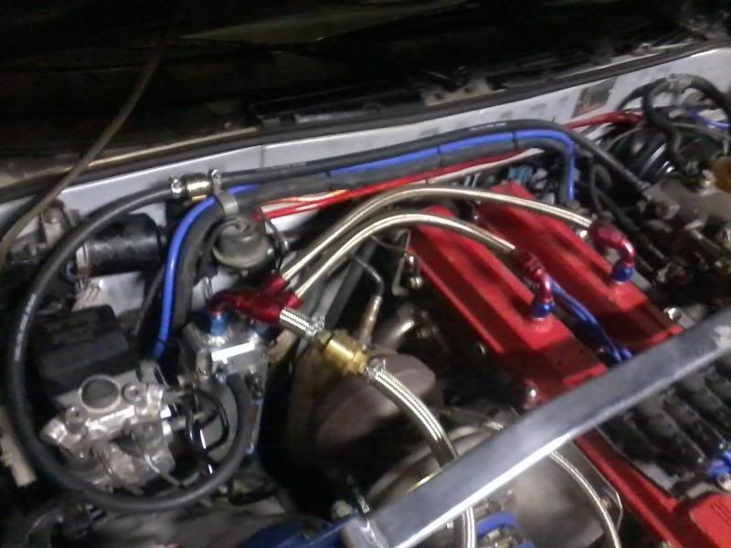

Sorry for bringing the thread back from the dead but I'm having pretty much the same problem now!
(If running standalone based on MAP and ) running a catch can wouldn't that cause pretty much a vacuum leak as the manifold port with a PCV valve inline would suck air out from the intake tube (Easiest route) and not much if any vacuum would go to the cam covers?

So, did the new hose with vacuum from the manifold. Check valves on both sides. Idle rose about 300rpm, idle AFR's of course to 12.5-13. Then I noticed that the stock system had a couple mm wide bottleneck in the throttle body! Though the pipes coming in and out for the pcv are pretty large when you look at the TB.
My system was made with 8mm hose and ends.
Should I not worry and just retune my idle or should I also make manifold side hose end smaller - "add a bottleneck" and then retune my idle a little bit?
Didn't see much of a difference for the vacuum on the boost gauge, maybe about 0.02 bar ?
What you think?

The stock TB has that small orifice because it doesn't have a check valve. The movement of air over the valve cover fittings is what draws out the vapors in the stock system.
With your system you should only have a check valve on the TB side. The intake side before the turbo won't see boost so you don't need a check valve there.
Make sure the catch can is baffled too, without baffling the oil vapors won't settle in the can and could get sucked into the turbo/ic pipes/ffim etc.

My thoughts were if I don't have a valve on the intake side the vacuum from the manifold will probably go the easier way - rather suck air from the intake than the valve covers which is harder. But anyways I have it now.
What interests me is - did I do too large of a hose to draw the vacuum from or am I good to go? Not a large "vacuum leak"?
It sure is baffled with some supermarket steel wool :D
