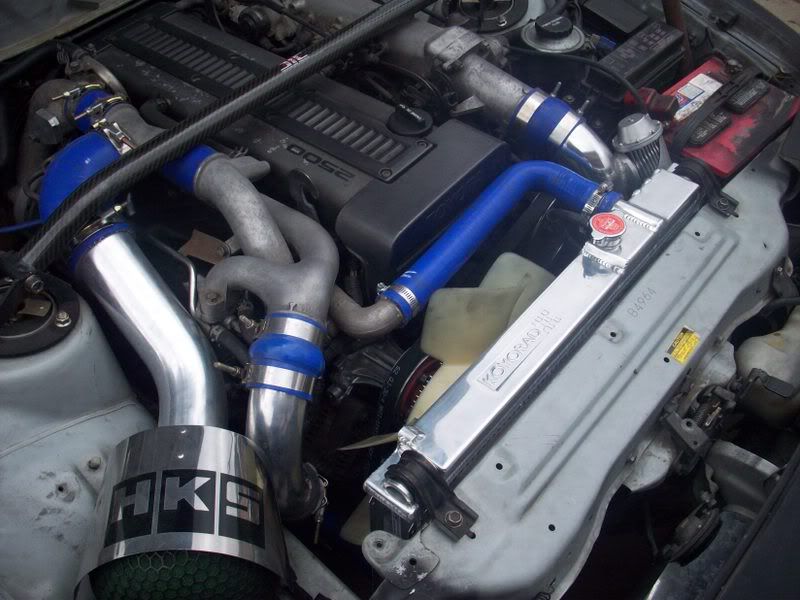

I need some help, I'm trying to put a fan shroud for my 1JZ, I'm currently running the MK4 GTE fan clutch and a koyo aluminum radiator, my problem is that I tryed installing a fan shroud that came off my 7M but it wouldn't line up, is there something different I'm suppose to use, I don't have that much room, if someone has a similar set up please help thanks in advance

HERE IS A PICTUE OF MY SET UP.

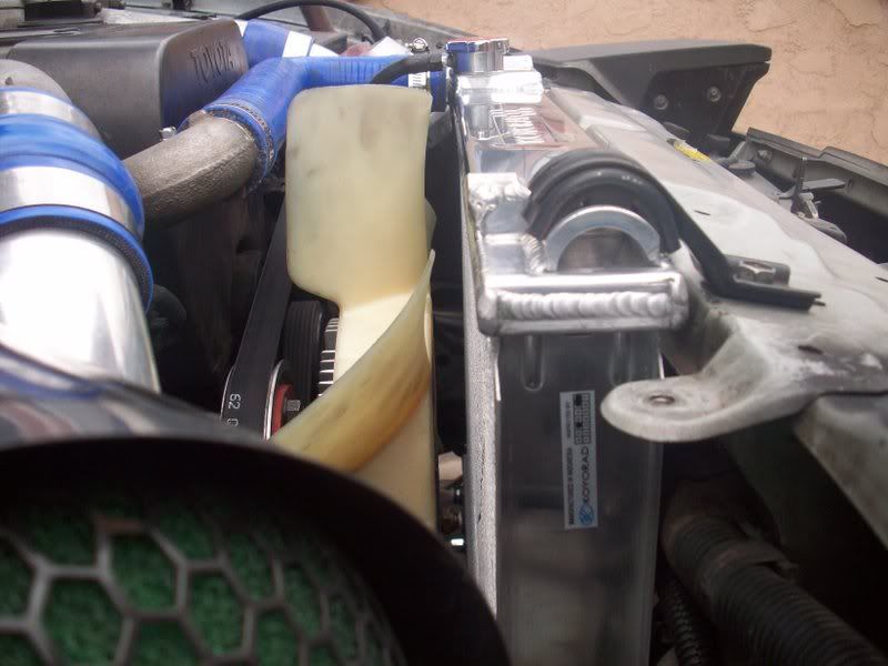

Well I have the 89+ fan shroud from a 7MGTE but it only bolts to the top of the radiator and the bottom doesn't. Is it suppose to bolt all around

No, it's not supposed to bolt all the way around since the 1JZ shroud/radiator is different and the koyo is for the 1JZ...
Make brackets to hold the bottom on like I did...

I has just thinking to myself “I bet my 7mge fan shroud won’t line up with my 1j.” I was thinking of making a custom shroud out of sheet medal this way I can mold it to my likening. There seems to be a small limit of space in there though.

I'm using a pre-89 7M shroud with a 2JZ clutch and fan. I have it setup with a factory 7m radiator, and the clearances are very tight even with the thin factory rad. Actually I had to modify the stock hold downs so that I could pull the radiator back a little bit more away from the fan, because it would hit under braking.
I really don't think it's going to work out too well with the big Koyo, Aaron from DM was talking about using a clutch from an LS400, and a stock 7M turbo fan, to get the most fan to shroud/radiator clearance.
As far as it not lining up, I'm lost there. I've had my factory shroud on 3 different radiators, and it's lined up on all of them fine. You might have to make brackets for it to bolt to the Koyo on the bottom. On the stock setup it has little slots it slides into on the bottom.

im thinking on the custome fan shroud is a better idea, and if its done with sheet metal it will be slim to fit
