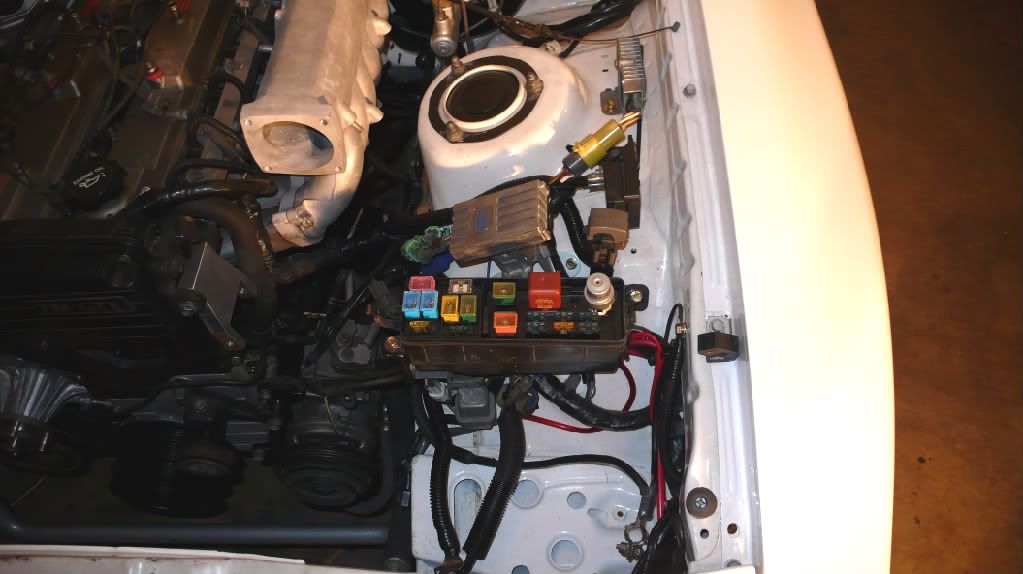

Get your hands on a fuse box from a parts car if you can...you can get an additional four fuses in the box with a little bit of work (on the left in the picture)

adampecush
Regular Supramaniac
May 11, 2006
2,118
Edmonton
damn, if I knew my ass from a hole in the ground electrical-wise, I'd be pretty excited about that. Nice work.
