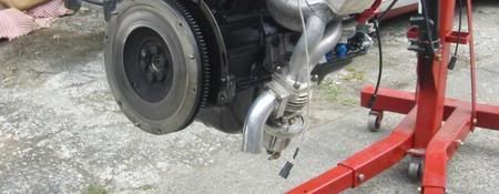

Leaking at idle: You probably didn't get/install the flange with the raised lip: (Fire ring flange? I dunno.)
What I was saying is the GReddy 4-bolt wastegates have a different exit than the HKS.
You can see the dump exit is on the shorter width, vs the HKS which is on its perpendicular.
I'm using the same GReddy set up that Brent has pictured here. Works flawlessly.

MK3Brent;1039341 said:
That's Duane's old engine.
I use TiAL products.
Ahh! Either way it's a proven gate and is stiil working great for me after all these years.
