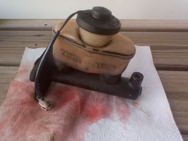

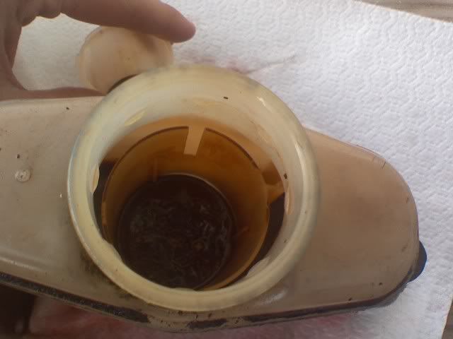

Every once in a while, my brake master cylinder will have low brake fluid. I assumed that this was because i had a small leak somewhere. NO problem, could fix later. 2 Days ago the brake light came on and i did the usual. Fill HER up! But then, the next day, the light came back on. So i add more fluid. Pumped the brakes once and started the motor. The motors starts to sputter horribly and white smoke starts to come out of the exhaust. I was like HOLYFUKCINGSHITE-BHG!!!!!!!!!!!!!!!!!11111
I went to smell and it smelled like burning brake fluid. i was like WTF!?
This has never happened to me, for any of MY cars.

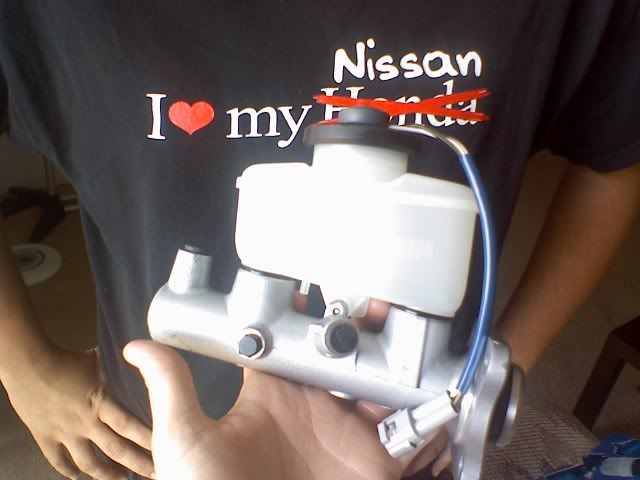

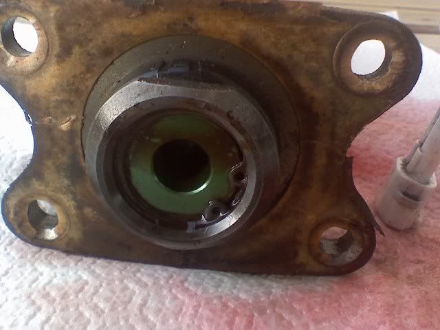

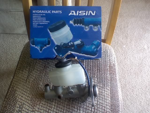

Called my Cousin at his auto shoppe and he said that the seal from master cylinder to the brake booster was shot. So i ordered a new master cylinder from Aisin.
Why did this happen?
I figured,using my deductive skill ;] , that when the seal broke it sucked in the brake fluid into the engine.
but not sure.... :\
ALSO the brake booster was clean, but had fluid inside, so i pumped the brake and flushed all the fluid out :]
