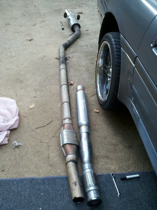

I have a generic Apexi-knockoff fartcan out back, and it's quite tolerable with the silencer in, but I wanted to get rid of some
of the drone, so I welded in a perforated resonator after the cat. Didn't do much, though.
New metal substrate cat, resonator, and 3" V-band:
