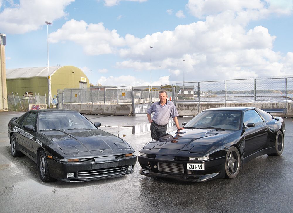

Before and after pic

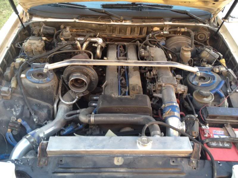

Before, almost. after as soon as I can get my camera working again.

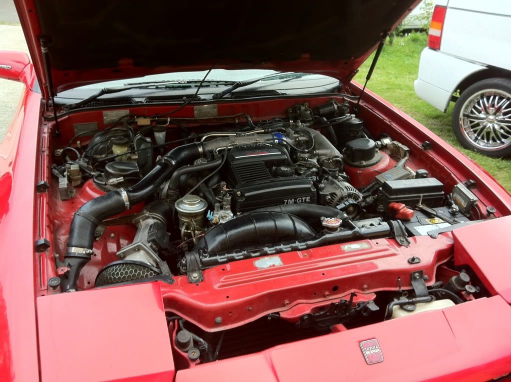

Before:
As she sits now stored for winter, ran out of funds so over winter will be getting the hardpipes and upper radiator hose hardline, and a few other goodies thrown on:

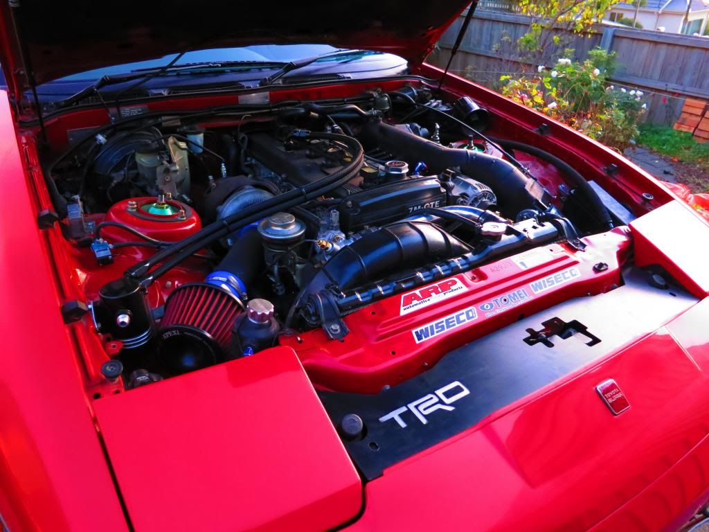

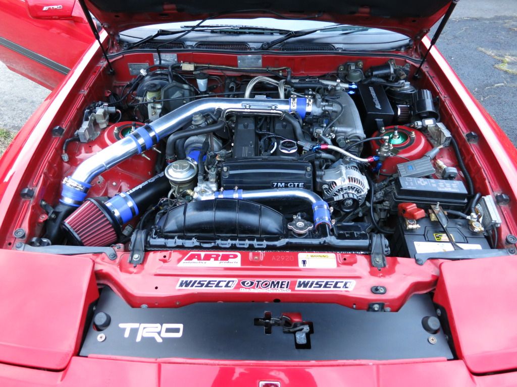

Grandavi;1978708 said:
Where did you get your TRD blockoff plate?
From the AUS Supraforums. A member was running a group buy. I just had mine laser inscribed with the TRD logo and painted it satin black.

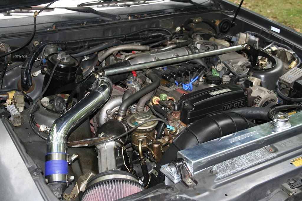

It's an 87. It spent 3 years getting rebuilt and 8 years living in a garage.
Prior to all that it was a rotting clunker with a blown head gasket.

The biggest difference is a Rebuilt motor with .020 overbore, polished and decked head, 2mm metal head gasket, and rebuilt turbo.
550cc injectors
Walbro fuel pump
Turbo back 3 inch HKS exhaust
Lil parts such as custom fuel pressure regulator and blow off valve.
Apex-i Air fuel controller
Lowering springs and tokico struts that work with the tems units.
and a few other things.
