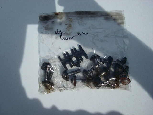

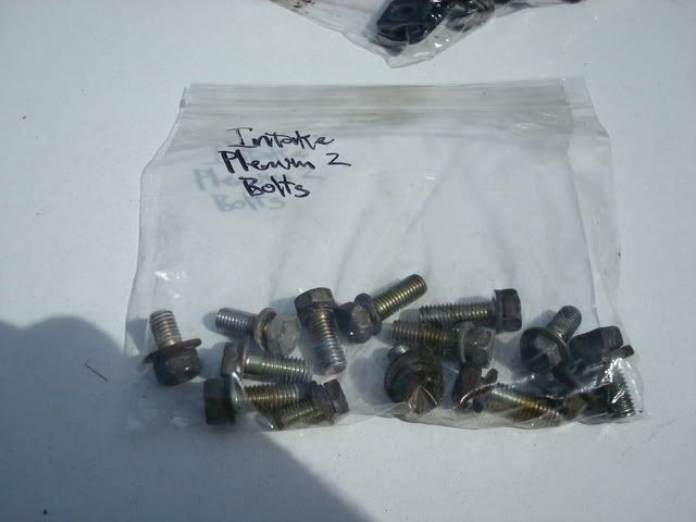

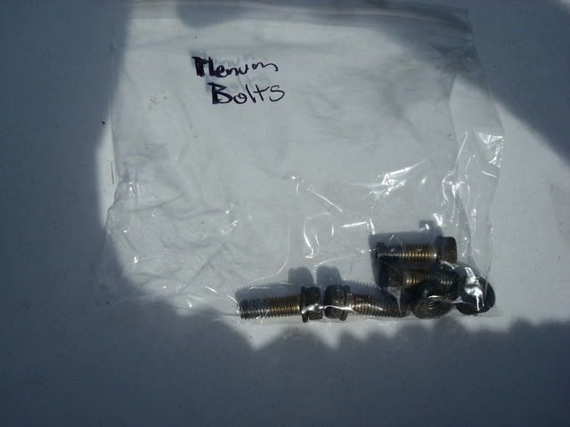

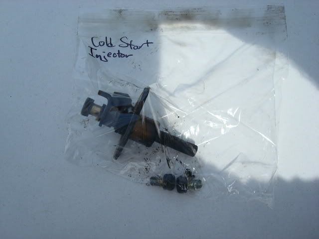

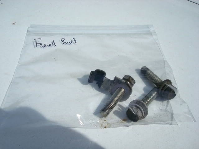

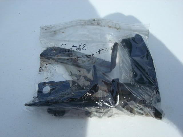

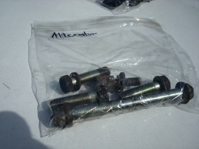

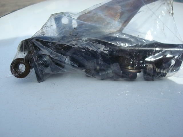

Mondo
May 26, 2009
132
Wisconsin
If your a visual person, this may help also.
