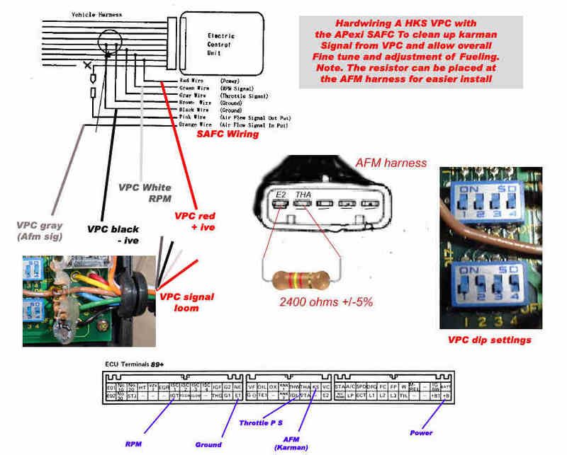

I recently installed an HKS vpc w/550 chips into my car but since my harness (87-88) didnt fit into my 89 supra I decided to hardwire it and used the 2.4k ohm resistor into the AFM plug and followed the newer connection chart on this thread:
http://www.supramania.com/forums/sho...t=vpc+hardwire
I removed my lexus AFM and replaced it with a pipe and installed my IAT sensor onto the ic pipe next to the 3000 pipe and installed the Map sensor onto the manifold vacuum lines. When I start the car it has a rough idle, and black smoke comes out the back and my plx systems wide band registers 14.7. After about 30 seconds the A/F richens and withing about 20 seconds it becomes richer than 11:1 and the engine dies. Last time I took it out for a drive it did not boost more than 4 psi and the engine just kept stalling. I adjusted the idle, gain, ouput, knobs but it doesnt make any difference. I really dont wanna go back to the lexus/AFM setup . Has anyone had these symptoms?

I'm not sure how much of a difference that makes, but did you double check the dip switches settings?
hi Greg:
No Actually I did not check those. I have to open the case dont I? It doesnt have any screws .
Hamed

Here is how they should be set on the 89+ in case you did'nt have the diagram:
