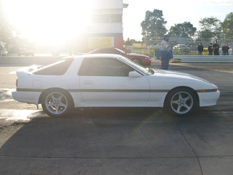

The last real outing I had in my Supra was going to cedar falls raceway for the Iowa Auto Forums annual shoot out. It was a good time, and it is always nice to get out and play around some. I was hoping for some really good times, but the car kept running lean and breaking up so I never even made a decent time. It was a big headache, but I decided there is always next year to do it better.

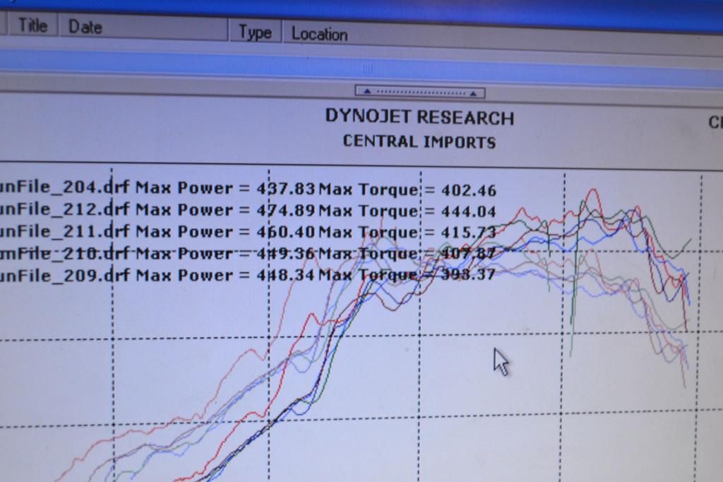

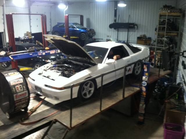

I had to get my car back together in a hurry before the shoot out, and when I did get it together, I jumped on the dyno the thursday before the event(it was on saturday), and we did some tuning. I thought it was going to turn out better than it did, but it just wasn't right. I had no time to take it out and test it before the race weekend, as it was raining. I ended up putting down 475hp which is reasonable, but I think it we could have worked out the bugs and made it smoother it would have been over 500hp.

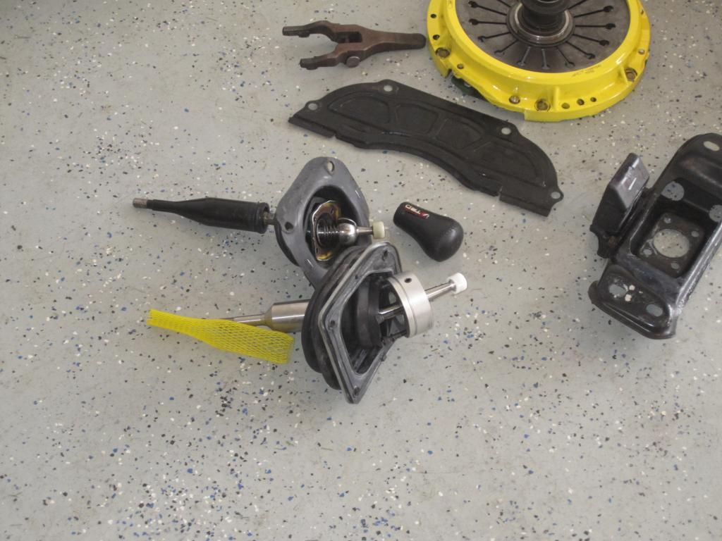

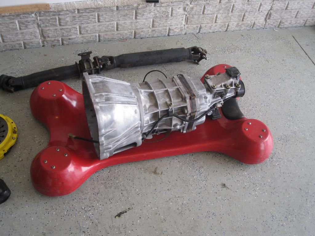

I bought a SSV3 short shifter a couple months ago, and loved it while I was using it. I went out one night to do some datalogging, and apparently one of my flywheel bolt heads sheared off, and it was getting stuck in-between the flywheel and clutch disc so it wouldn't disengage fully. I pulled the transmission out and decided it was time to change things up a bit.

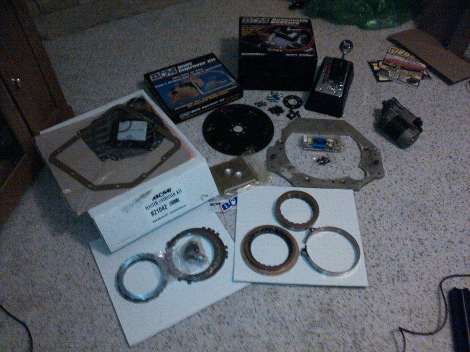

I decided to build this set up more towards drag racing, so I sold my r154, clutch, etc, and I am going with a built th350. I bought a th350 off of a friend for a good price, and went with a b&m upgraded friction material rebuild kit, as well as their shift kit. I bought an ATI adapter set up, and will be using that along with one of their torque converters that I will have to order.

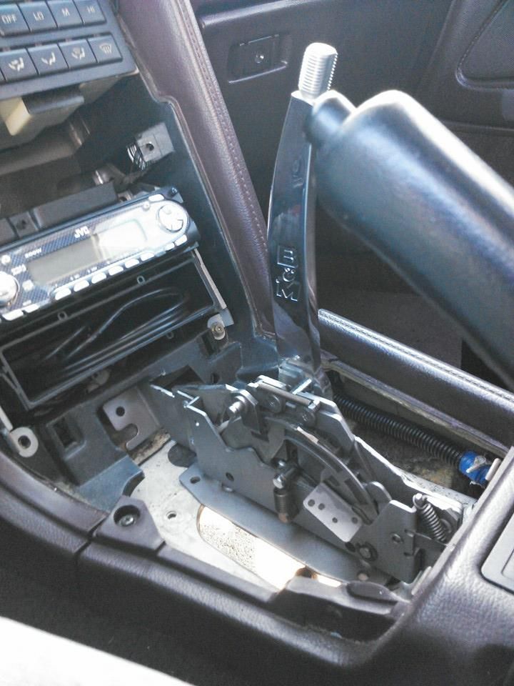

I bought a B&M quick silver shifter, and cut it up so it will fit in the stock location. Still working on modifying it a bit, but it is coming along.

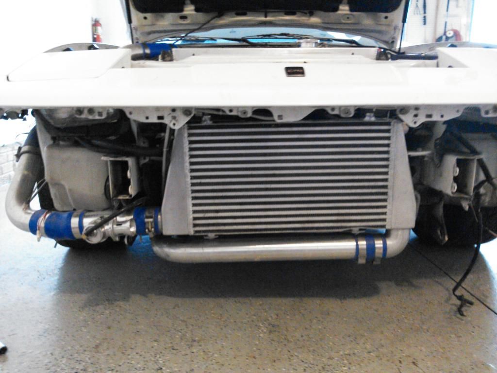

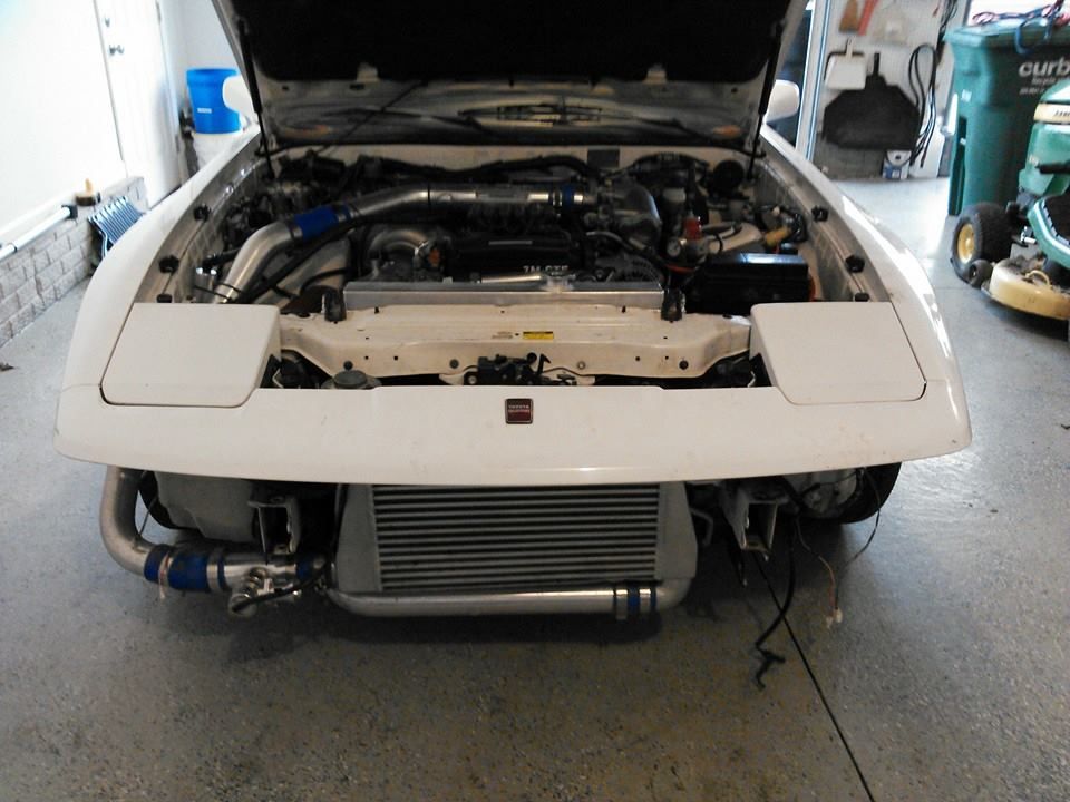

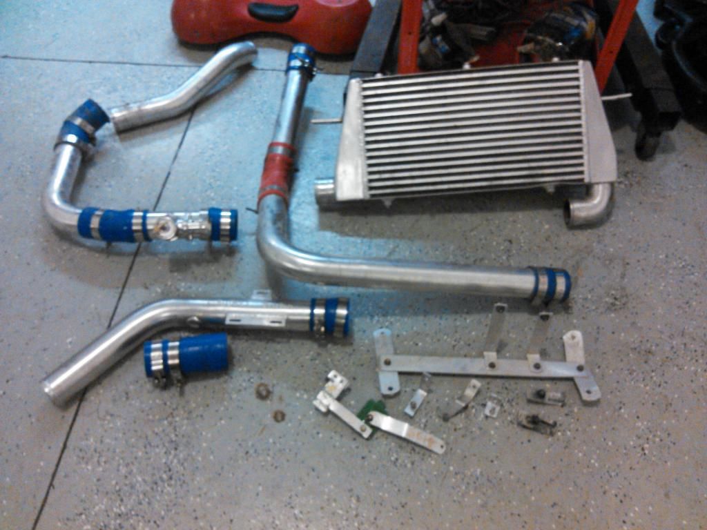

I decided to start on my ffim set up soon, so I had to pull out my old intercooler set up, and I am in the process of trying to get it sold.

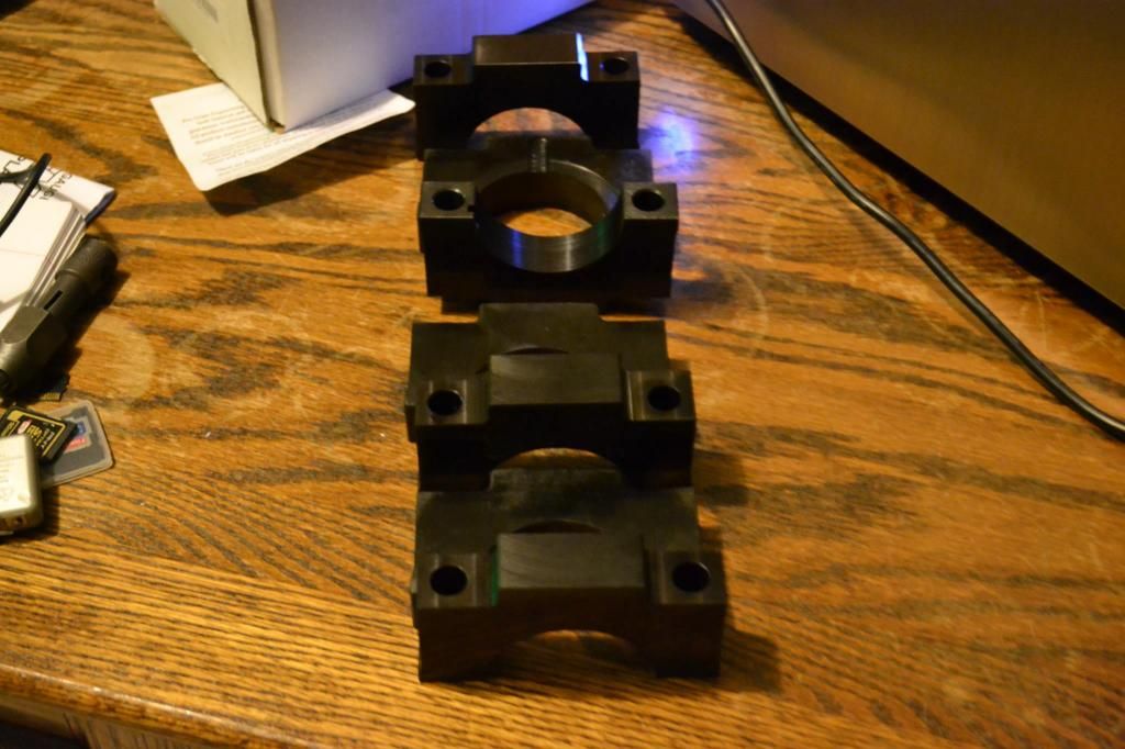

I disassembled my block, and took that in along with all the parts that need balanced or machined into the machine shop to get the work done. I don't have any pictures of this, but I did order some titan billet main caps a while back, and I am going to be using those in this build also. Should have my block back here in a couple few weeks hopefully, and I can get the bottom end assembled and together.

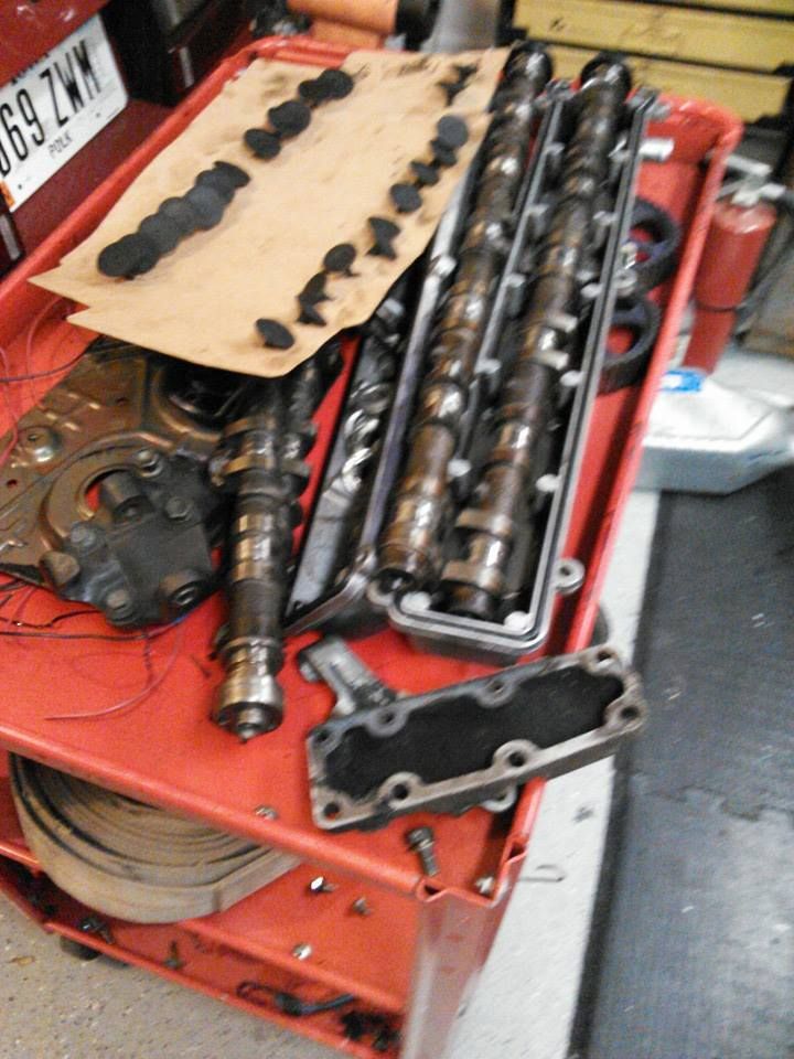

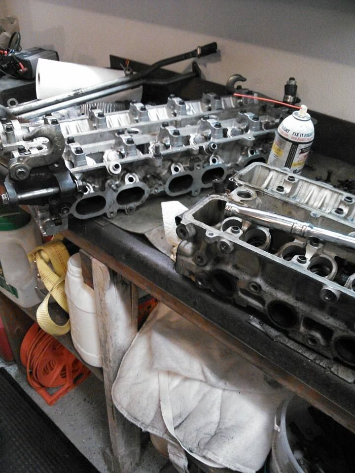

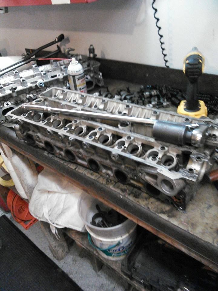

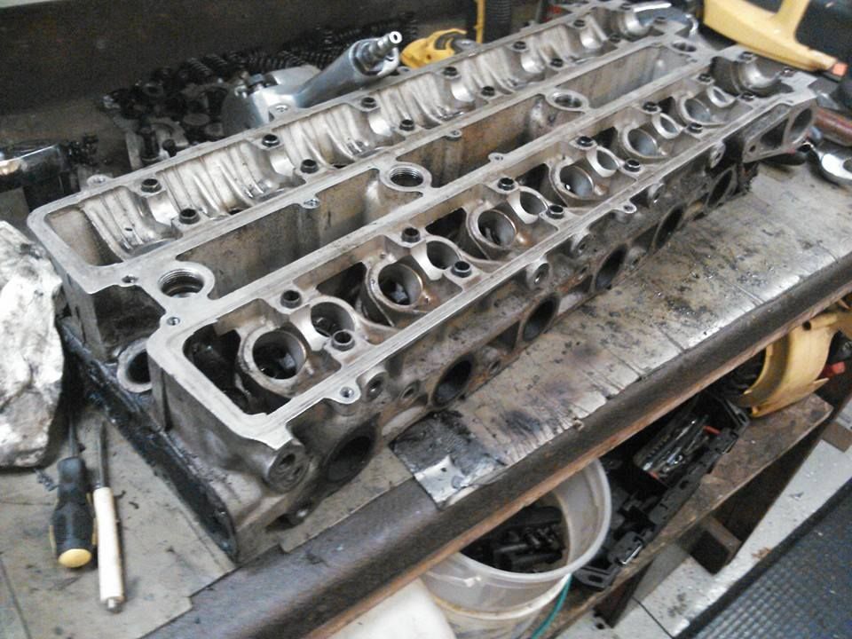

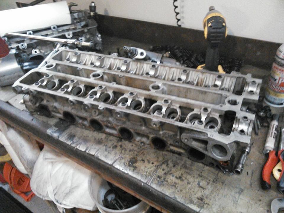

My last update out of this little series here. I just got done in the garage dissassembling my head that I am going to be using in this build. I am going to have a mild port job done on this, also going to have a 3 angle valve job, and have the head milled etc. Just the basic head build with cams.
BTW I bought the Toyo-tool a while back to do my valve stem seals, and it is amazing. it makes easy work of dissembling and reassembling the valve train.

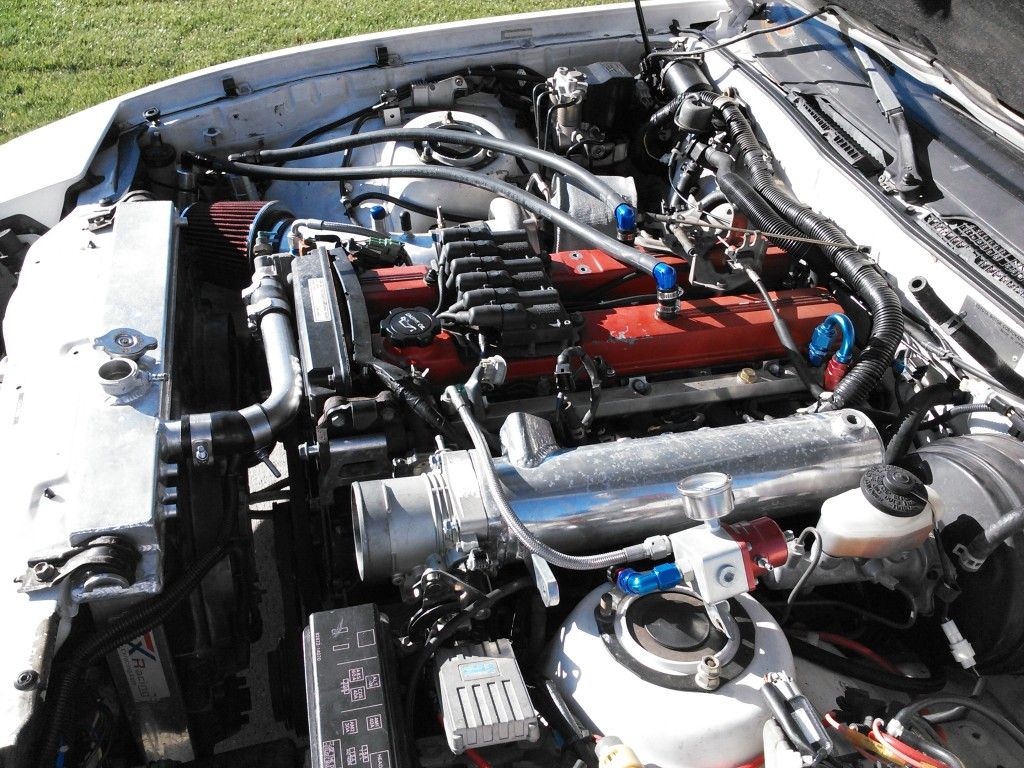

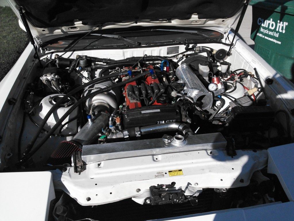

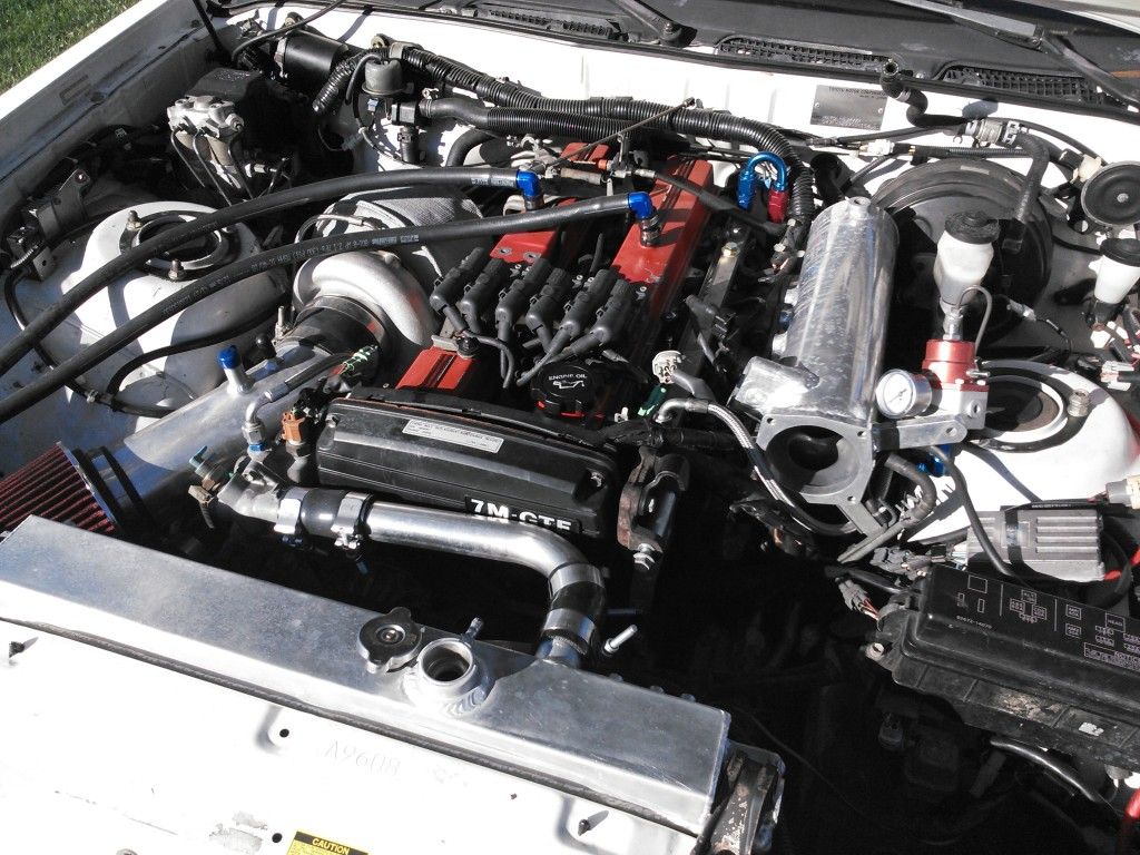

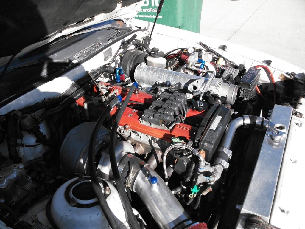

So while I am waiting to get my bottom end back, I am going to be playing around getting my FFIM mocked up and hopfully in. I have to put my new intercooler in, and make pipes for it too. When I do this, I am planning on putting in my new oil cooler and trans cooler set ups, and getting them all hooked up and running right.

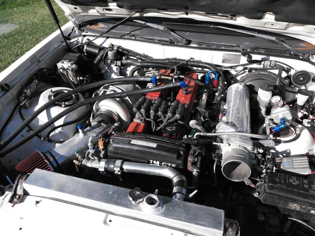

I went out and worked on the car just a little bit yesterday. I pulled off the old intake manifold set up, and pulled off my alternator and mocked up my FFIM to see how it will sit in the bay, and what all I will need to modify.
As far as I can tell, it will be pretty easy IMO.
I need to make a new -6 fuel return line from the rail to the regulator, and also locate the regulator to a different position.
I need to pull off the AC bracket so I can put on my new alternator adjuster.
Wire up my tps
and a few other things I will need to do like redo vacuum lines etc.
