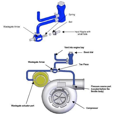

Some no name ebay crap. turns out when i took it apart the ball was on the wrong side of the spring. Anyway i switched it around but with it turned all the down i was still hitting fuel cut in 2 and 3rd until about 5k rpms when the boost would drop off greatly.
So im just going with a EBC still leaning towards the AEM Tru Boost/Greedy Profec B spec 2
Just like the one in the picture set it up this way also
