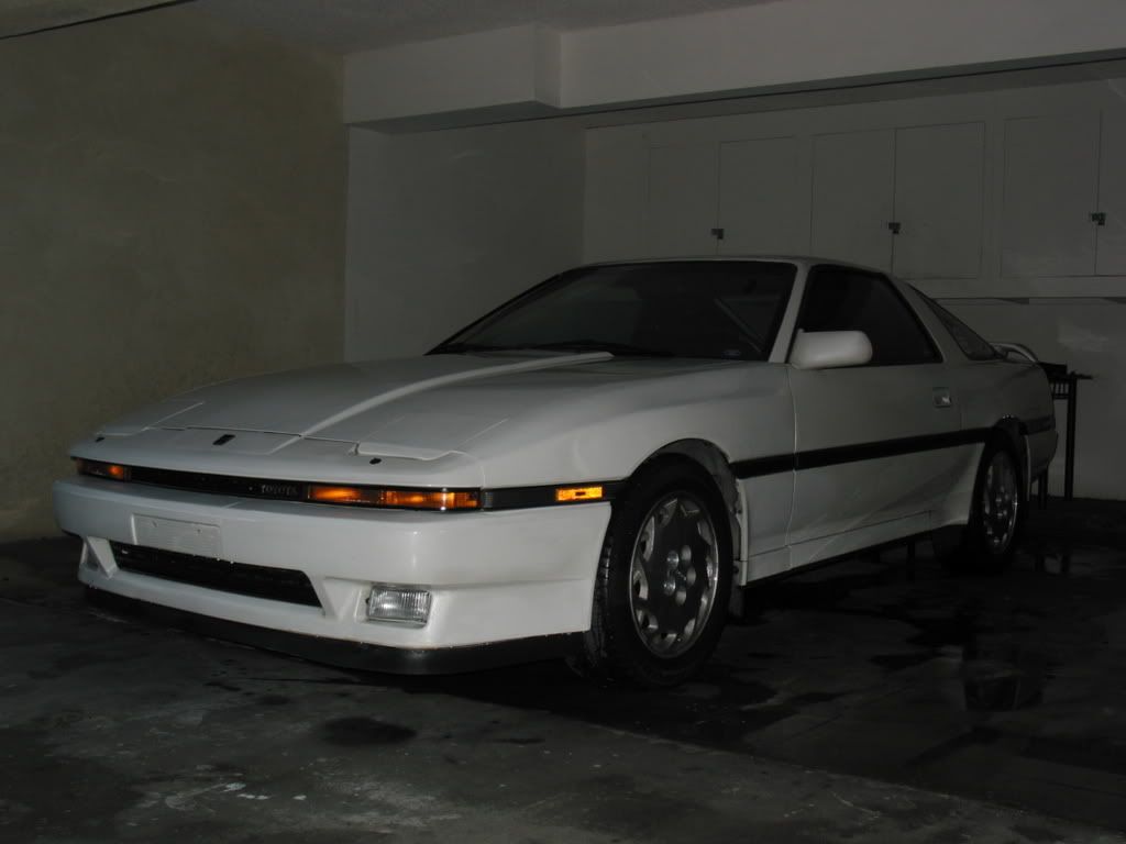

I've posted these pictures a few times before, but here they are again. These are Eibach springs and KYB GR2 shocks.
As a $320 suspension upgrade, the Eibach/KYB setup works very well. It handles well for a 3,500-lb. car, with very little body roll (coupled with ST swaybars). They aren't going to compare with higher priced coilovers, but, in my novice opinion (I'm no autocrosser or road racer), they work well for a street car. Right now, the tires I have are the limiting factor, so I'll have to reserve full judgement until spring.
