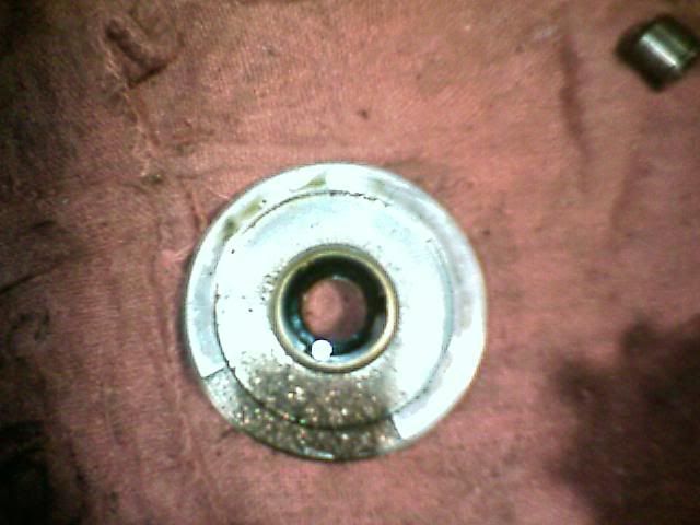

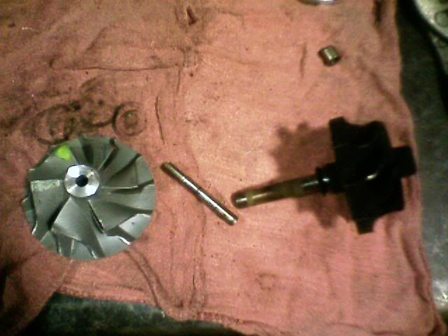

Take note ladies and gents. This is from a 57 trim that arrived a while ago.
This was not the compressor wheel's fault, but I lay blame on the BOV as it appears to have failed to open.
When this happens under load, we get surge. Surge = shaft snaps.
Enjoy the carnage. (Mind you the thrust washer - steel - had actually welded itself to the thrust bearing - brass)

"New product, toyota's new two-piece ct26 shaft! Don't waste time re-balancing your turbo or bothering with alignment, simply slide the two pieces in and get back to wondering why your car cuts out at 17psi on your stock fuel system!"
Good pics. ...that's some serious carnage.
