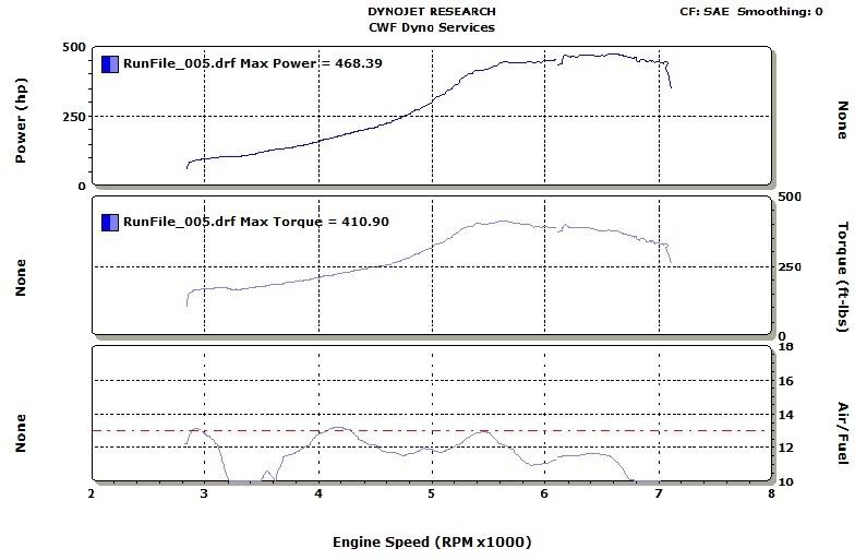

Here is the dyno sheet and you can see the work that needs to be done on the a/f's.

it looks like at that point it only broke up in one spot.
damn shame about the intake. i still think aem needs to add the "danger to manifold" program on there. maybe you could have avoided it.
the car looks good and sounds even better. 16psi is still 13psi away from where that turbo even starts to do something, and then even more room on top of that. cant wait to see it when you get things dialed in.
btw- looks strange seeing a 7m dyno sheet turn past 7k

First run it wouldn't even make it past 5100 rpm and it made 299 rwhp/299 rwtq, second run it made to 5300 rpm and it made 354/354. I started with a map that from what I understand is that Jason S. from AEM came up with for a speed density MKIV running 1000 cc injectors and a GT42 turbo and a 5 bar map. I was going off the principal that a 3 liter is a 3 liter to get me started, plus this is what Dave Henry uses on his Supra and his buddies drag Probe with a 2jz-ge in it. I set fuel pressure back to 43 psi base to simulate what a stock Supra would run and found out that Dave had been running 36 psi as a base so this had added to the amount of corrections I have had to make. This is the first AEM I have ever fooled with and it has been an interesting learning curve, but at least it is on my car. My wideband also died so I have had no way to tune until I got to the dyno.
I have not driven the car on the road with the exception of a couple of passes up and down the road in front of the dyno. I planned on driving it around after I got a base tune just running off the wastegate, but the is hard to do with an 18 inch crack in your intake. I will get it fixed and get things straightened out where I can be back on the dyno soon and then the road.
