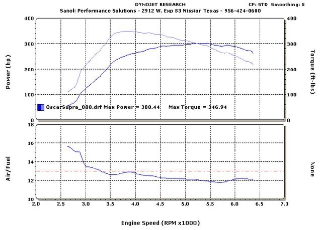

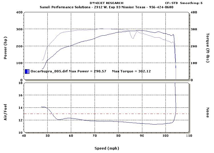

mods;
k&n fipk
becauseican ddp w 3in exhaust no cats
lex afm
walbro
safc2
aeromotive afpr
2.5 hardpipes
spec stage 3 w/ 11lb flywheel
hks evc 4 set at 11psi and 14.7
and some tuning of the safc2
11psi 290rwhp and 302 rwtq
14.7 and it drops to 11psi dont know whats wrong 300rwhp and 347rwtq

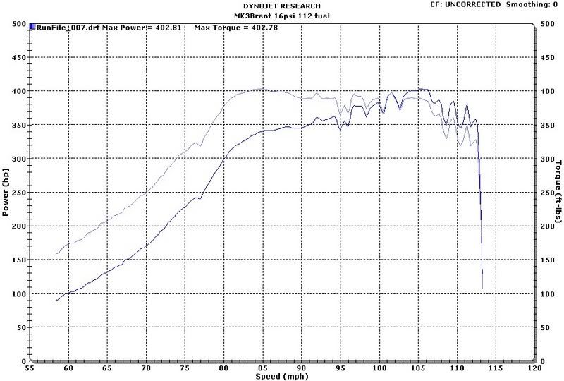

Walbro 255 (FP)
Aero 13195 (AFPR)
RC-550 (injector)
LEX-AFM (SS)
Custom 4"
MP T-66 (P-trim) 16psi
Custom 3" DP and exhaust
LM-1 WB
S-AFCII
HKS EVC IV
HKS replica 50mm WG
Custom spearco bar and plate
Custom IC pipes TiAL 50mm bov
Stock HG
Stock Clutch/PP
To explain the choppiness: I was running a .042 plug gap and was getting severe spark blowout up top. Autolite coppers.

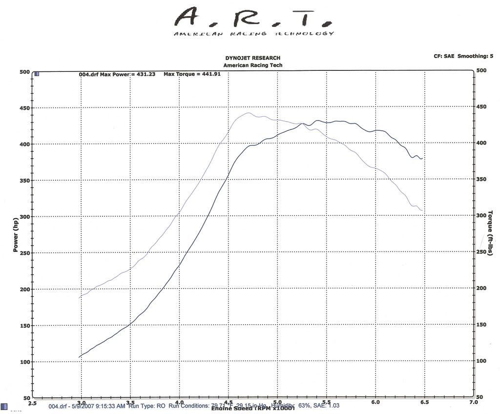

~440hp, ~430tq on 14psi
HKS Long runner cast manifold
HKS External Wastegate
Garrett 57 Trim, Mystery "HKS" turbo
3" Exhaust V-Banded exhaust leading to...
Greddy SP Muffler
"0.020 over JE's
Clevite 77 Bearings
ARP rod bolts
ARP Head Studs
Block/Head machined
HKS MHG
HKS SSQV BOV
Custom Blitz Large FMIC
VPC/AFC Neo/AVC-R
ZT2 Wideband
Walbro 255 Fuel Pump
550cc Injectors
South Bend DXD, Feramic Clutch
285's out back, 235's up front.
blahblahblah...
Obviously the tune wasn't perfect. I still have some large bottlenecks in the charge pipes and the turbo needs a rebuild. I think I can squeeze 500 out of it with ease.

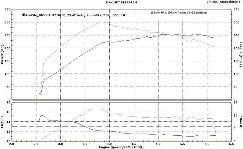

Done today: 254 whp & 300 ft-lbs torque @ about 9.5 psi (boost controller sucks!). Mods listed below the pic.
And here's a link to the video: http://www.youtube.com/watch?v=2HwhgTo2h4g
CT26-57 * 3" MDC Turbo Elbow * 3" MDC Down Pipe * Bosch 110 BPV * Crappy Catback * ARP Head Bolts @ 80 ft-lbs * A'PEXi Power Intake * Lexus AFM * A'PEXi SAFC II * Voodoo III MBC * Autometer Boost Gauge * Blitz Fatt Turbo Timer * 9.5 - 12.5 psi Boost

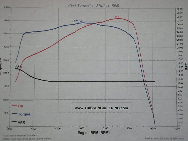

stock Aristo 2jz
MK4 550cc injectors
apexi afc 2
greddy bcc
manual boost controller
ebay manifold
ebay T70 (t3 flange) turbo
ebay downpipe
ebay 4 inch intercooler
18psi with 11 a/f
