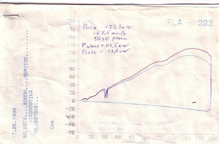

I just looked up that same formula online, but I don't think that formula factors in drivetrain loss.
Torque is measured and the horsepower is calculated with that forumla by the machine.
If you lay down 250 lb/ft at 5200 rpm, the horsepower must be the same.
Get that dyno up and full mod list. The numbers are very good.

Yeah as I originally said and as Nick just said, if you are making 253tq @5200 then you have to be making 250 hp @ 5200.
The equation works regard less of where you are measuring the tq from (wheels, or flywheel). there is no way to physically measure HP all that can be measured is TQ then HP is calculated from that.
Regardless of what you are testing, TQ and HP will always be the same at 5252 RPM's so at 5200 RPM's they will be very close as I have pointed.
The other thing is that if you are making 236 hp at 5400 RPM, then you would be making 229.5 tq at the same 5400 RPM. So thats about a 24 ft/lb loss for only 200 rpm differance and yeah it is possible, but having ported head and 3" exhaust that motor should really be starting to come alive in the 5000 to 6000 rpm range not falling on its face even with stock cams.
I wish that was true, my motor flatlines the power curve between about 4800 and 5500rpm and then just falls away. Stock cams :greddy:
Look at the rate the torque is dropping away on mine in high rpm.

That isn't dropping away. Plunging like a Jimmy Carter stock market is what he was refering too. Like a 5.0 Mustang engine.
That torque curve looks really good infact.
