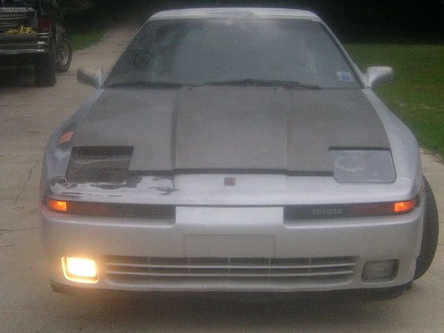

Quick history lesson...car started off as a auto/na and looked like this. Now this pic shows the very beginning of the sanding, yes the headlight was missing, yes that was the hood it had, and you can see a beautifully smashed quarter panel pass side with a ton of bondo!

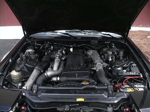

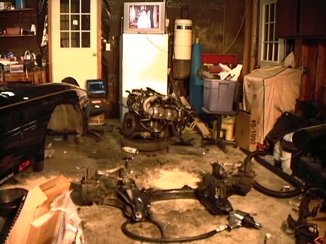

4 years ago as of next week...the 1JZ! Also somewhere between that and the 1JZ I picked up some 5 spokes off a 92.
Yup, I have a 89 but I am one of those really lucky people to have an early 89. See crossmember on floor!

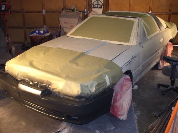

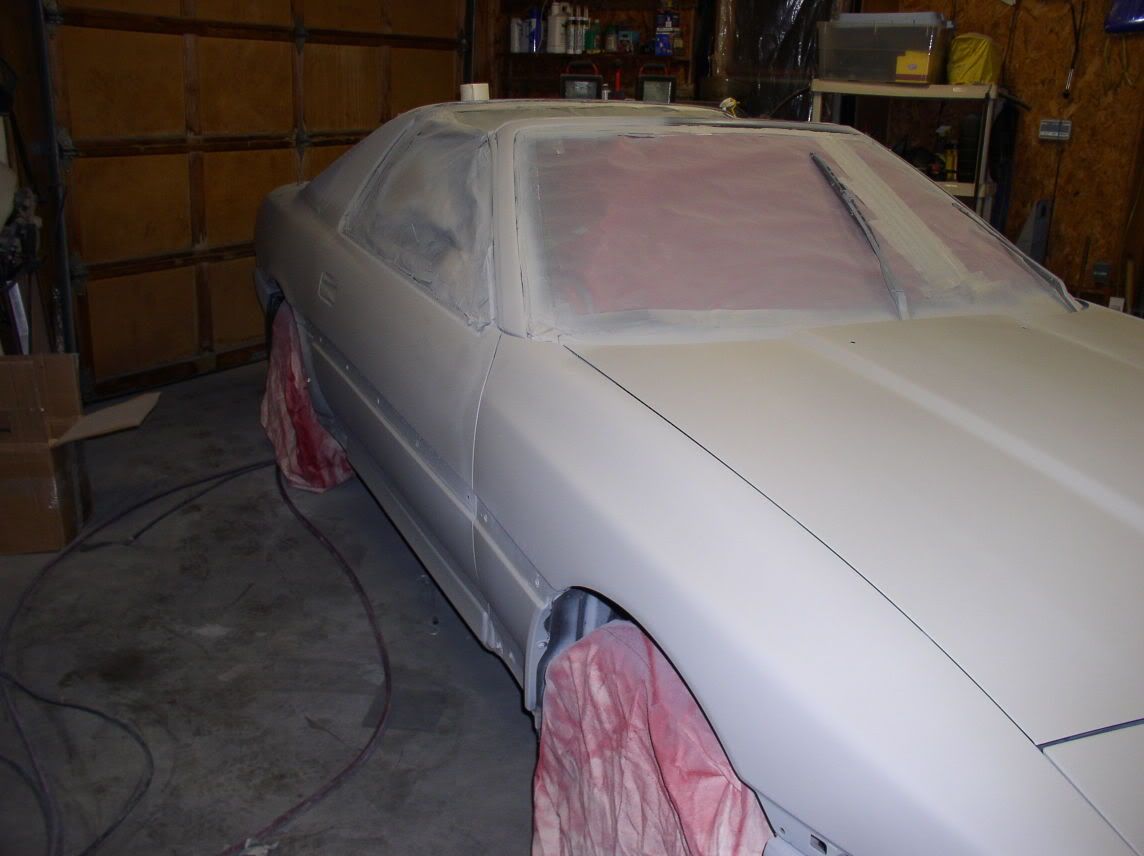

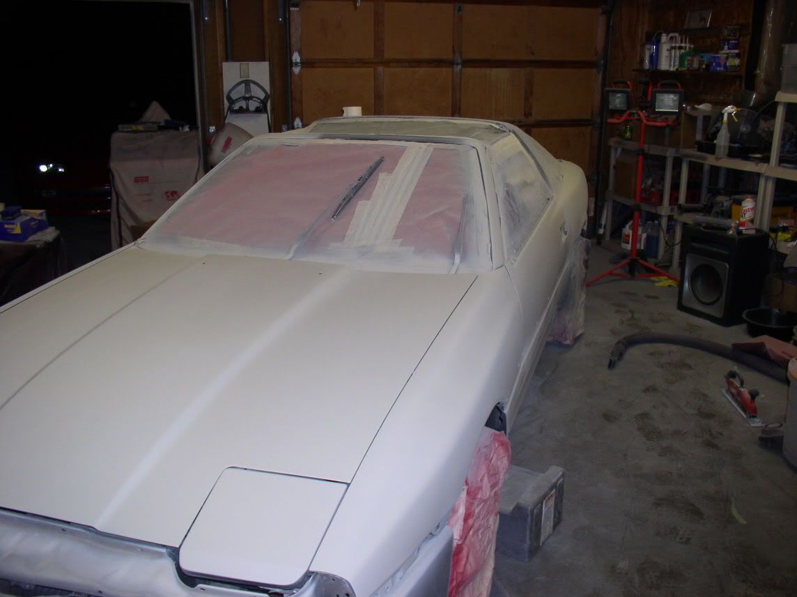

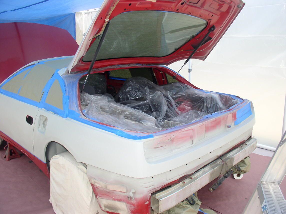

About a year after that the car got punished by some very nasty hail. So did my fathers 300ZX. We decided to do the paint ourselves so we could buy new leather interior for both cars with what would normally be the labor part of the check! Here is a few shots of the Supra right after we did some priming.

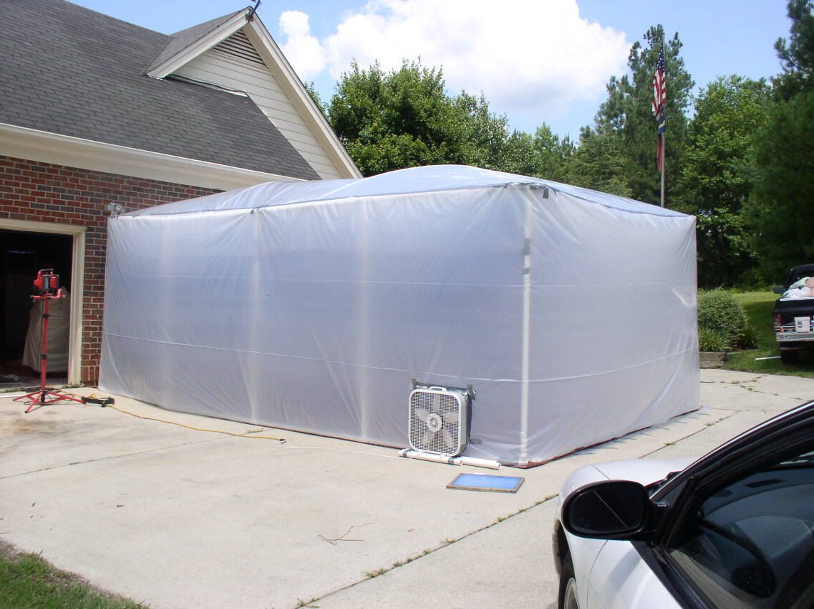

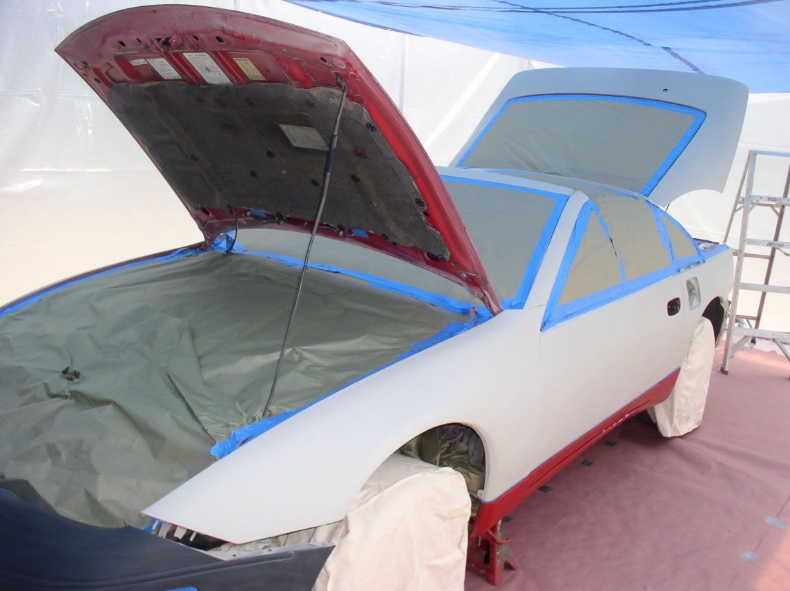

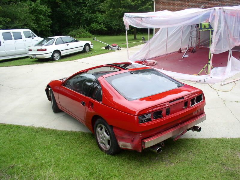

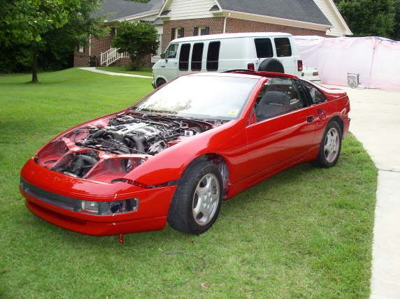

Oh, the Z too. This was the first car to be done. We did it in a paintbooth made of PVC pipes, plastic, and duct tape. Worked great but collapsed the next morning...
Finished primer in said booth.

The booth itself. We had three fans. Two were blowing into a house's air filter, and one sucking out. This kept it pressurized helping it keep its shape and also reduced greatly the amount of dust particles we would later have to sand even.

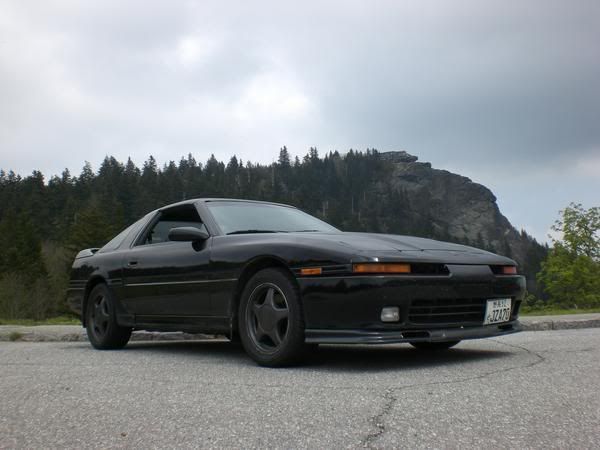

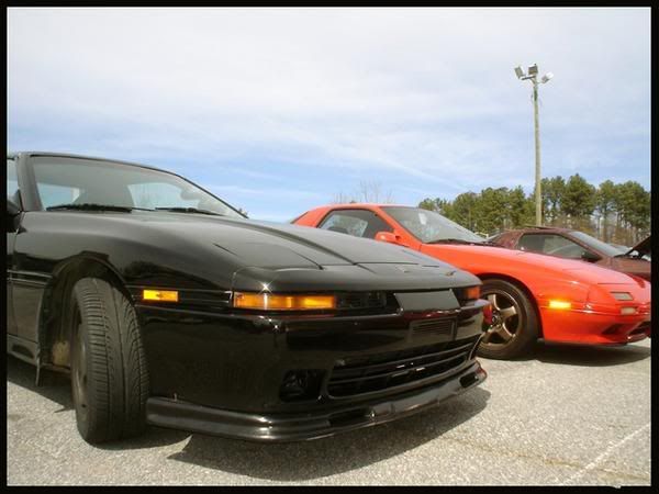

Now some of the Supra's more recent pics after all said and done.

Wow, til that last picture, I was gonna ask how you turned the 300 into an FD!

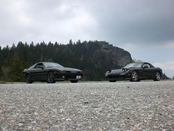

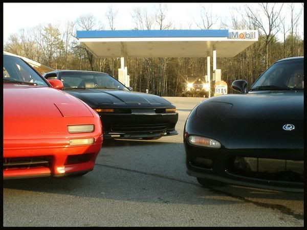

Lol, well actually the Z hasn't made it out to Asheville yet. Those last couple pics were taken at a RX7 meet that my friend that owns the black FD wanted me to come out to.

Thanks! Unfortunately we are going to be painting the Supra AGAIN. Sisters psychotic ex boyfriend keyed the living crap out of the drivers side quarter panel. Deep enough to go to bare metal through 2 coats of primer, 3 coats of base, and 4 coats of clear. So yeah, booth 2.0 will not rely on PVC glue and duct tape for structural rigidity!

Tons, Dad had painted before but not with urathane based paint so there was a bit of learning on that end as far as mixture and adjusting the gun right. We also put down about 4 coats of primer and then block sanded the cars bumper to bumper 3 times. Also in between block sanding passes we used a "guide coat". you just take a cheap can of krylon and DUST the surface. Your low spots will remain spotted with krylon. Then re dust the car and do it again, eventually there won't be any spots that with hold the original dusting coat.
