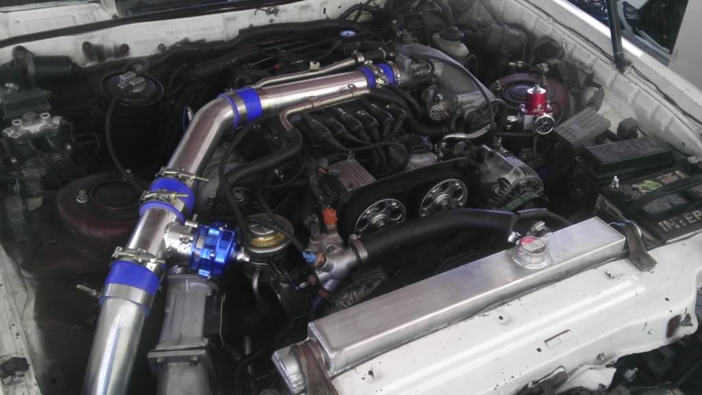

This is the location for the bracket that it comes with. Although I do not have a FFIM
rasmussenbc
Oct 16, 2008
Gig Harbor, WA
yeah that looks nice, but the FFIM is the problem. I'm worried it wont clear on the strut tower. It's a pretty tight fit there. thanks for the pic
