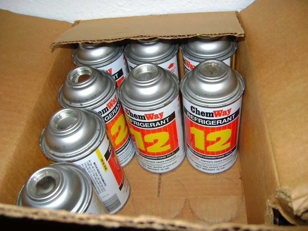

You can still buy it just get your EPA 609

You just need to r134a fittings and then to flush the system.
After that can run r134a instead if r12. R12 works better but harder to find.
