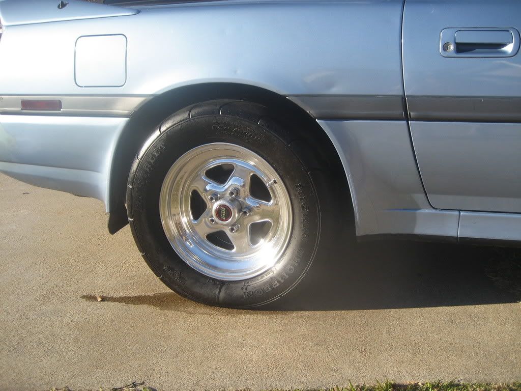

Wheels: Weld Prostars, 15x8 5.5" back space
Tires: MT ET Street Radials, 275/50/15
Suspension: Bilstein Shocks, Stock springs
Issues: as you can see I have about 2" of fender gap, but with the size I got it is really wide, and I had to roll the fender lip because when I launched it would rub on the tire. Now if I would've got the 275/60/15, they would've fit and not have to roll the fenders even though the tires are taller, they are not as wide. I've seen them side by side with mine!
