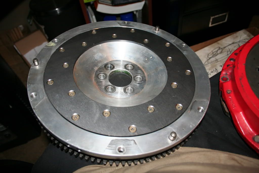

well i droped the crank and rod's off at the machine shop
i'll be taking the flywheel intomorrow after class. i need to replace the fristion disk before it's balenced

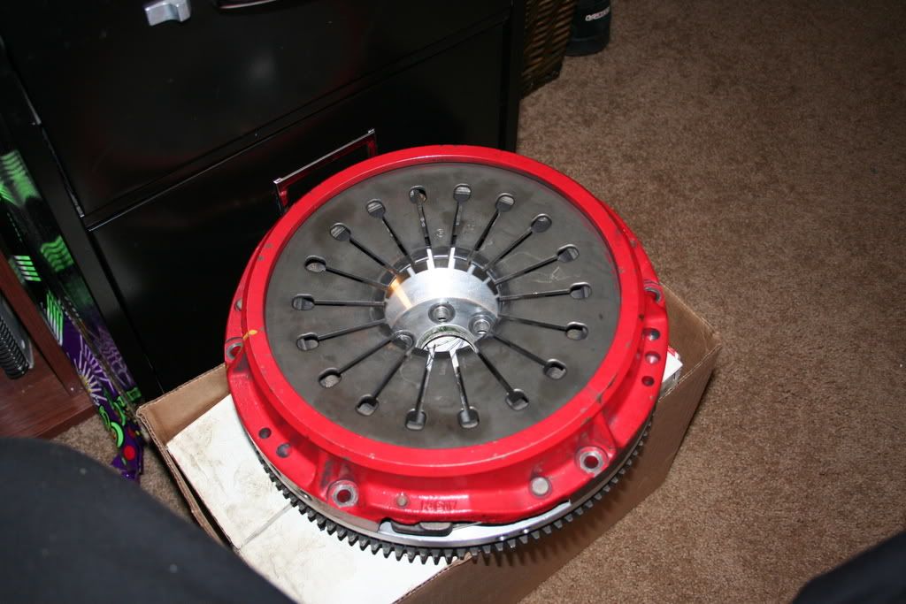

the clutch set up im going to install, any one have an idea what pressure plate this might be? and lbs rating?
i do know it's stiffer then the stock clutch i put back inot my brother's car..

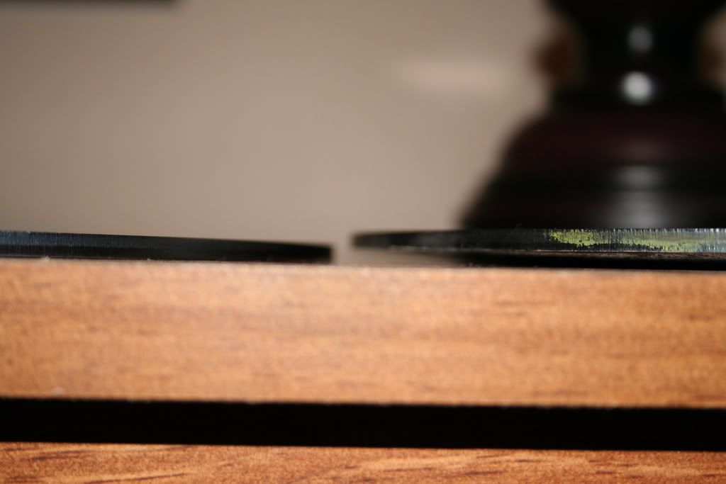

new frictions came in the mail, should help stop the chatter~!
old one.. next to new one..

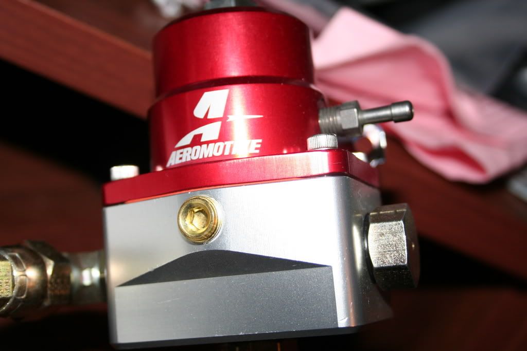

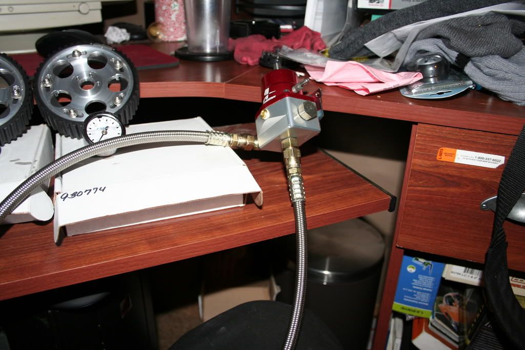

also afpr kit,

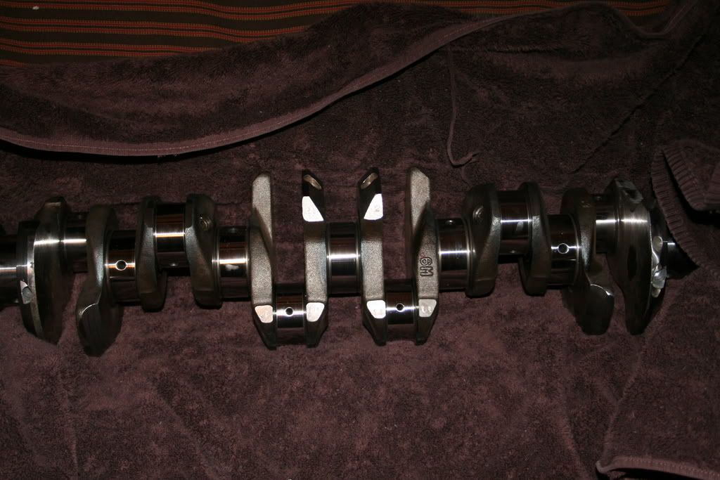

the crank made it back aswell,

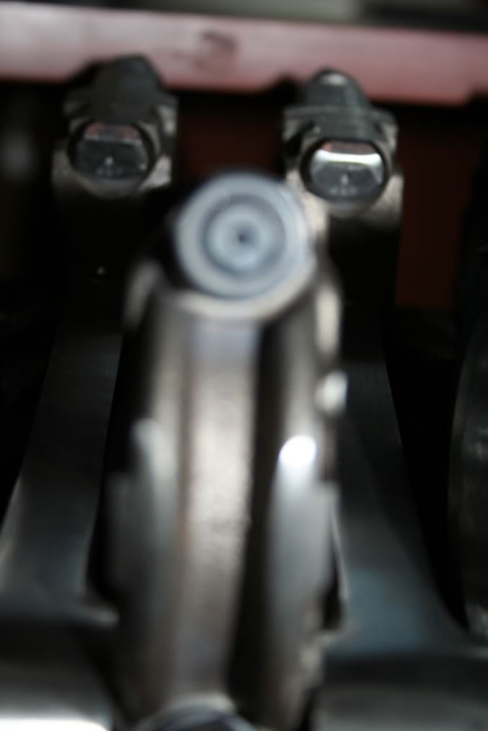

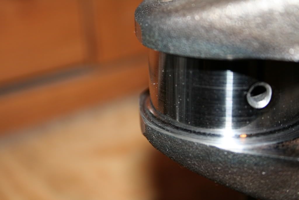

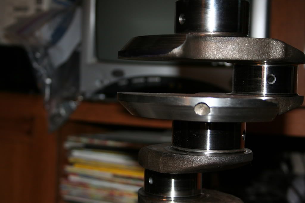

dan removed 1.25 lbs, rebalenced the entire engine assembly, cleaned the crank oil jurnals, he put the crank on the leth to remove the weight, which made the crank round, so it roll's on the wood floow rather well now. and off tables if your not careful
i also asked him to knife edge the crank if needed to remove the weight.
im over all pretty satified with it and cant wait to get the motor running again!

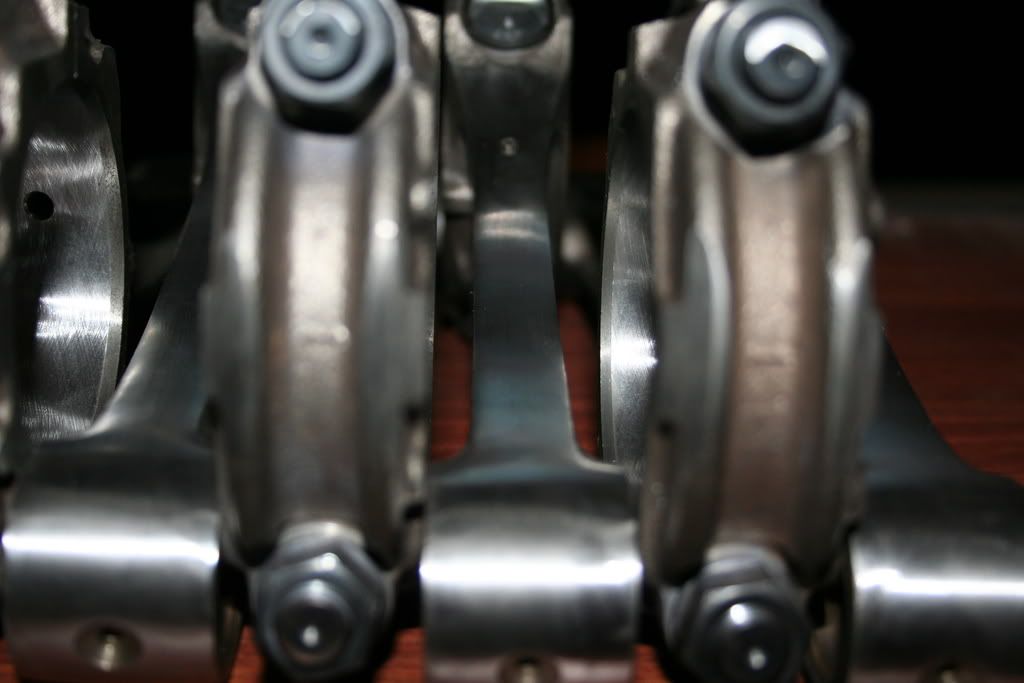

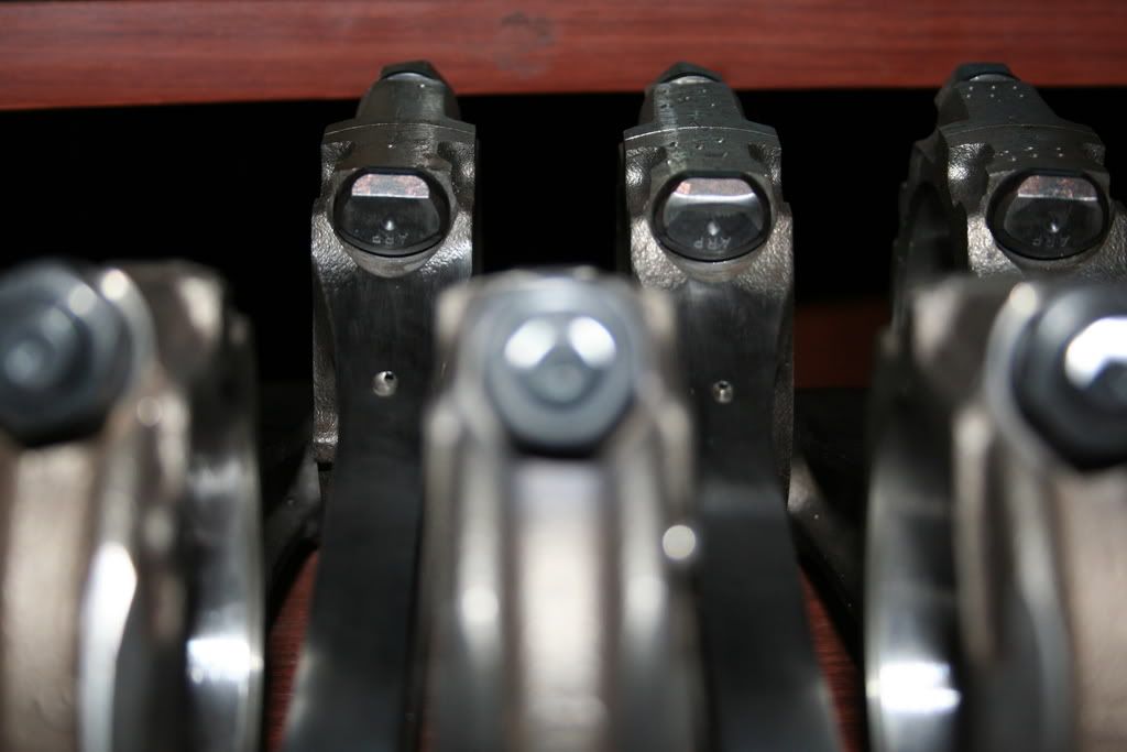

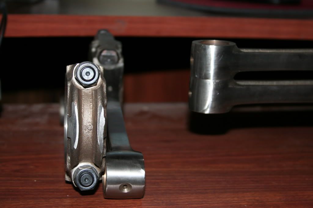

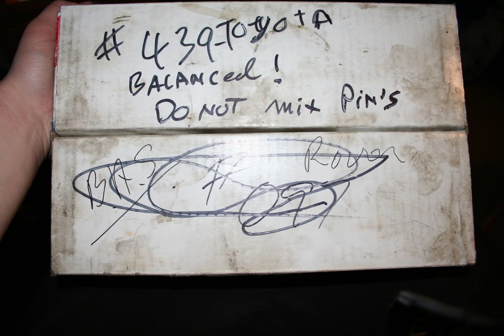

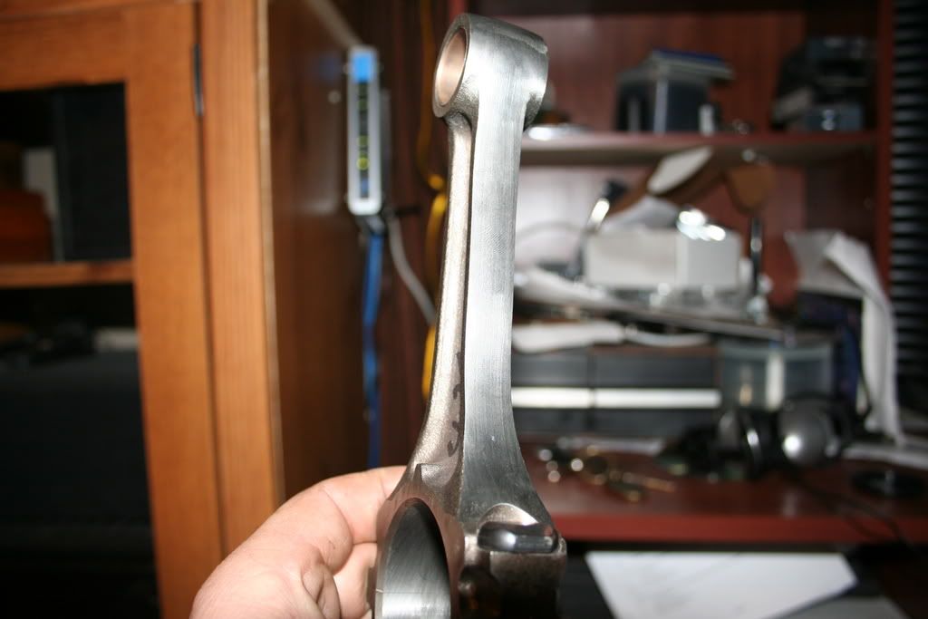

the rod's i had re-sized, destressed and beam polished, and rebalenced,
actualy, this is the second time the motor has been balenced by 2 different shops, i feel the second time was by a better shop, here are some pictures..

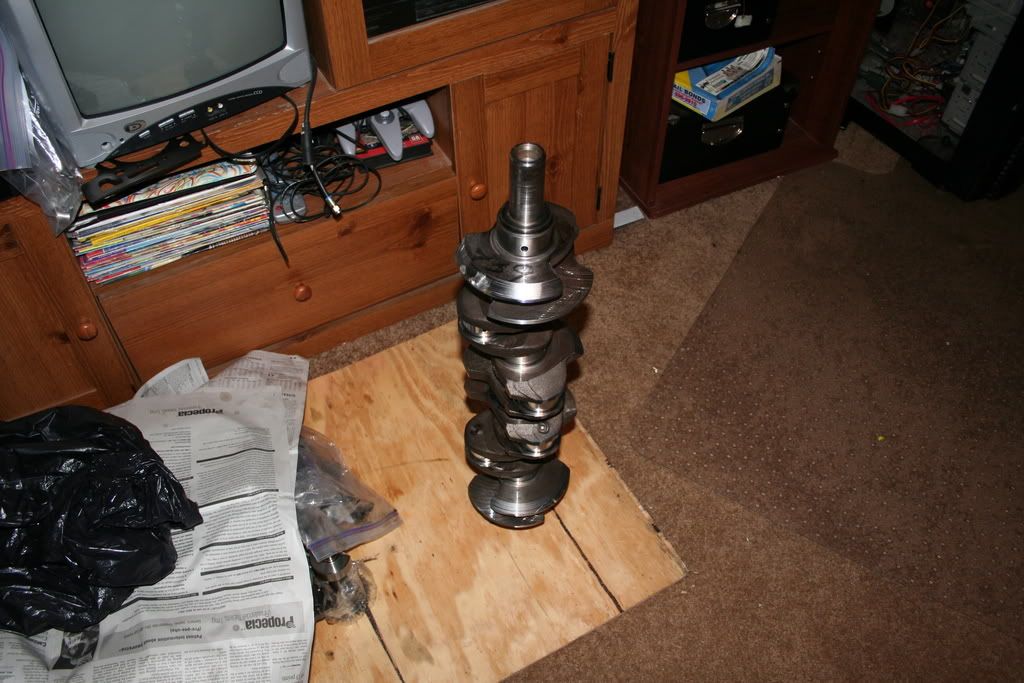

Since Jim hasnt updated because he's busy like a mad man. I felt the need!
About an hour ago he got the crank into the block and got the mains tightened up and torqued to spec. Now he is currently downstairs in the kitchen assembling the rods and pistons. He hopes to have the pistons in and the pan on by 4 o clock when he goes to work at 5 I believe. Hopefully we get his motor in the car by Monday..

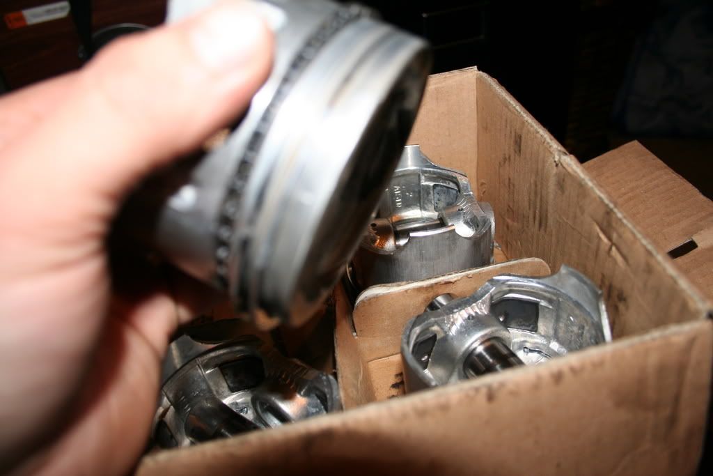

around 2 or so i was finished with the crank, and had started heating the pistons and freezing the lubed pins, for assembly.
realized i didn't know where my ring compressor was so ran out to the part store with joe, work calls, and wanted me in, i agreed to come in an hour earily, and when i went it they were dead..
well being i wanted more done, when i got off work at 9:30, i came home and installed all the pistons and torqued them over 3 passes, 10-25-47 , and the mains where 10-30-52-75

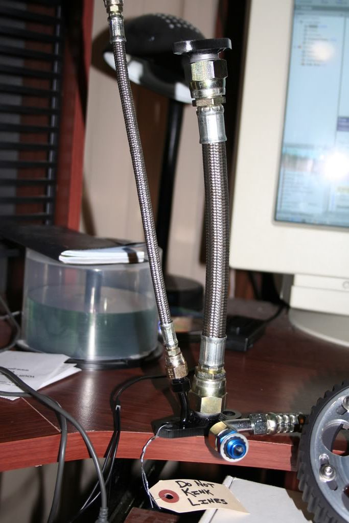

- new ss oil lines for turbo,

i do noticed i think the afpr is making alot of noise, i dont under stand that but im pretty sure it's makng some sort of squeeking sound..
i raist my fuel pressure to about 40psi at idle with hose off i belive, while cruising the fuel pressure drops to around 35ish, and then boost i suspose it goes up?
i did notice i had the fp set at 33ish and when it started sucking vac real haqrd during cruise it droped fp to 25ish and my car would run like crap, also noticed the wb go to 3 volts, a bit on the lean side for me,
