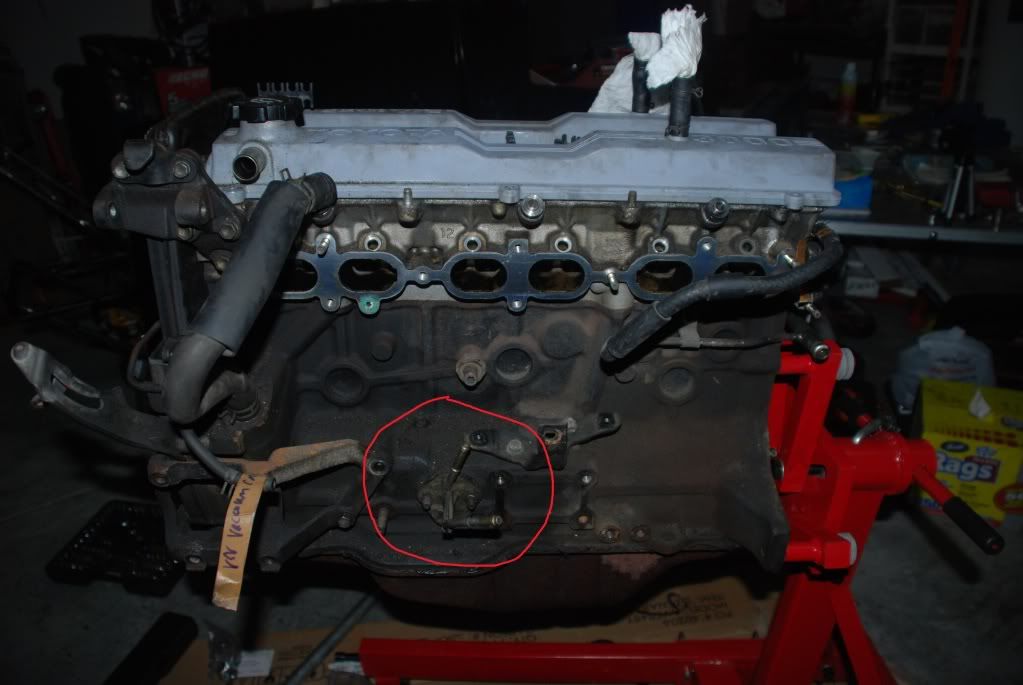

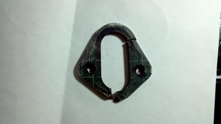

I broke this piece on my block. gotta find a replacement. anyone know where to get it? I cant find it on the tsrm diagrams-it just shows it attached to the block when all it is is a piece of plastic.
It's here on the block:
if anyone can point me to a part number or anything I'd be grateful!

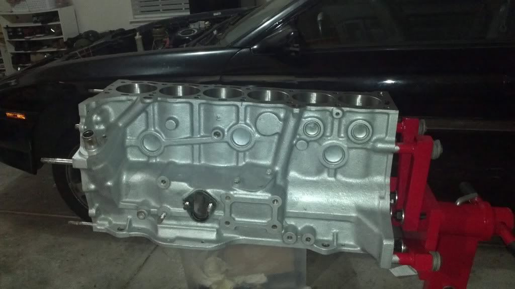

Also, if its possible for me to just reattach the hard section of the fuel line that seals to the side of the block there without the plastic piece, let me know if ya think so!
looks like this when sealed:

ahhh >.< thanks a bunch poodles! gotta get better at navigating that site lol. Problem solved, now just to get it from Toyota.
---------- Post added at 07:16 PM ---------- Previous post was at 07:15 PM ----------
bypass it you say huh? I was reading about that...alright, Toyota would want like 20 bucks for it anyway haha. Thanks IJ, I'll probably do that-easier.
Backlash2032
Sep 20, 2010
1,823
Nebraska
If you plan on going with a high flow pump you may as well block it off now. 15 bucks now and 20 bucks later for the block off plate or 20 bucks now.
Hell, you could make your own block off plate..

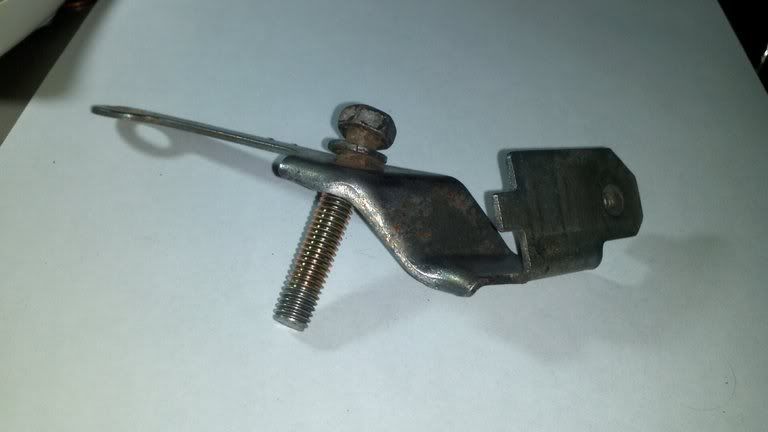

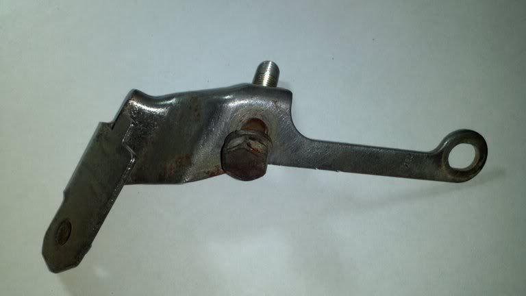

i've got another part to identify and place
It's this bracket here:
for the life of me, I CANNOT figure out where it goes....:nono:
I have searched and searched the tsrm for a similar looking bracket in a diagram-no luck, and cant find any info on the interwebz/the site either.
if any one has info, I'd be eternally grateful, as I would REALLY like to drop my engine in tomorrow! :D
