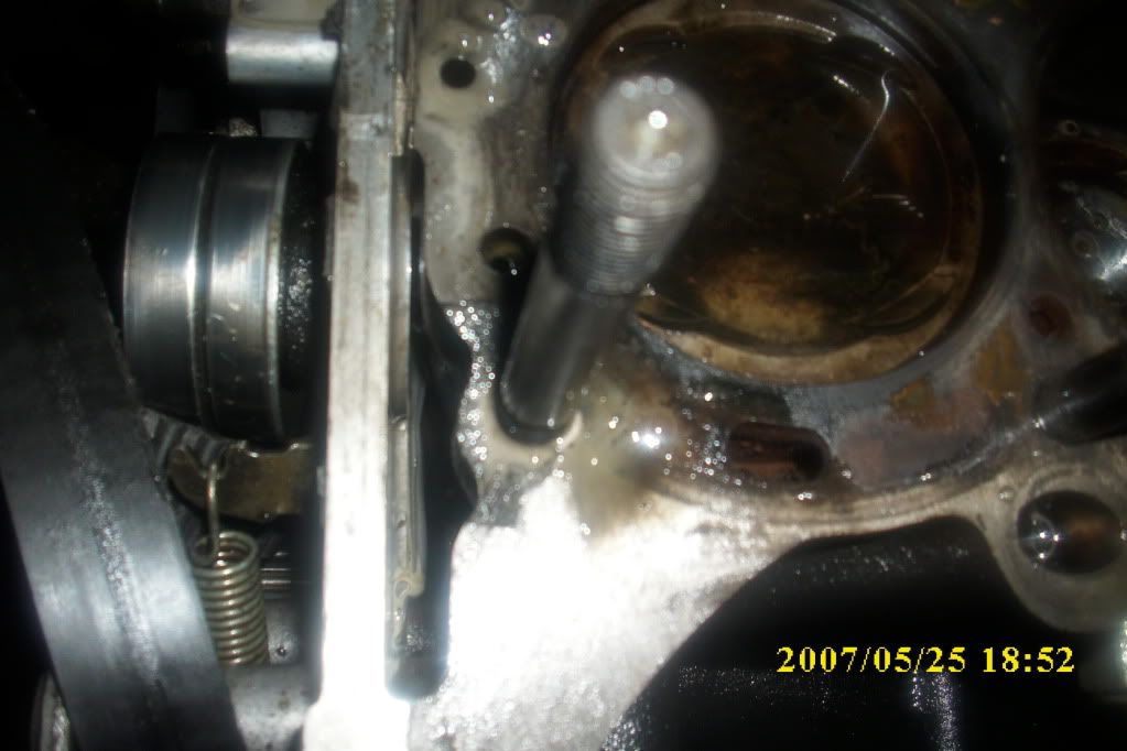

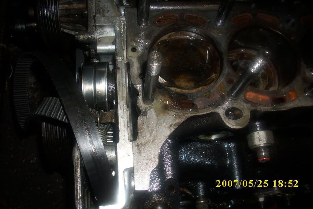

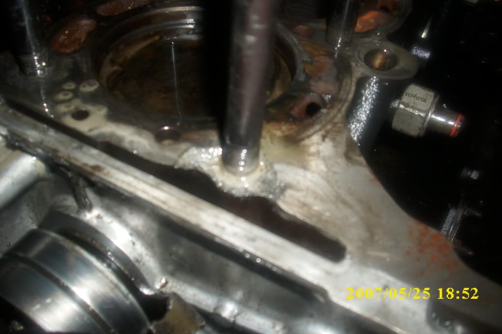

:3d_frown:Check this out guys and tell me if i need a to just get another block. I had a small accident after i got my block decked. I went ahead with the build hoping that it wouldnt mess up anything everything was cool with 7psi then i went to 13.5 and thats when i got the bhg milk and smoke I'm going to try and post a link too my photobucket tell me what you guys think i hope I do this right my first time doing a link.

If you mean what looks to be a chunk of the casting missing around the first stud on the intake side,
Yup, that block is pretty much history.

check out that chunk!! looks bad man, get a new block

:3d_frown: I had just had it decked and put all my internals back in it was i wanted to take it off the engine hoist and put the studs and all of that other good stuff in it I screwed too stock head bolts into the block so i could get the chain in it too left it up and move it. I thought i screwed them in there pretty good i jacked it up and moved it to the shead where my car was then I was called away for something I left it still jacked up and came back in about ten minutes just to see the block laying on the floor with a chuck messing in the front and the back. :3d_frown: I still went ahead with the build I had my fingers crossed the whole time it was cool for 7psi 13.5 did it too me sucks too be me. I have two na bocks laying around you guys think i should switch the internals and have that blocked decked i doubt i find a turbo block down here for a cheap price.

A good machine shop can weld that up easy and drill/tap for the stud. You'll have to pull the motor though and disassemble it. I've had much worse blocks repaired before.
