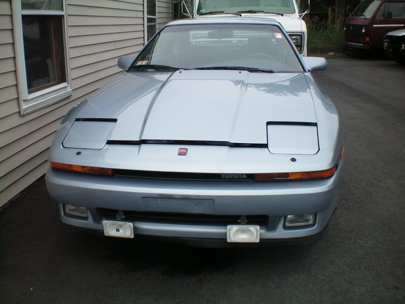

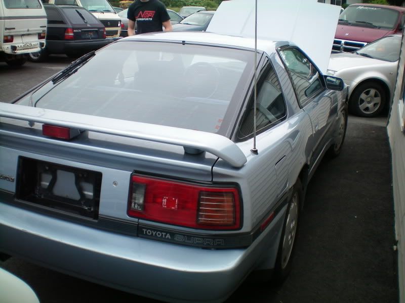

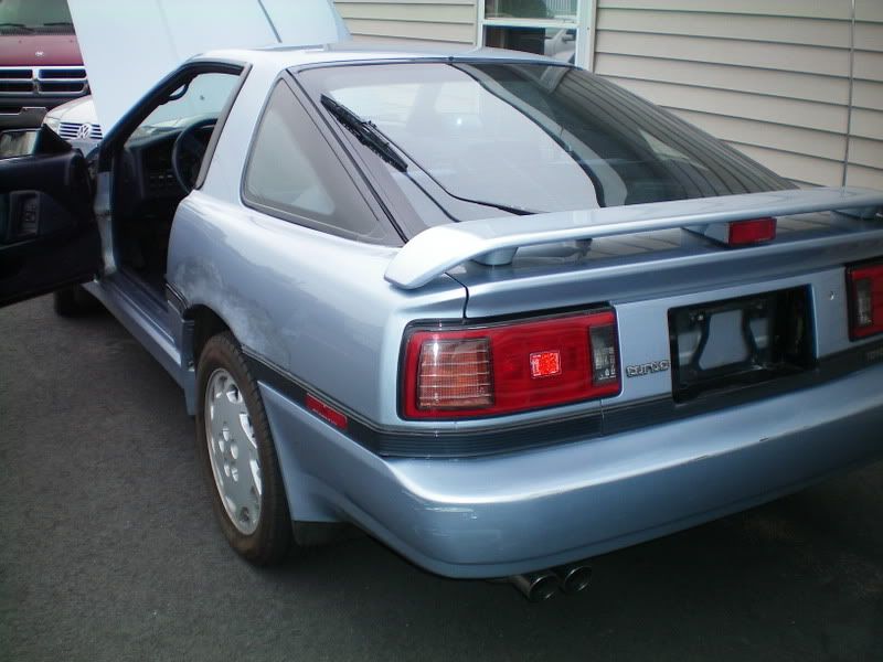

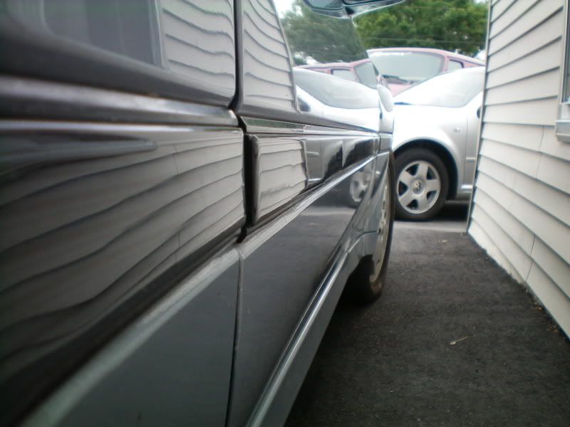

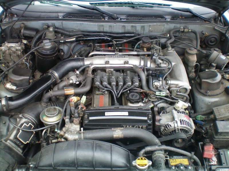

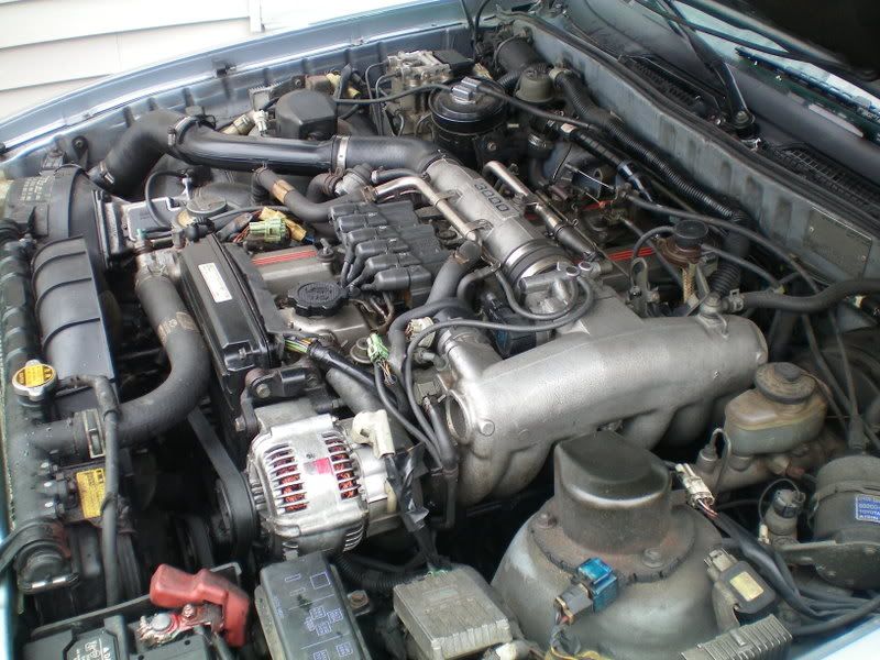

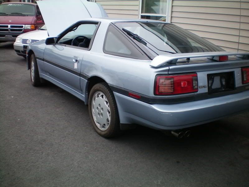

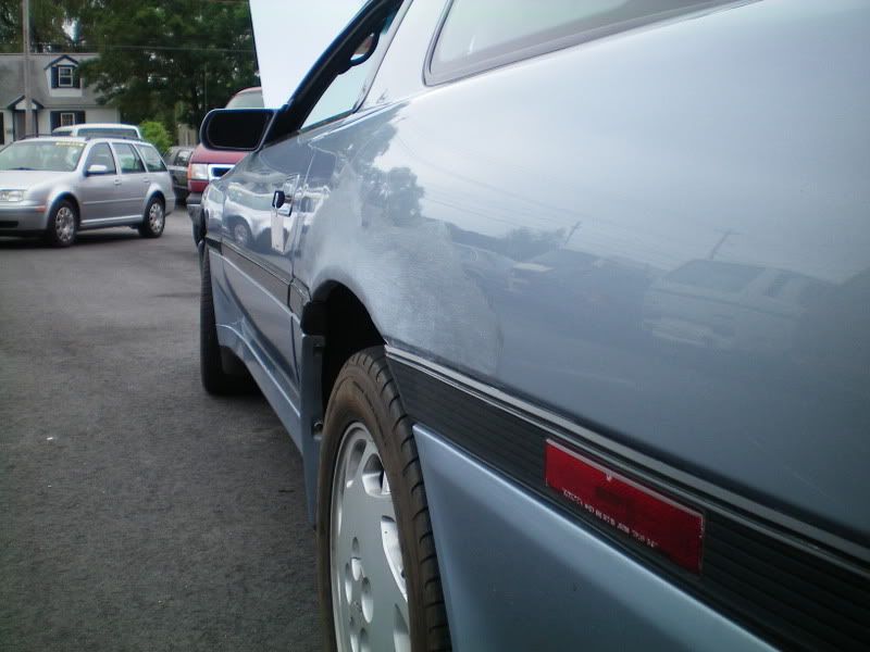

Okay so i finally found another supra. I bought it today for $1500. Its an 87' Turbo 5spd Hardtop. The color is Ice blue. It runs but there is a crack in the radiator. And there also is a ticking noise that is coming from the head. Its kinda worrying me. But not worrying me as much as the rot. Yea there is some rot in the wheel wells.. from looking at the car from the outside it looks really clean. It has 145k. 1 owner and it wasnt molested. Here are the pics.
Reason why im starting this thread is because im not sure what the ticking could be. And if its worth keeping from the rot. I really want to keep it. I like it a lot. Well let me know what you guys think. Thanks
Oh and those fogs are gone now, i took them off. I know they are hideous.

Put the JDM Tyte fogs back on YO!

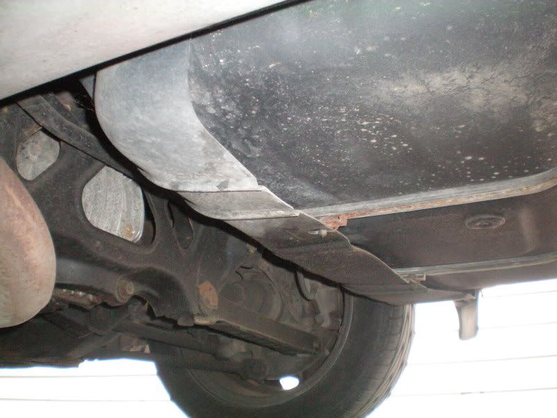

Ya, that is some pretty ugly rot in that drivers quarter. That doesn't scare me near as much as the fresh looking paint all over the rest of the car. It looks pretty good tho. I'd just be scared of how much more rot will come through what could be a cheap hiding paint job.
What does the head ticking sound like? Our cars do have heads that tick a bit. Maybe a video clip would help.

I would not have bought a body in that bad of shape. Looks like the left rear wheel well and an area on the right door under the moulding. Maybe it isnt as bad as it looks. My expirience tells me it is bad however. The ticking could be valve adjustment.

I don't see where the rust is all that bad. To me the car looks pretty damn good. My car ticks a little too but it's normal. Let's see some interior pics and some better pics of this "rot".
The worst is where the paint is discolored and bubbling above the driver side rear wheel. If it is that visible, then it is usually really bad on the underside.

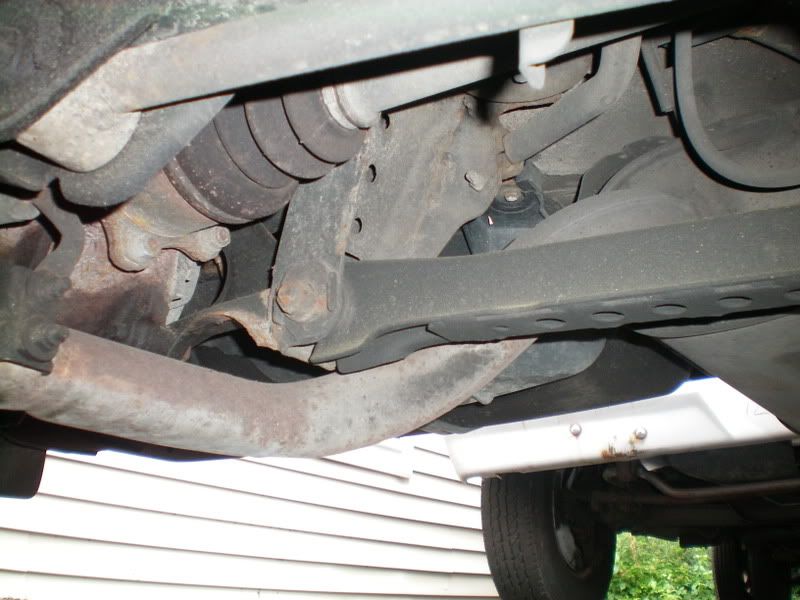

I don't see any bubbling. I see the discoloration but it looks as if it's been sanded on. The undercarriage actually looks pretty good.

Looks more like the clear coat is coming off the driver's side quarter panel, or someone did a poor job of painting over body work. I'd be more concerned with rust at the top of the inner fender well, around where the strut mount bolts to the body, over the top of the tire.

for the price I would say its a keeper. If the rust is really bad the section will need to be cut out and a replacement from a donor will need to be welded in. That sounds scary but its really not that bad at all. Look in the build section at some of the resurrections that have been performed lately. Some wheel well rot is minor. Whats more important is the underside looks pretty good. Ive seen far worse undersides on cars with no visible rust.
7M's tend to tick up top. Generally it isnt a sign of impending doom rather a sign of typical wear and loose lifter tolerances. You can check the clearences per TSRM and see if some re-shimming is needed. Either way you might want to pull the cam covers and take a look.
