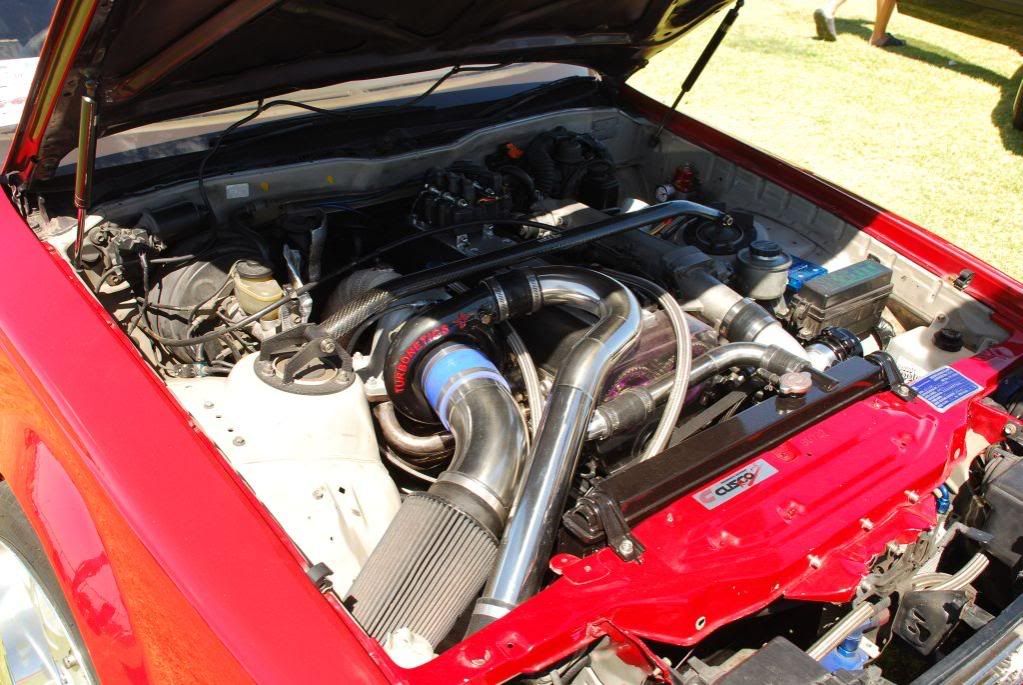

heres the motor as it sits...so happy with the cams and no backing plate look. just need to make up some aluminium hard pipes for the radiator and mount the fuel pressure reg somewhere closer to the motor as i hate it on the strut tower.
cant wait to fill up all the holes in bay and give it a respray!!

Be careful, have a real close look at your top rad mounts. Mine were grounding out on the rad, the koyo mounts are too narrow. Mine suffered internal corrosion and had a good 20-30 tiny pinhole leaks.
disturbed1
Jan 10, 2006
372
perth
even if the mounts were fully insulated, the actual core of the raditor sits hard up against the chassis.
how long did it take for yours to corrode? had mine on the car for about 2 years now.....
